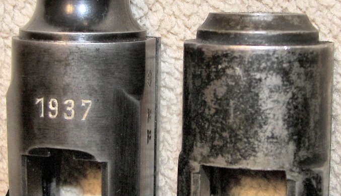

More detailing of the changes made by this prototype...
The top view of the receiver ring (conversion on the right - like it is no obvious huh? ) Also notice the difference in the thickness of the barrel flange on the 9mm barrel and the barrel stub in the conversion receiver.

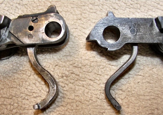

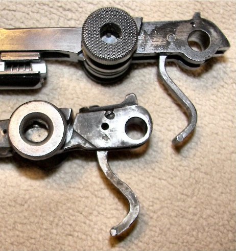

Changes to to rear and forward toggle linkage. Note the movement of the toggle coupling link and the difference in physical size of the coupling links. The conversion coupling link is much thicker. I am not sure if this link is original or fabricated... but original would be my guess.

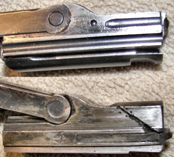

Breechblock left closeup. While difficult to see in this photo, the underside of the conversion toggle includes a spring loaded buffer of sorts, that I think contributes to the ability to operate this system as a blowback when combined with the difference in the toggle hinge pin locations, rather than locked breech toggle like the original design.
The right side of the breechblocks. Notice that the original block is round on the bottom and the conversion is flat... probably for proper feeding and clearance working with a .22 magazine.
Notice how the rear end of the rear toggle has been substantially ground down to allow opening of the toggle without moving the upper receiver. This accounts for a major reduction of resistance during the blowback operation.

Here are the first 8 images of this .22 conversion attempt from an unknown gunsmith. Take particular note of all the steel that has been removed by drilling and milling to lighten the toggle train for movement by a .22 caliber rimfire... It is assumed at this point that the addition of a properly chambered and headspaced barrel, and a standard .22 conversion magazine that this upper would function correctly... Someday I hope to find out. Comments and suggestions are welcome.

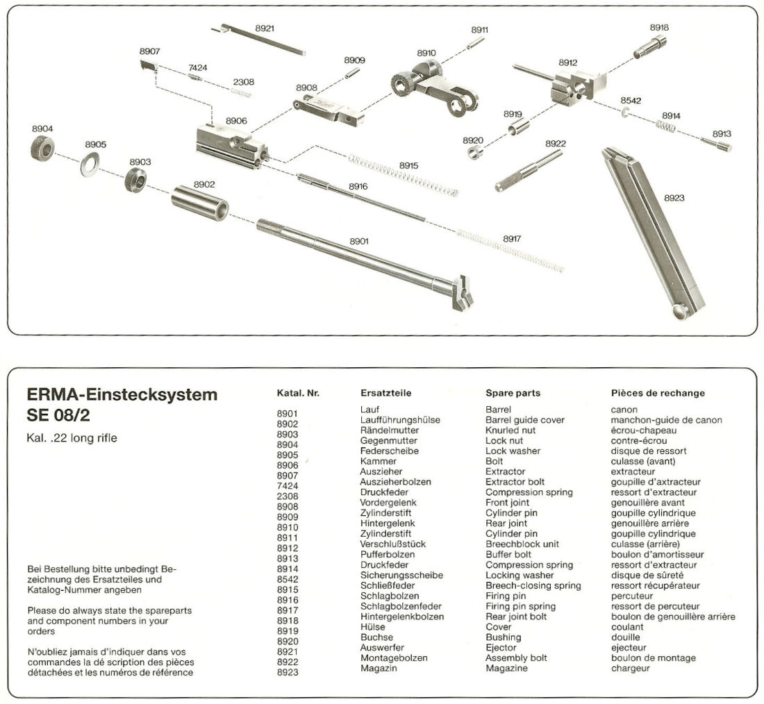

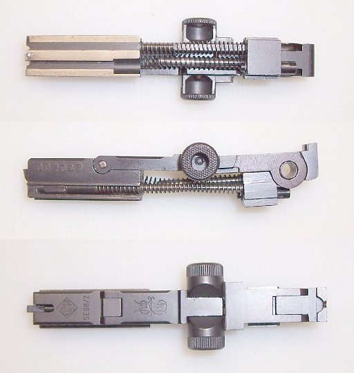

There are two springs in the Erma toggle; one for recoil, one for the firing pin. The Erma toggle assembly comes apart quite easily for replacing the springs; chasing them across the room can be invigorating...
Maybe Ed Tinker would be willing to try replacing his Erma 'recoil spring' with a P-38 mainspring...The Erma spring is called a 'breech-closing spring' in the Erma manual/parts breakdown...

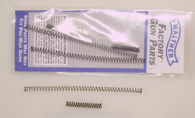

I pulled out my P-38/P-1 parts box and took some measurements -
Mainspring
- .038" wire dia
- .225" OD
- 1.516" free length
- 17 1/4 coils
Recoil springs [two slide springs]
- .026" wire dia
- .207" OD
- 5 1/8" free length
- many coils
I don't have an Erma toggle to measure the springs, but I have to say that I'm skeptical of using the P-38 mainspring...

Dave, I don't need any at this time; I'm just trying to figure out what Patrick Villiers meant about replacing the Erma SE 08/2 kit springs with a 'P38 mainspring'. I don't see how that would work. A chopped-down P-38 recoil spring looks more likely. My experience (in '.22 Long barrel' thread further down in the forum) was that the springs were too strong. Both the Erma firing pin spring and the recoil spring absorb .22 recoil until the firing pin cocks, then it's just the recoil spring. It wasn't recoiling far enough to eject or chamber a round.
The entire cannon assembly has to recoil the ~1/4" in order to line up the magazine with the barrel/chamber. Otherwise the cartridge won't be picked up by the breechblock. The breechblock has to recoil all the way or the spent case won't hit the Erma ejector.
The Erma toggle assembly I tested wasn't going back any further than ~3/4" and with one frame it was binding.
I couldn't do any physical changes because it wasn't my Erma kit and I wasn't about to machine my Luger.
Weaker springs sound like the next step in getting that particular kit to work, but Patrick's comments are pretty discouraging vis-a-vis Erma .22 kits collectively.
