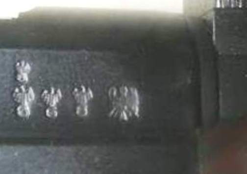

1920's carbine in 9 mm...
Tinker should like this one...what will all the Simson birdies on it...
http://www.gunbroker.com/Auction/Vie...?Item=90162851
