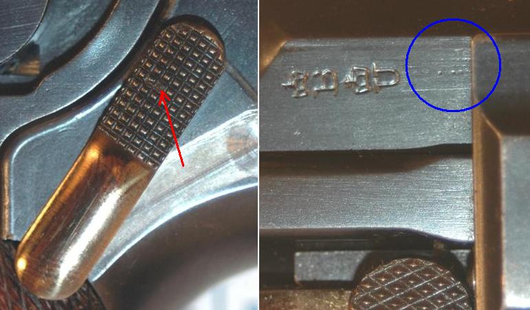

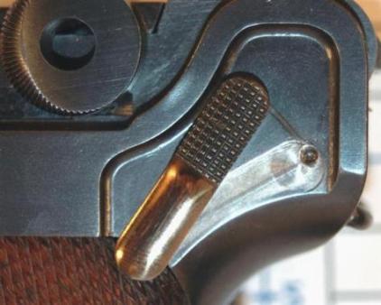

Here are two more "polished" thumb safety area photos to compare...

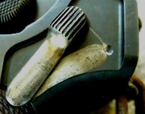

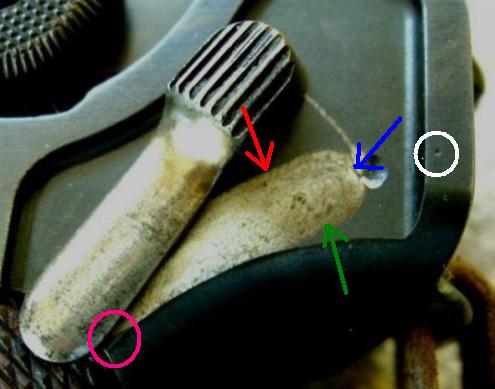

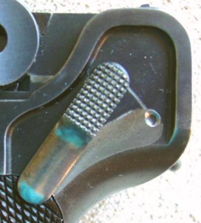

I looked at the two pictures that Pete posted aboved. Here is my summary of observation and understanding on the polished thumb safety area.... please correct me if I am wrong:
I have higher level of confidence on the first one:
(1) The edge pointed by the red arrow should be perfectly straight (and it is);
(2) The curve pointed by the blue arrow should be perfectly round (and it is);
(3) The edge pointed by the green arrow should be straight but very slightly blured than the top edge pointed by the red arrow (and it is);
(4) The pink encircled area has a very small unpolished area (and it is);
(5) The depth of polished area is very very shallow (and it is);
(6) No gun blue, nor too marks in the polished area... this area is usually ignored for oiling.... expect patina, light rust or even pits (and it is);
I have a question regarding the "ding" encircled by the white circle -- it has gun blue inside.... if it's a ding (e.g. hit by a nail), I did not see the rough edge around it, where did the metal go? It does not look like a pit either, because it's single and very shallow. I did not any reason to test steel hardness on this area either.
So, what is it? Could it be parts hiting each other in the bluing process and left this tiny mark?
Unread 01-13-2008, 02:52 PM   #28
Sorry, forgot the marked picture. Here it is:

Unread 01-13-2008, 02:54 PM   #29
Alvin,
That is probably a hardness test spot...in the area you circled in "white".
Similar to our Rockwell hardness test. Probably done before final sanding and bluing.
You see those on various guns from time to time...probably evidence of a random test sampling of metallurgy of parts on the factory floor as part of their QA/QC process.
The Swiss liked doing such a lot. I have two M1929 Bern Lugers that must have 6-8 of them, apiece, on each gun and another M1929 without any of the "dots". I would WAG that DWM and Mauser and maybe others tested parts from time to time as well...
The edge of the area you show in "red" will usually show a slight cut of the milling pass. You can feel this cut edge with your finger. The frame is blued and then the polished area is milled/cut to create the polished area.
Sometimes you can see/feel that "cut" along the green and blue areas as well.
That shows in the 2nd. photo I posted.
I think it just depends on how deep they set up for the milling cut/pass and if the gun was held truly square in the holding jig or not.

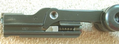

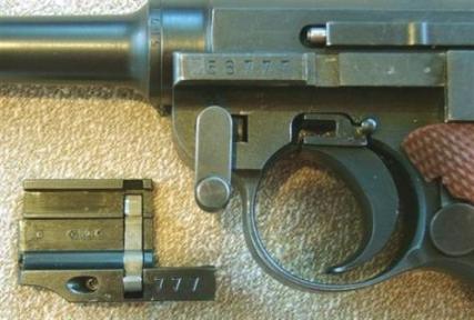

One more photo for you to look at :

This one looks very questionable. Let's see making sense or not. Again, please correct me if I am wrong:
(1) It has been shot a lot. The area pointed by the red arrow was distorted. I bet this area is like the area behind bolt stop on C96.... with this area losing its shape, then it's supposed to be a well used (if not abused) gun. However, the percentage of gun blue and straw seems unusualy high on this one;
(2) The scratch (blue) created by the thumb safety level is not silverish metal color. Metal against metal, I expect silverish scratch;
(3) The polished area.... I don't know..... looks too deep to me, especially in the green circle;
(4) The straw on safety level .... looks refinished to me.
