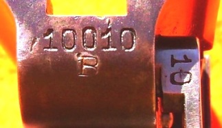

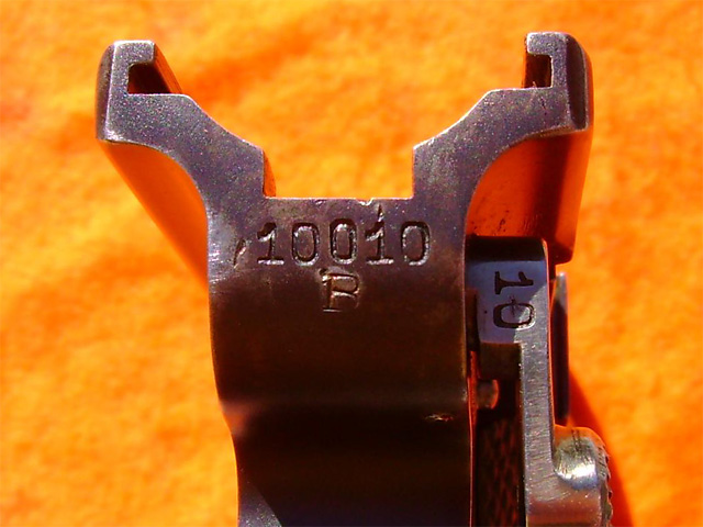

Ron,
Here in an image showing the serial number.
The individual numbers of serial numbers (and characters) are not allows stamped perfectly right and the B-suffix does not appear suspicious to me. The so called 'halo' on this pistol does not follow the characteristics of natural halos I have observed on other Lugers.
One detail which I am not 100% sure is whether the B-suffix was stamped after the serial number or below the serial number - I guess under the serial number. Maybe you can refresh my mind regarding this method. I know that the the presentation carbines in the 9100 serial range have the number stamped as 9102C along the forearm tang.
Albert

The "B" is in the appropriate position under the serial number. I agree that the "halo" is not the result of stamping but may be from wear or contact with something that removed the blue. I still am not totally comfortable with the slant of the "B" but am willing to accept it at face value. It appears to be a legitimate rare Luger and the condition attests to the hardships of ranch life. I am perplexed by the presence of the "B" suffix since this is obviously one of the elusive 7" Commercial pushbutton stock Lugers, but there is an awful lot about early Lugers that I freely admit I do not know. Maybe if I live another 50 years I will be a little better informed .

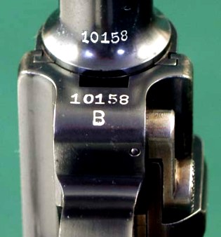

One Shattuck has for sale :

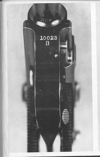

BTW...is the seemingly larger size of the "10" on the bottom edge of the TD lever "normal" ?
I noticed on # 10023B the "23" is pretty small on the TD lever. Then on # 10158B, there are no numbers on the TD lever.

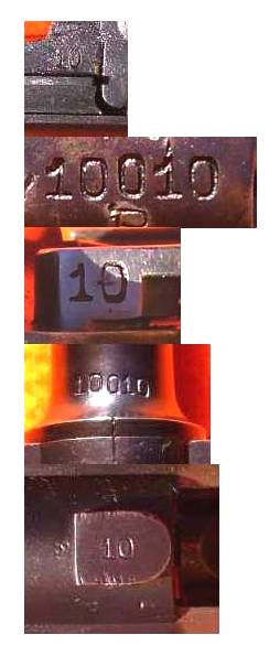

I would have to agree with Albert that the B is original to the gun, or at least was applied very early in the life of the gun. If you look closely you will see some damage at the top left, this has occurred after the B was applied.
The serial numbers on the take down lever were applied with different stamps, if you look at the base of the 1 on the take down lever you see some flaring not present on the frame numbers. This is not necessarily a problem; the only way to check is to compare them to the stampings on the rest of the gun.
I have one concern however:

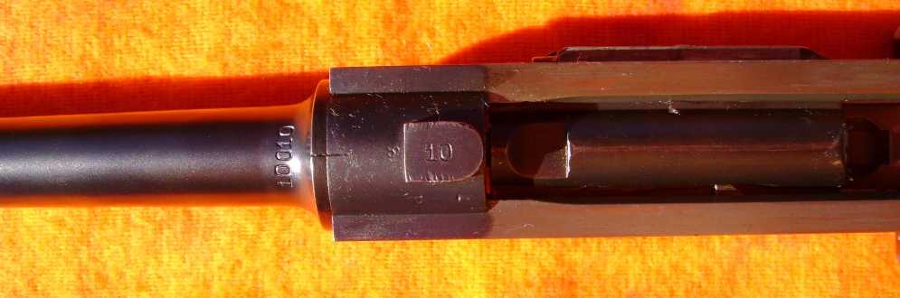

The zeros on the frame serial number are flat top and you would expect to see rounded ones, I would like to compare them to the serial numbers on the barrel. Could we get one more picture please of the barrel serial numbers?
I also have a question on safety levers, is this the normal style for such an early luger? This is mostly for my knowledge and not a criticism?
Interesting gun!
Vern

Default 10010B
Hi Vern, here is the pic you ask.
Regards
Adrian

I think the serial numbers are fine, the one on the take down lever was struck at an angle and then perhaps struck again, this caused the flaring and what looks to us as an enlarged font.
