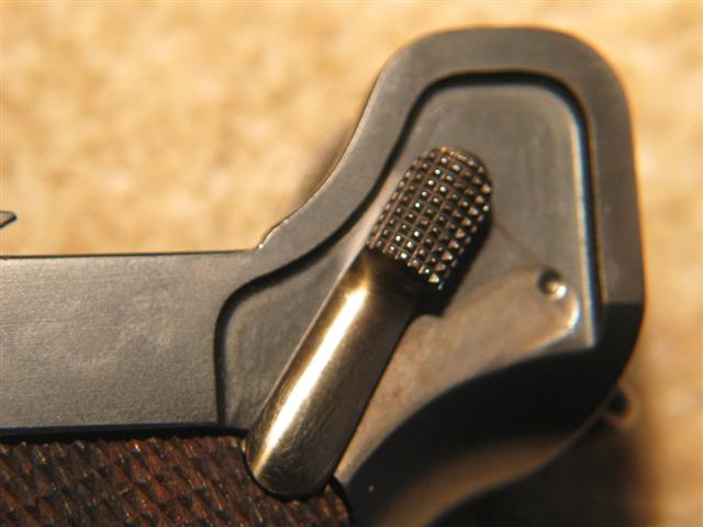

Thanks Pete. I assume you are talking about the area immediately below the lock. Specifically, are you refering to the blued frame part or the straw part, or both.

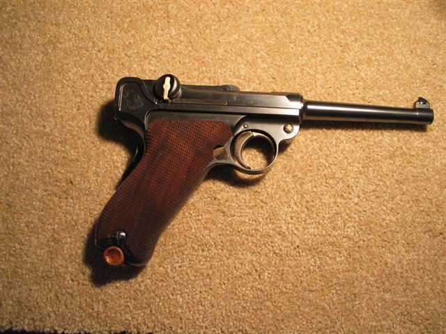

EW,
Lets be clear about the "not all correct" aspect of this gun
This is a model 1900 U.S. Teat Eagle, found in the Bannerman auction range. As long as the numbers are all matching (and perhaps even if they weren't) it is "correct". The reblue simply makes it a reblue.
As a Test Eagle it is worth a not-inconsiderable amount, even reblued. I strongly recommend that you do not take this gun out and shoot it. The chance of breaking a numbered part is not one to be taken lightly; the flat recoil spring is known to be delicate after 107 years, and it is nearly impossible to find a replacement if broken. Such a circumstance will reduce its value considerably.

EW,
It is the faint "white lines" around how the toggle lock indent piece is machined and pressed into and then soldered into the right frame rail.
It is silver-soldered in place and on most (BUT not all...) M1900's, the area of the solder lines does not take bluing well.
If I do not see the faint white lines, I do not immediately conclude the gun is refinished...just that one area may not be right and other "tell" areas would need a closer look as well.

Pete, One correction. The frame part of the toggle lock is NOT sodered in place, it fits into a tight dove tail. I have installed several of these (have this part available new @$40) and have even had a dove tail cut into the frame of a M1906, for a customer's sprecial project. TH

Here is a scan of the part in question.
It may be a bit difficult to make out, but this is not the usual angled dovetail. The cuts are straight, almost making a tab-in-slot sort of insertion.
I have to wonder if the part is not an extreme press-fit, and the effect we see on the guns is simply the same kind of compression effect as halo from stamping? If it was silver solder I wouldn't expect to see any evidence beyond the actual part juncture.
Maybe Lugerdoc can answer this, when the toggle lock is removed, does it simply press out, or does it require heat to melt silver solder?

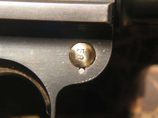

Pete, this is the toggle lock of my AE Test. Not sure what I am learning from this as it pertains to a re-blue gun. \

Vern,
From the variety of photos I 'borrowed' off the Simpsons LTD site, I was trying to show the variation in the extent of the "lines" one can see on factory original rust-blued Lugers.
In some extreme cases, both "lines" are very fuzzy and wide in parts. In others the shape of the "lines" become very narrow and sharp.
Ron Wood has even mentioned in a past posting seeing almost no "lines" on guns in his collection that are factory-finish as well.
I would still support the "hunch" that some silver soldering occurs to hold that piece in place on the frame rail and that a varying-degree of sanding occurred at DWM before the bluing treatment.
As some of the more high end, commercial guns such as carbines and presentation pieces may have gotten more time in the pre-blue prep. stages of getting a gun ready for bluing, those "lines" are less pronounced.
I think the degree of width and fuzziness one sees from gun-to-gun at these "lines" makes sense if a varying degree of residual silver solder along the brazed joints was left during sanding/polishing prep. and that the silver solder left did not take the blueing process as the surrounding areas of metal.
On refinished pieces, I see one or both "lines" totally sanded away to the point where no silver solder remains and the more modern-day re-blue covers it more completely.
The "refinished" Borchardt in the photo I posted above is a pretty obvious attempt by someone to "add back" the lines...probably with a few strokes of a very narrow and fine jeweler's metal file.
If one follows the idea that this part is only pressed into place on the frame rail (i.e. not soldered into place...), how would one explain the wide variation in shape, width, and fuzziness one sees on these two "lines" from gun to gun with factory original finishes ?
