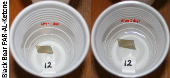

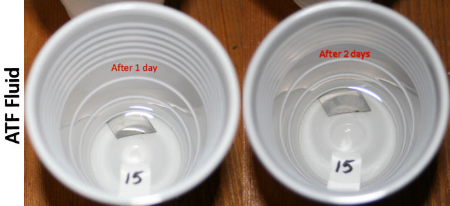

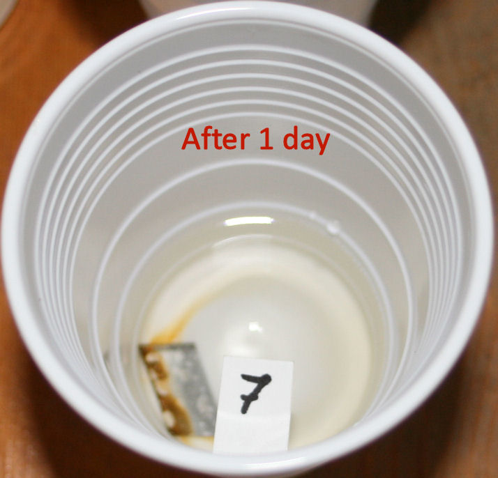

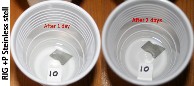

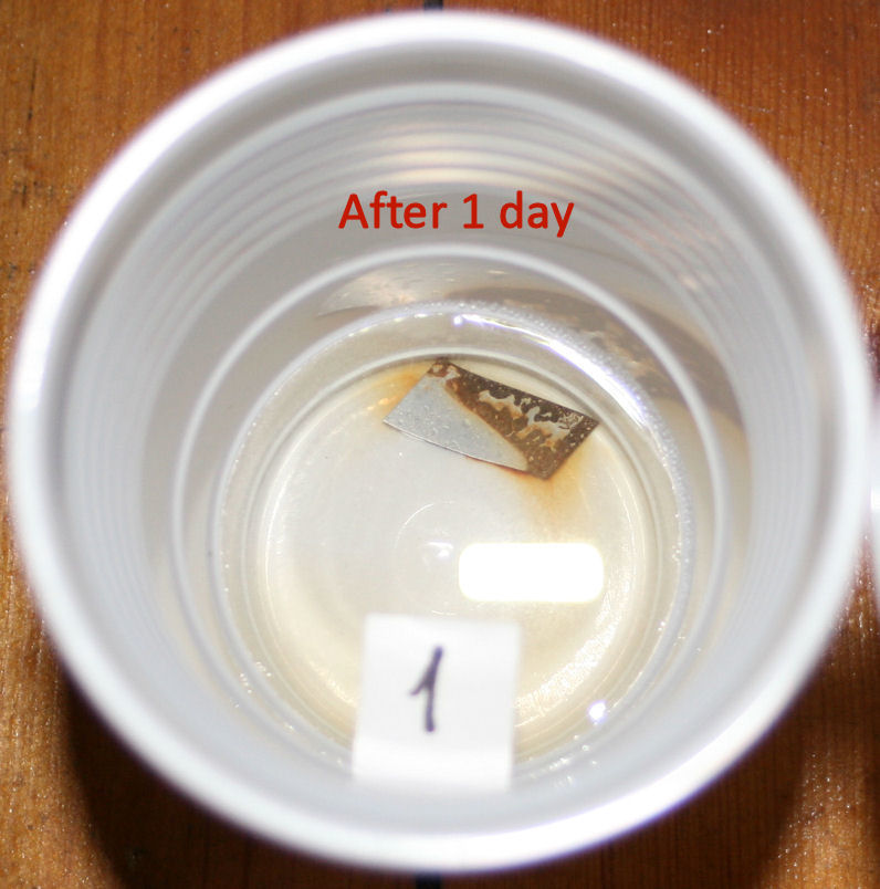

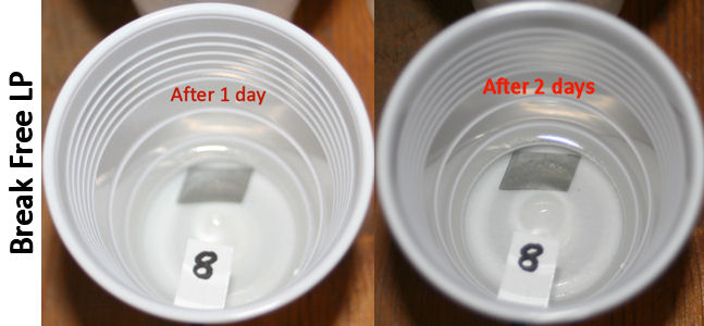

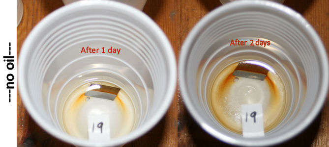

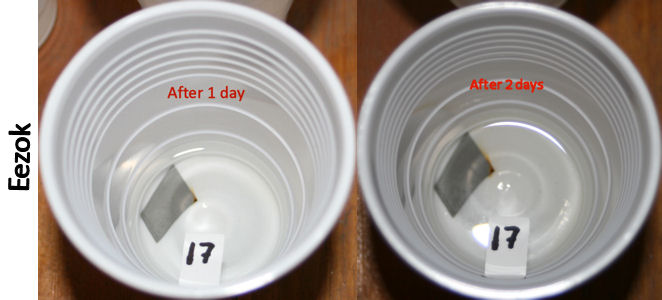

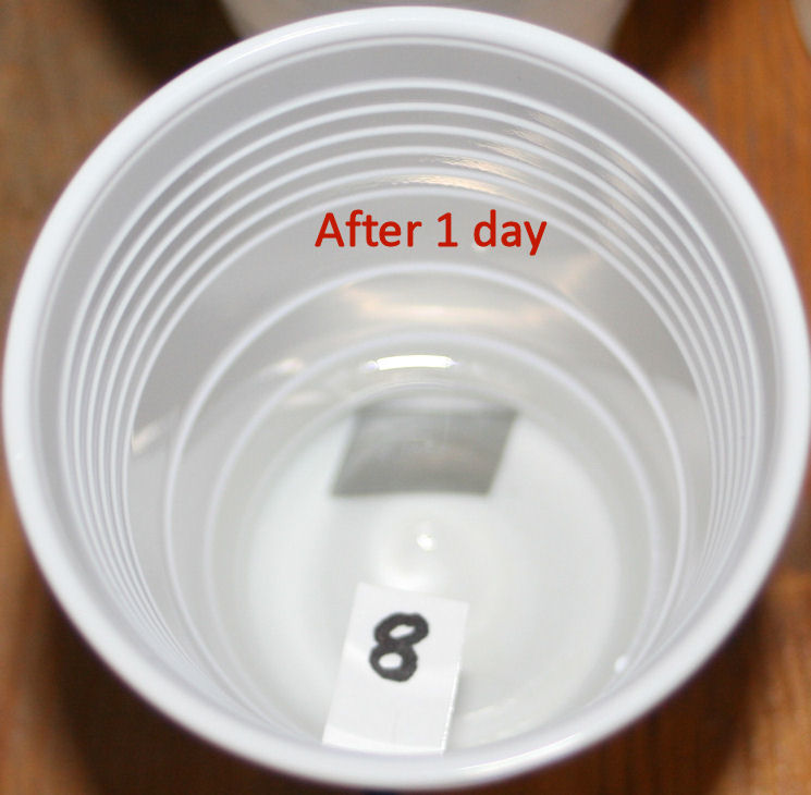

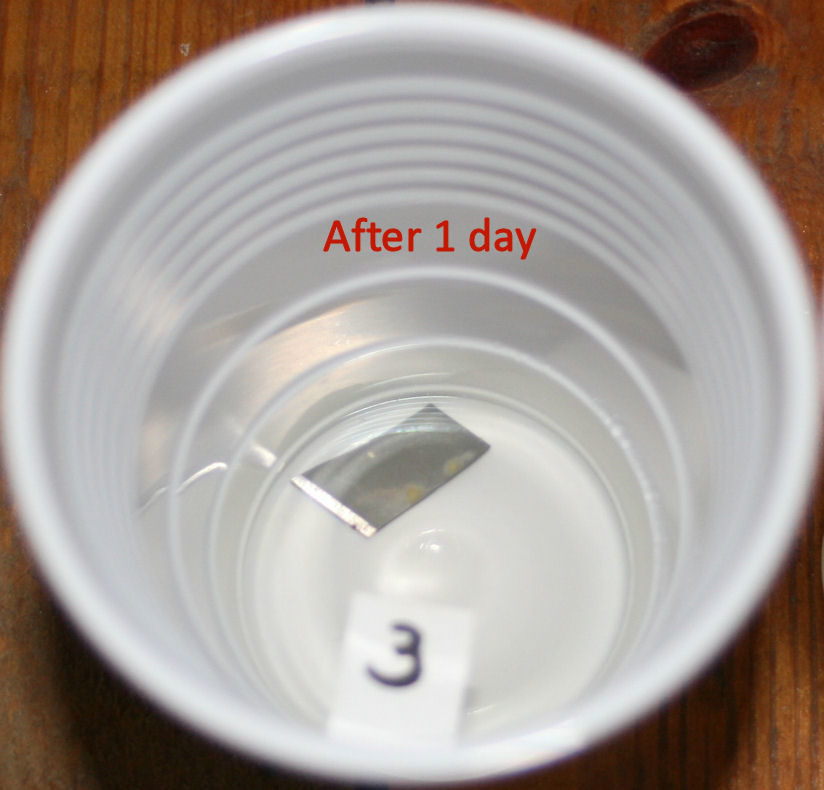

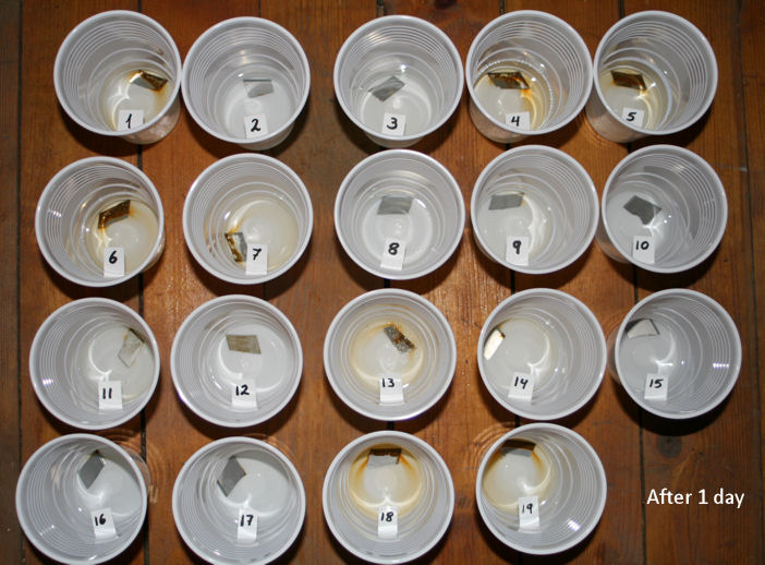

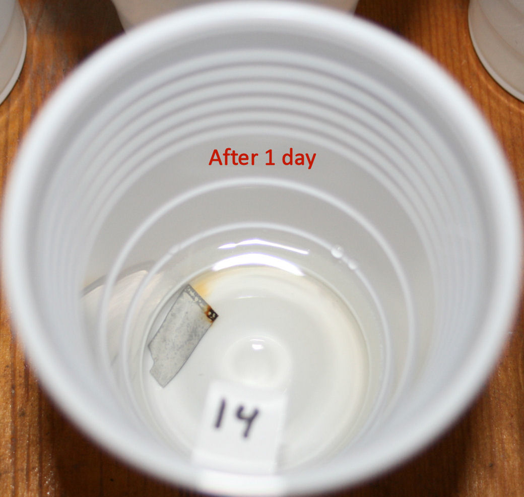

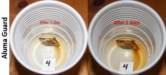

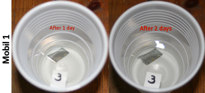

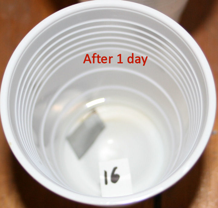

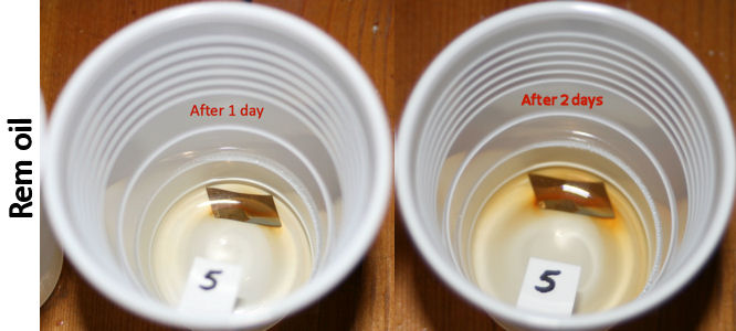

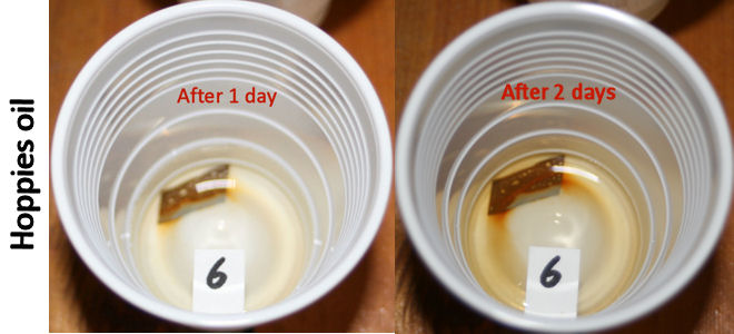

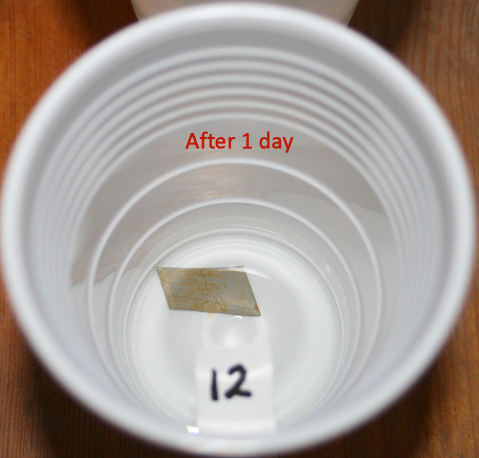

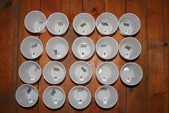

Here is the day 1 picture, taken yesterday.
Was a little to ambitious about the friction test , so will drop that idea for now.. However, I have saved the cleaning patches for a second test later, to see if the results are consistent. Perhaps a metal bar placed outdoors, with the areas separated with tape ..or something like that
Btw. Kroil and some other oils (the types that where taken at the airport) will join the test later on, I have saved some of the salt water solution for that. They will be 1, 2 or 3 weeks delayed but hopefully under similar conditions.
1. Aeroshell 2F
2. WD-40
3. Mobil 1
4. Aluma Guard
5. Rem oil
6. Hoppies oil
7. Militec 1
8. Break Free LP
9. Brownells Steinless Slick
10. RIG +P Steinless stell
11. Lihium grease
12. Black Bear PAR-AL-Ketone
(thanks Chris!)
13. Dutch oil
14. Swiss grease
(thanks G. van. Vlimmeren!)
15. ATF Fluid
16. FP10
(thanks 76Vette!)
17. Eezok
18. Glen Boore
19. ---no oil---
Unread 03-08-2007, 03:48 PM   #30
Steinar
Steinar's Avatar
Join Date: May 2004
Posts: 1,538
Thanks: 18
Thanked 36 Times in 21 Posts

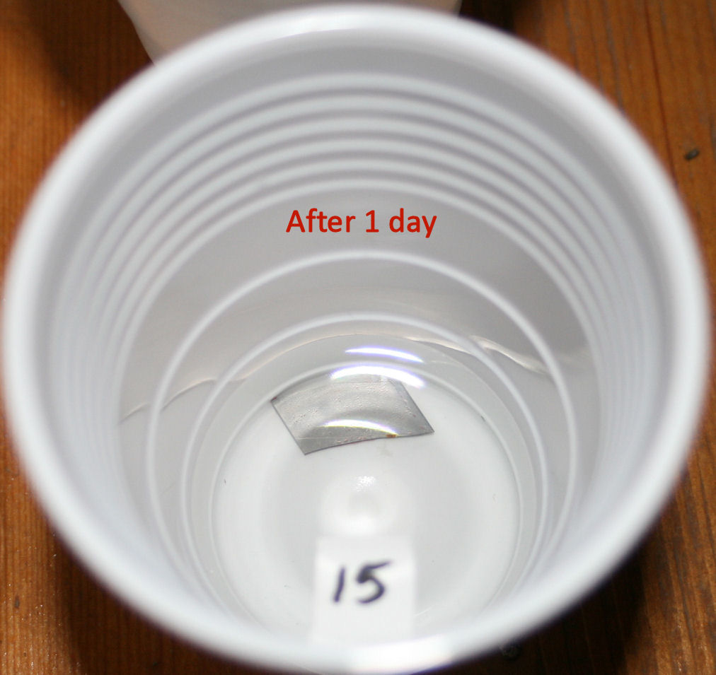

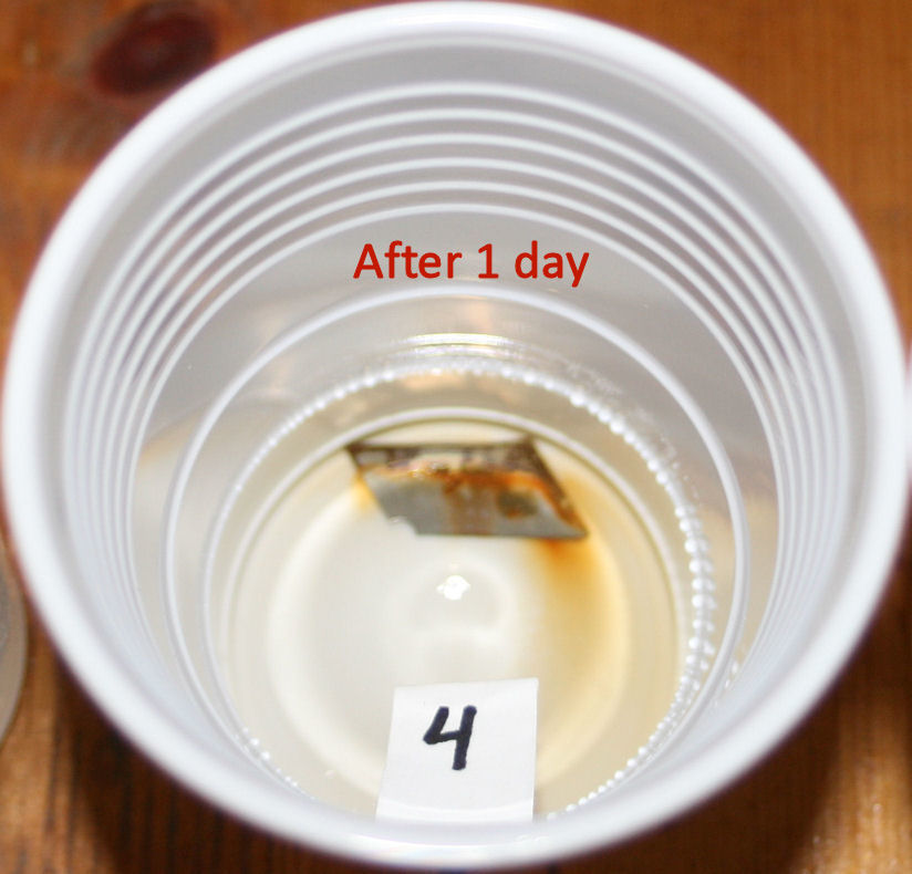

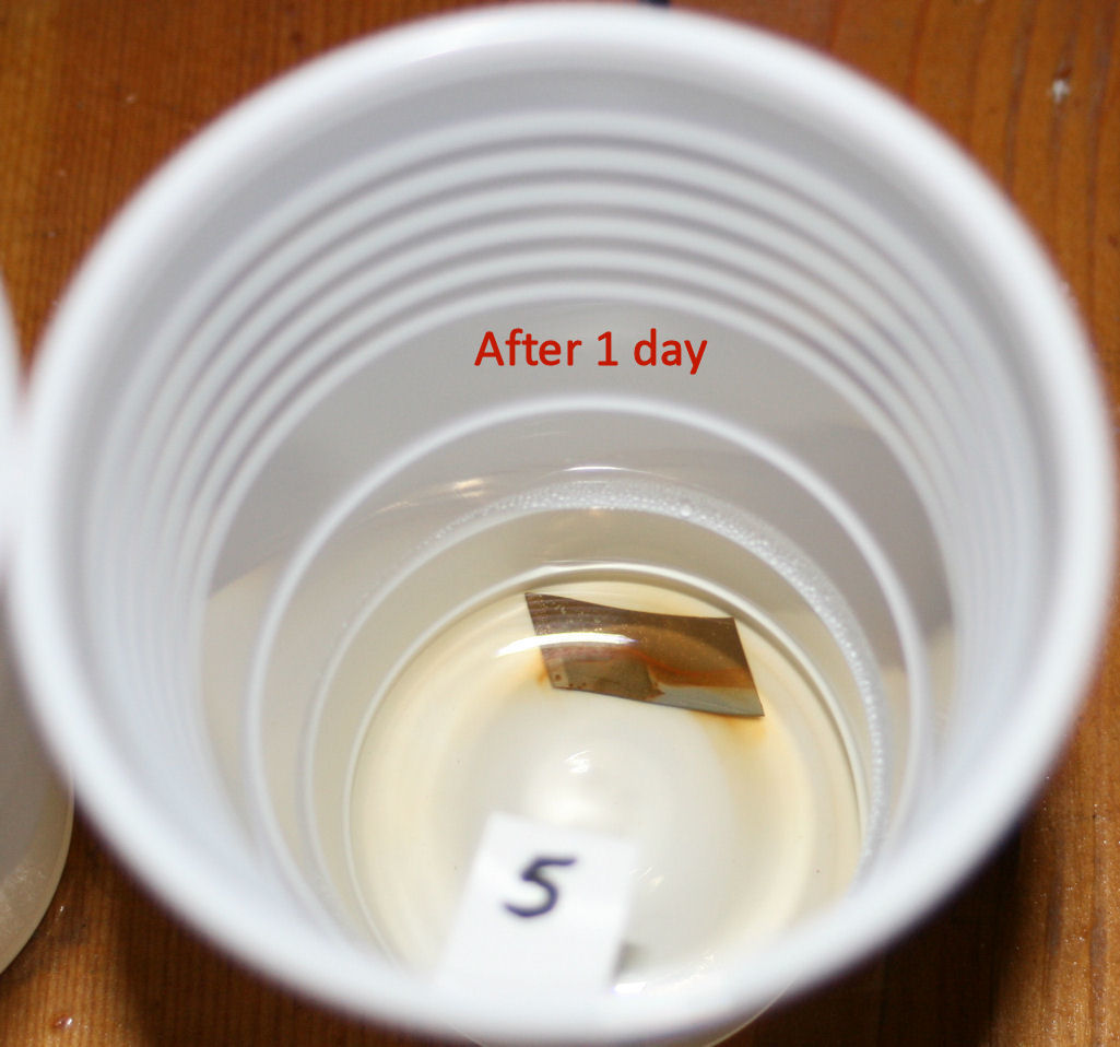

Here we go

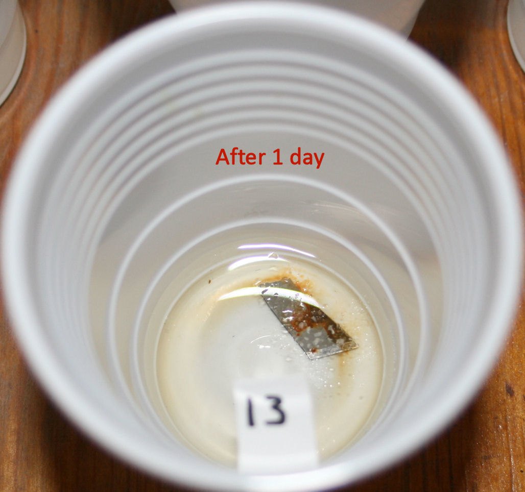

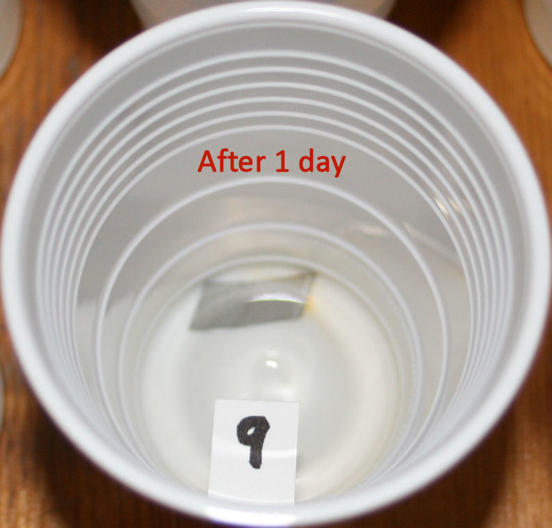

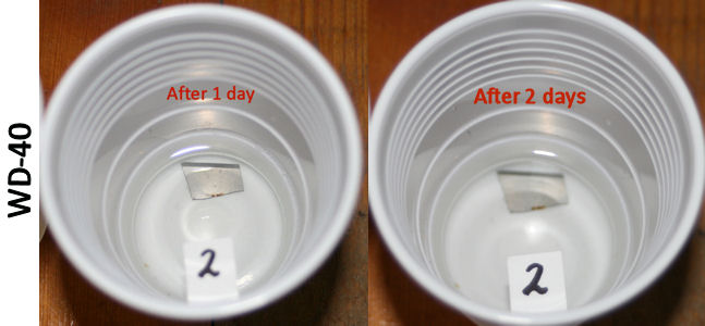

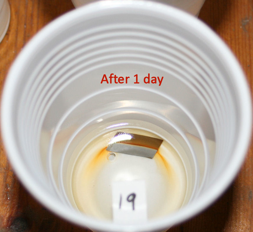

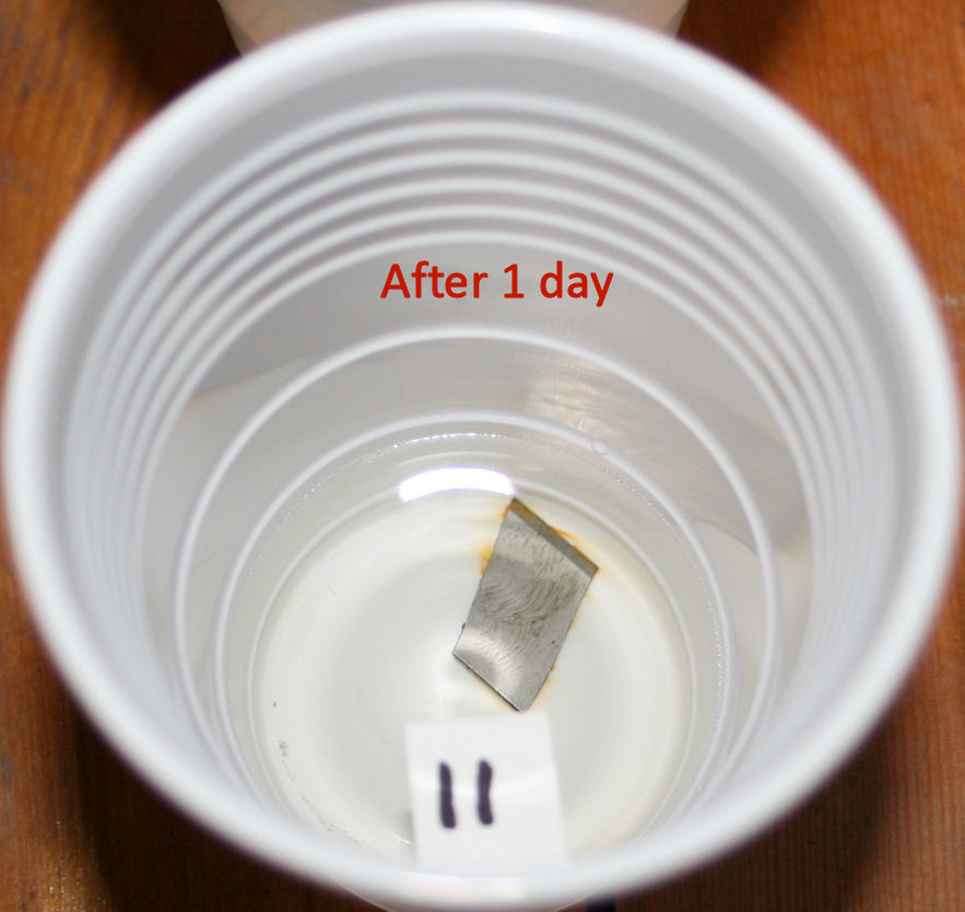

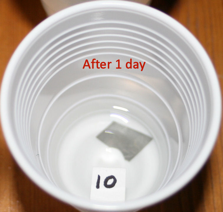

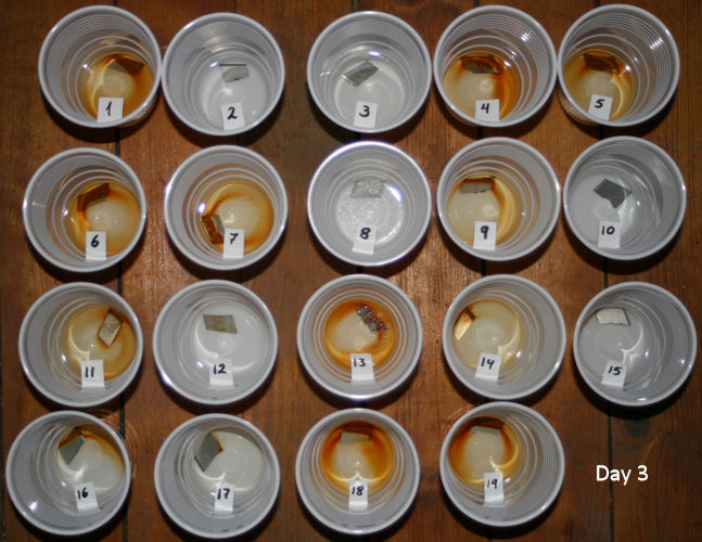

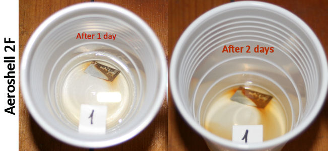

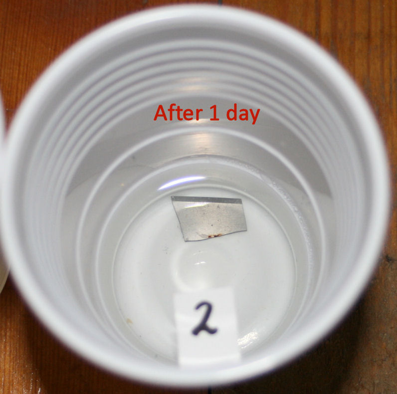

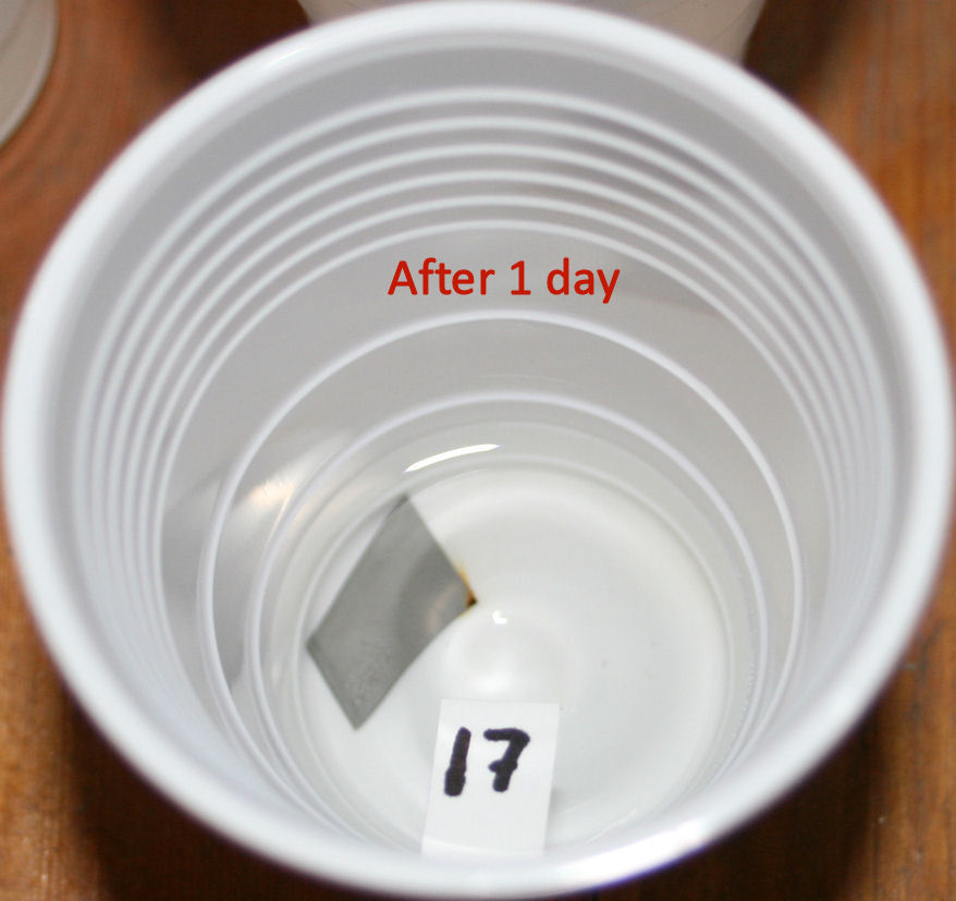

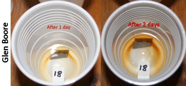

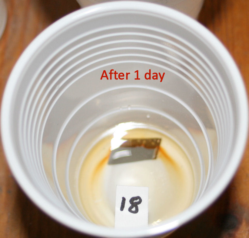

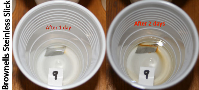

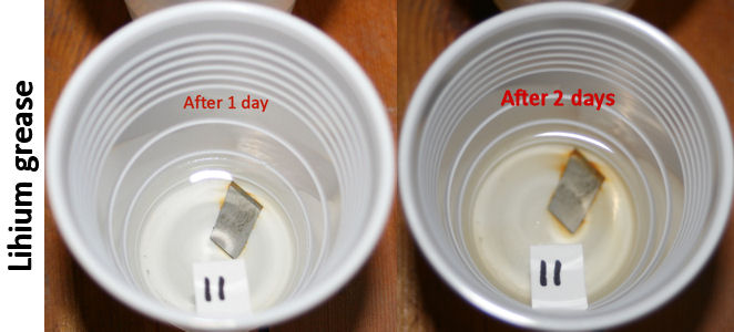

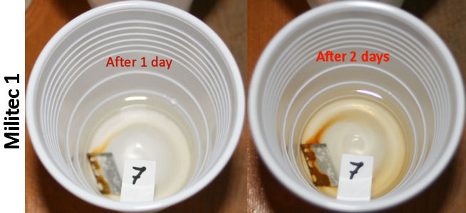

This is the results after one day (24 hours). Think I can say for sure that this calls for a second test later on, glad I kept those patches Used one tee spoon of salt in two liters (just under a gallon), but this was probably way too much. Tried to add the oil equally over the metal pieces, still there might be spots with less oil.
For closer pictures, clink on the link under the product name;
1. Aeroshell 2F
http://forum.lugerforum.com/lfupload/1_1.jpg
2. WD-40
http://forum.lugerforum.com/lfupload/2_1.jpg
3. Mobil 1
http://forum.lugerforum.com/lfupload/3_1.jpg
4. Aluma Guard
http://forum.lugerforum.com/lfupload/4_1.jpg
5. Rem oil
http://forum.lugerforum.com/lfupload/5_1.jpg
6. Hoppies oil
http://forum.lugerforum.com/lfupload/6_1.jpg
7. Militec 1
http://forum.lugerforum.com/lfupload/7_1.jpg
8. Break Free LP
http://forum.lugerforum.com/lfupload/8_1.jpg
9. Brownells Stainless Slick
http://forum.lugerforum.com/lfupload/9_1.jpg
http://forum.lugerforum.com/lfupload/10_1.jpg
11. Lihium grease
http://forum.lugerforum.com/lfupload/11_1.jpg
http://forum.lugerforum.com/lfupload/12_1.jpg
13. Dutch oil
http://forum.lugerforum.com/lfupload/13_1.jpg
14. Swiss grease
http://forum.lugerforum.com/lfupload/14_1.jpg
15. ATF Fluid
http://forum.lugerforum.com/lfupload/15_1.jpg

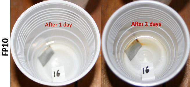

16. FP10
http://forum.lugerforum.com/lfupload/16_1.jpg
17. Eezok
http://forum.lugerforum.com/lfupload/17_1.jpg
18. Glen Boore
http://forum.lugerforum.com/lfupload/18_1.jpg
19. ---no oil---
http://forum.lugerforum.com/lfupload/19_1.jpg
Unread 03-08-2007, 03:54 PM   #31
davidkachel
Join Date: Nov 2006
Posts: 784
Thanked 3 Times in 3 Posts
Hoppe's looks particularly surprising and disappointing.
Unread 03-08-2007, 04:37 PM   #32
Steinar
Steinar's Avatar
Join Date: May 2004
Posts: 1,538
Thanks: 18
Almost seem as if some of the oils solves out in water and therefore have no/little effect..? I'm thinking metal pipe on the second try, placed outdoors in snow/rain instead.
..also find it strange that the one without oil is 50% free of rust (no idea why.. it was well cleaned all over)
Unread 03-08-2007, 04:46 PM   #33
davidkachel
Join Date: Nov 2006
Posts: 784
Actually I think I can explain that one. Some years ago I did considerable photographic research and published a number of articles concerning my results.
Not to bore you with the details; metals and salts of metals begin reactions at focal points, usually points of microscopic defect. As reactions occur in other places, electrons tend to get "handed off" from new areas of reaction to areas where reactions are already occuring.
This feeds the old areas of reaction from potential new areas and therefore new areas are created more slowly than they might be otherwise.
Think of it as having to break a threshold and once that threshold is broken, reaction is going to speed there and slow elsewhere.
You may find that the depth of rust is a bit greater on the metal without oil than on samples with oil and the same apparent amount of surface rust.
Unread 03-08-2007, 06:42 PM   #34
shadow
shadow's Avatar
Join Date: Jan 2006
Location: Down The Shore
Posts: 245
Thanked 6 Times in 4 Posts
Is the brown on #12 rust or the "Bear fat" smeared on. I notice it still has the brownish color as the initial photo.
Have you tried the tool yet?

Yes, with the oil I used a patch, but with the grease I used my finger tips to smear it out, to have it as equal over the piece as possible.. (used paintwork solvent to clean finger tips between each sample). On a larger surface such as on a pipe, I think a patch will be best. As to the #12, I think the colour is NOT rust, but traces of the grease itself.. I'm at work now, have a more detailed startup picture at home. So I will check it out

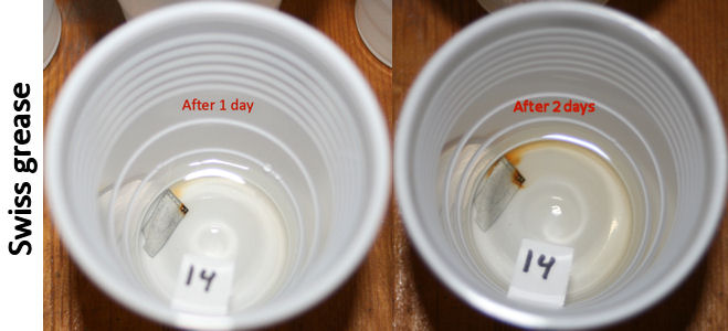

Nice test. The old Swiss grease seems to work better than I expected. Dutch oil looks not too good
Unread 03-09-2007, 10:52 AM   #37

Chris; yes, it's the grease, not rust
This is the results after day two;
1. Aeroshell 2F
http://forum.lugerforum.com/lfupload/1_2.jpg
2. WD-40
http://forum.lugerforum.com/lfupload/2_2.jpg
3. Mobil 1
http://forum.lugerforum.com/lfupload/3_2.jpg
4. Aluma Guard
http://forum.lugerforum.com/lfupload/4_2.jpg
5. Rem oil
http://forum.lugerforum.com/lfupload/5_2.jpg
6. Hoppies oil
http://forum.lugerforum.com/lfupload/6_2.jpg
7. Militec 1
http://forum.lugerforum.com/lfupload/7_2.jpg
8. Break Free LP
http://forum.lugerforum.com/lfupload/8_2.jpg
http://forum.lugerforum.com/lfupload/9_2.jpg
http://forum.lugerforum.com/lfupload/10_2.jpg
11. Lihium grease
http://forum.lugerforum.com/lfupload/11_2.jpg
http://forum.lugerforum.com/lfupload/12_2.jpg
13. Dutch oil
http://forum.lugerforum.com/lfupload/13_2.jpg
14. Swiss grease
http://forum.lugerforum.com/lfupload/14_2.jpg
15. ATF Fluid
http://forum.lugerforum.com/lfupload/15_2.jpg
16. FP10
http://forum.lugerforum.com/lfupload/16_2.jpg
17. Eezok
http://forum.lugerforum.com/lfupload/17_2.jpg
18. Glen Boore
http://forum.lugerforum.com/lfupload/18_2.jpg
19. ---no oil---
http://forum.lugerforum.com/lfupload/19_2.jpg

Off to an interesting start I see!
David is correct about the micro fractures; when you broke the blade or when it was serrated tiny cracks formed; this sets up galvanic corrosion especially in an electrolyte like salt water.
I am always so disappointed in Rem Oil and Hoppeâ??s in adverse environmentsâ??sad
We know Break Free should do well, I am very interested in Mobil 1 and the ATF so far they look pretty good, it may take along time before you see something happen to some of your samples.
WD40 was designed to displace water but because of its solvent abilities is usually not recommend for old guns especially those that have brown rust finish, it will not harm guns in good condition, I have not tested ATF in rust removal but Mobil 1 is just as aggressive at dissolving rust as WD40 maybe more, it is detergent oil after all.
After you settle on your best preservatives, as a finial reality check, I would like to suggest getting the MSDS (material safety data sheet) on each and doing a comparison. It is next to impossible to handle your guns, let alone shoot them with out getting some of that preservative on your hands.
In other words, what good is that rust free gun if youâ??re dead or canâ??t remember where you put it?

Thanks for the informative information David and Vern. I support the tiny fracture theory created by cracking the blades. Perhaps also the tiny 'impact' of hitting the bottom of the cup can be enough to 'whip' off the oil in that area (like the #17)?
jupp.. here is todays picture;
