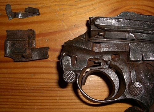

@ Ron, this is the datail of the Trigger. I think I also noticed that "hole" next to the Trigger that I didn't noticed in other pistol's pictures in the Forum gallery... is that something different from age/models?

Nick, the hole you are thinking of, is from the magazine safety. Often found on police Lugers.

There is no way to tell when the trigger may have been replaced. It may have been when the toggle train was replaced or a simple mix-up of parts when the gun was stripped for cleaning.
Don

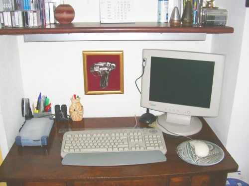

I'm done with that. Here we go the final result, just in front of my desktop...
Actually, to add the cherry on top of the cake, I would add next to the pistol a little "window" with his the historical data, that you kindly finded for me...
What about:
" 1929 Luger DWM
Manufactured and issued to the Prussian
Landj�¤gerei (rural constabulary).
Weapon 15 of the Landj�¤gerei of the
administrative district of Magedeburg"
Or any better idea on the model description???
As always, thanks in advance!

Nick
That looks entirely to neat to be a mans workspace. All jokes aside thats a great looking display. clint

Nick,
You're description is perfect. You may want to add that it probably was used by the German military, seriously "deactivated" and thrown into Lake _______ where you found it.

Good point Nick! THAT is a very good idea. Looks great. I never would have thought of that. Good job, well done! By the way, did you build the desk to fit that hole, or the other way around? nice fit. Thanks, Sean.....

@ Don, Ok than, that's will be... maybe also with the "tentative" S/N 3233u... Thank you very very much!
@Sean, Tks! belive me, I had to go around and dig it in some antiquary shop... it was as you see it and fit perfectly the spot!
