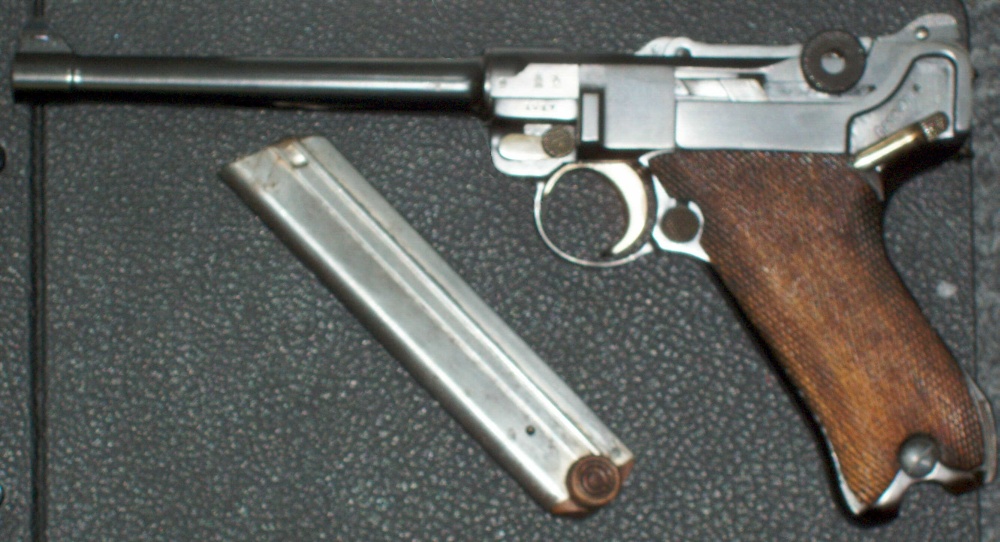

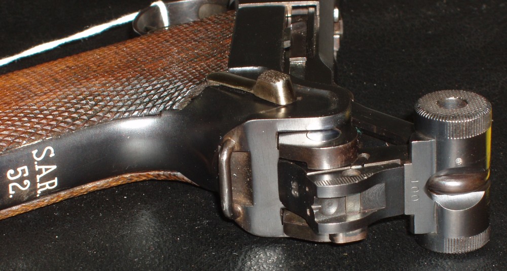

Mike let me photograph the item in his store.

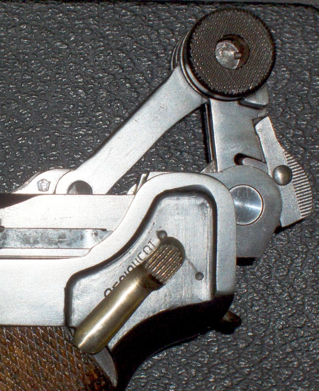

I wonder about the rear toggle pin flange. Is it correct? Could it be that the entire rear sight & toggle have been replaced?

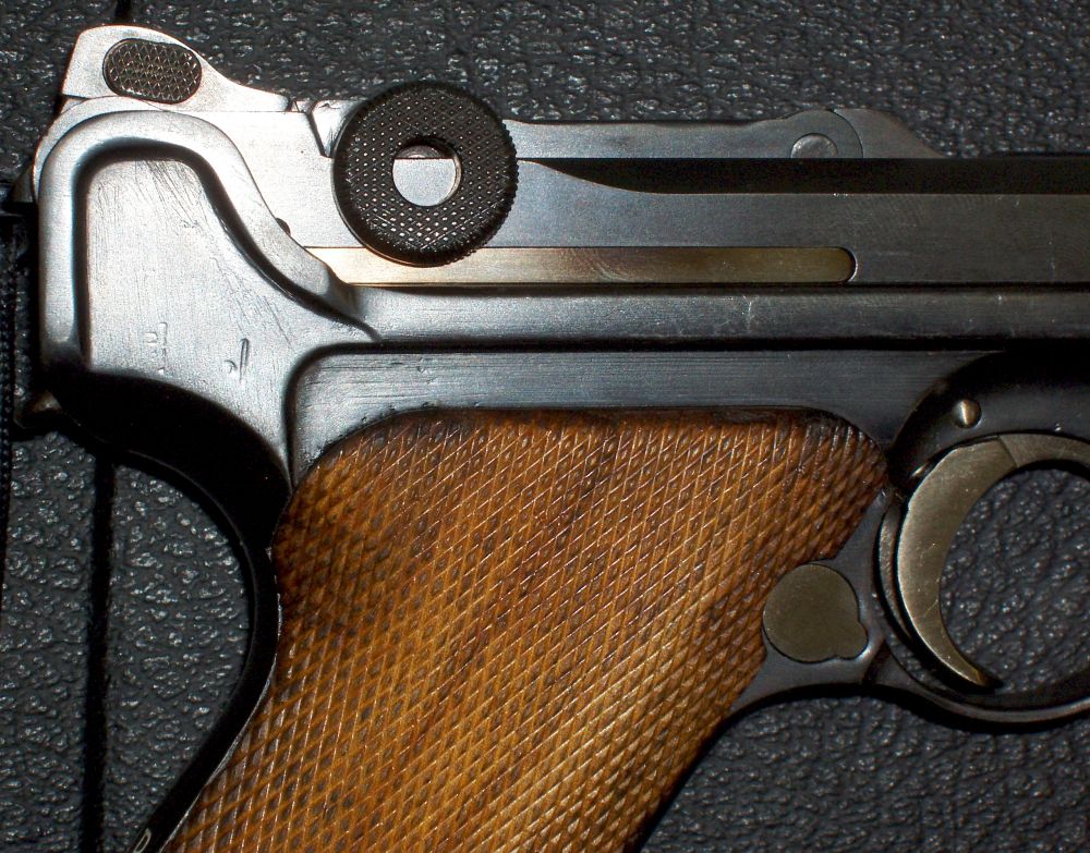

And yes, the left grip has â??the chipâ??
I truly appreciate any observations and comments on this, soon-to-be-mine, Navy shooter.

Russell,

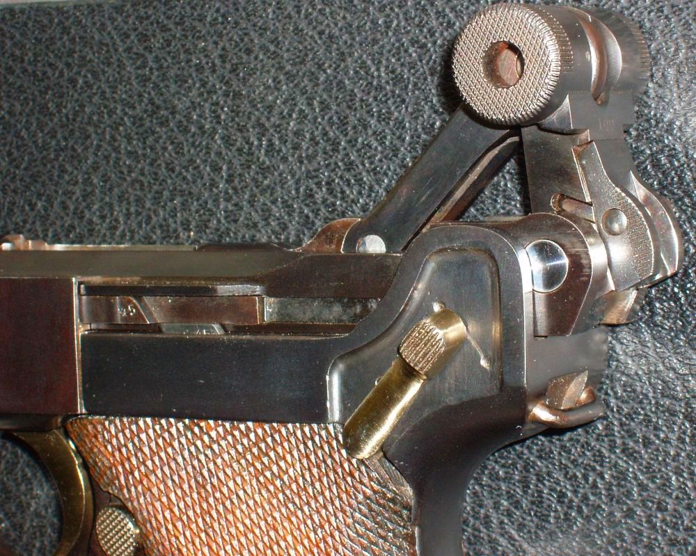

Since you ask--the inspector marks and proof on the right receiver and the small flange toggle pin reveal this gun's origin as an Army weapon.
The outline profile of the rear sight, the modern machining marks, and the slider's fit at the front where it recesses into the rear toggle reveal it as a modern reproduction.
The constant stroke widths and rounded ends of the grip-strap number are characteristic of pantograph rounting--if you remove the whitening you will probably find router-end swirling in the strokes.

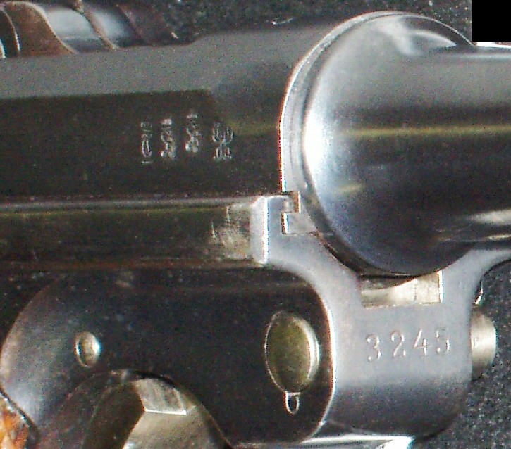

It would be instructive for us all if you could post closeup, detailed views of the left receiver, breechblock, left barrel, and under-barrel markings.
If you paid a decently moderate shooting gun price for this it should be great fun to shoot and show off at the range.

Russell

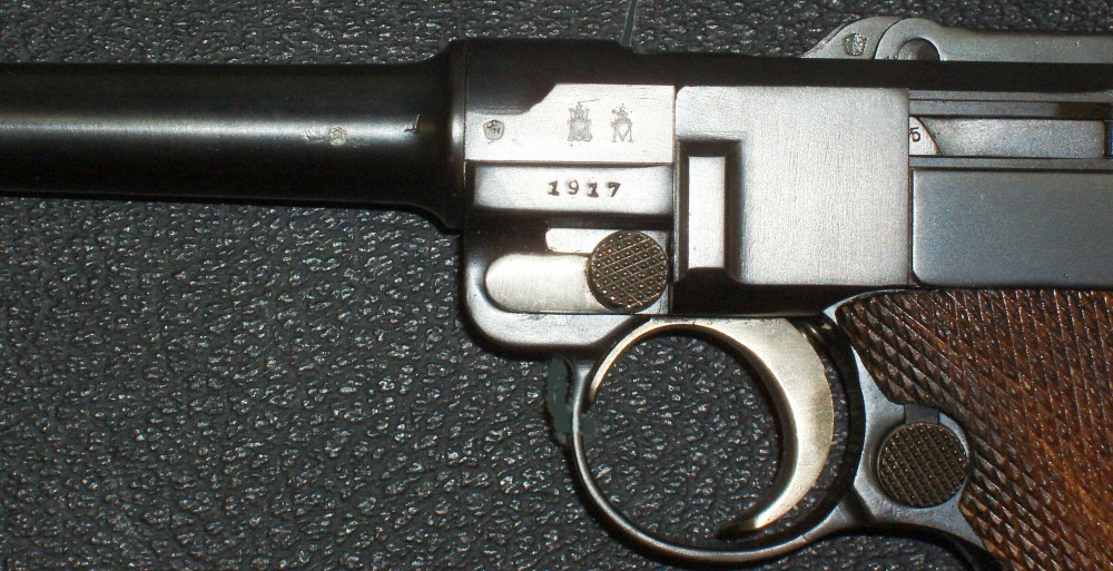

Maybe I missed something. It appears that photograph 2 shows the left receiver with a Navy crown and two C/Ms. Photograph 5 shows the standard three acceptance stamps and a test proof used by the Army on the right receiver. The frame serial number in photograph 5 is 3245 which is consistent with the parts serial numbers of 45 in the other photographs.
If I have not made a mistake, your photographs show a receiver with Navy proofs on the left side and Army proofs on the right side. Have never observed such an Army/Navy receiver.
Thanks for the interesting photographs.
Jan
Unread 08-27-2006, 09:41 AM   #26
I think Dwight has said it all, the rear sight looks like a reproduction, the grip strap marking is very questionable, the Navy acceptance stampings are just plain weird on an army gun. The 1917 stampings are probably fake and the barrel as well.
Russell, if your gun budget is such that you must put this pistol on layaway it would indicate a sacrifice on your part. This pistol does not warrant such a sacrifice.

What does "SAR" signify ?
BTW...toggle pin flange does not look right and the photo of the left-side proofs need better resolution, as the proofs look odd in the photo provided.
