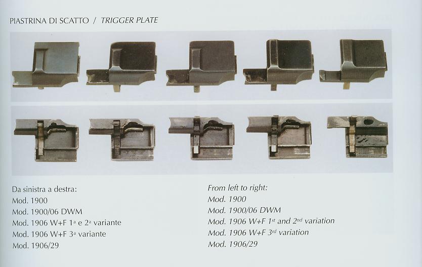

Here is a photo of all the Swiss sideplates used.
Take a look at the last two on the far right side of this photo...either a '24 Bern late sideplate or a M1929 Bern sideplate...photo is from Bobb'a 1st. book on Swiss lugers.

Pete, is it your feeling this sideplate is from the Swiss, that this was in Switzerland? With the germany stamp, I'd think a english speaking country?

I'm not Pete, but my guess is that this gun was never in Switzerland, that at some point it needed a sideplate and it was forced number matched by someone who had no clue about different sideplate styles.
