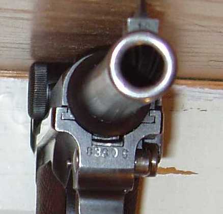

The serial # at the front of the frame is not in any of the pics I took yet. It is partially still white. The '3' has a round top as on the bottom of the barrel but unlike the receiver # flat-top digit. If '8' was added later would it be the leading digit, Dwight?

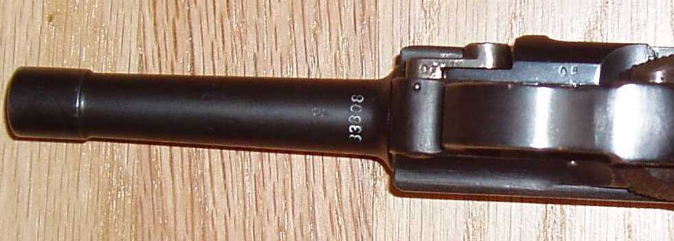

Here is the frame front serial # as Dwight suggested as well as the bottom of the barrel. A little late, I admit. Looks like he and Ron are correct.

Thanks for the pics. I'm curious to know what the stamp is over the serial number on the barrel, and whether or not the barrel has a witness mark?

The small stamp on the barrel looks like a normal commercial crown/N proof, a bit poorly struck. You also see that the original commercial style numbering is still present on the takedown lever.
It wouldn't surprise me if the barrel is original to the gun. It has the overall appearance of a normal commercial gun that had a 1920 property mark and military style numbering added.
The question is whether the renumbering was done by DWM or by some police/reichswehr armorer. The fact that it's numbered in the 80,000 range is interesting.

I suspected that about the barrel proof, just wanted to confirm as the barrel is 9mm. I'm sure that Police use accounts for a number of this gun's characteristics, note the long (unrelieved) sear bar, unexpected on a gun this late.
This part of the serial number range has quite a few 1920 marked chambers (some of them may be dates), 9mm, Police guns, at least one with an SPC mark.
