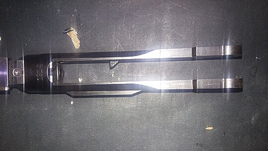

Ask and ye shall receive. Two shots of the M. One with and one without oil. The third picture is pretty much done. I still have to stain the grips. Sorry it's upside down. I will also say that the serial number didn't come through as clearly as you can see it with the eye. But I was shooting the M anyway. The number is 7237.

Yes. I have also noticed some new wear on the upper, just in front of the trigger bar and the plunger you spoke of. It is from the lever (whatever you call it) that is activated by the trigger and in turn depresses the trigger bar that allows it to fire. It seems that when the upper moves backward, the lever is in contact with it.
day late is offline   Reply With Quote

Here is a picture of the wear I spoke of.
Very common and nothing to be concerned about.
