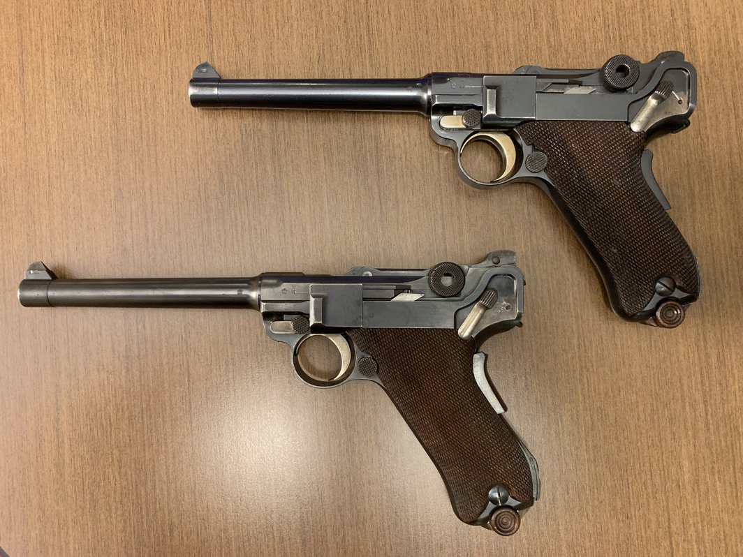

If you are curious, here is what real 1904 P.04s look like. Photos from 21 Feb 2019, when two extremely high condition originals were together at SOS.
