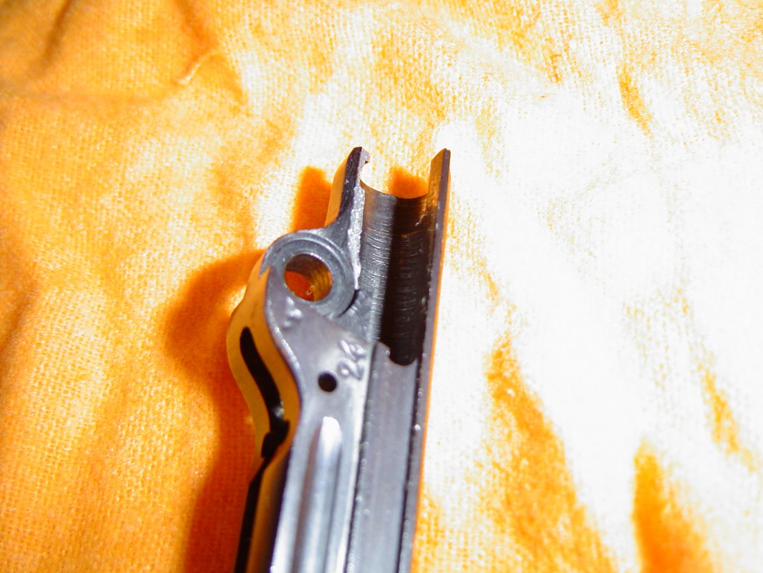

Kurusu- What broke when you finally did "break" your BYF 41? Did it kill it or just require a part replacement and move on?
A picture is worth a thousand words (even my lousy pictures ).
Replaced with one from another BYF 41 that I was lucky to find.

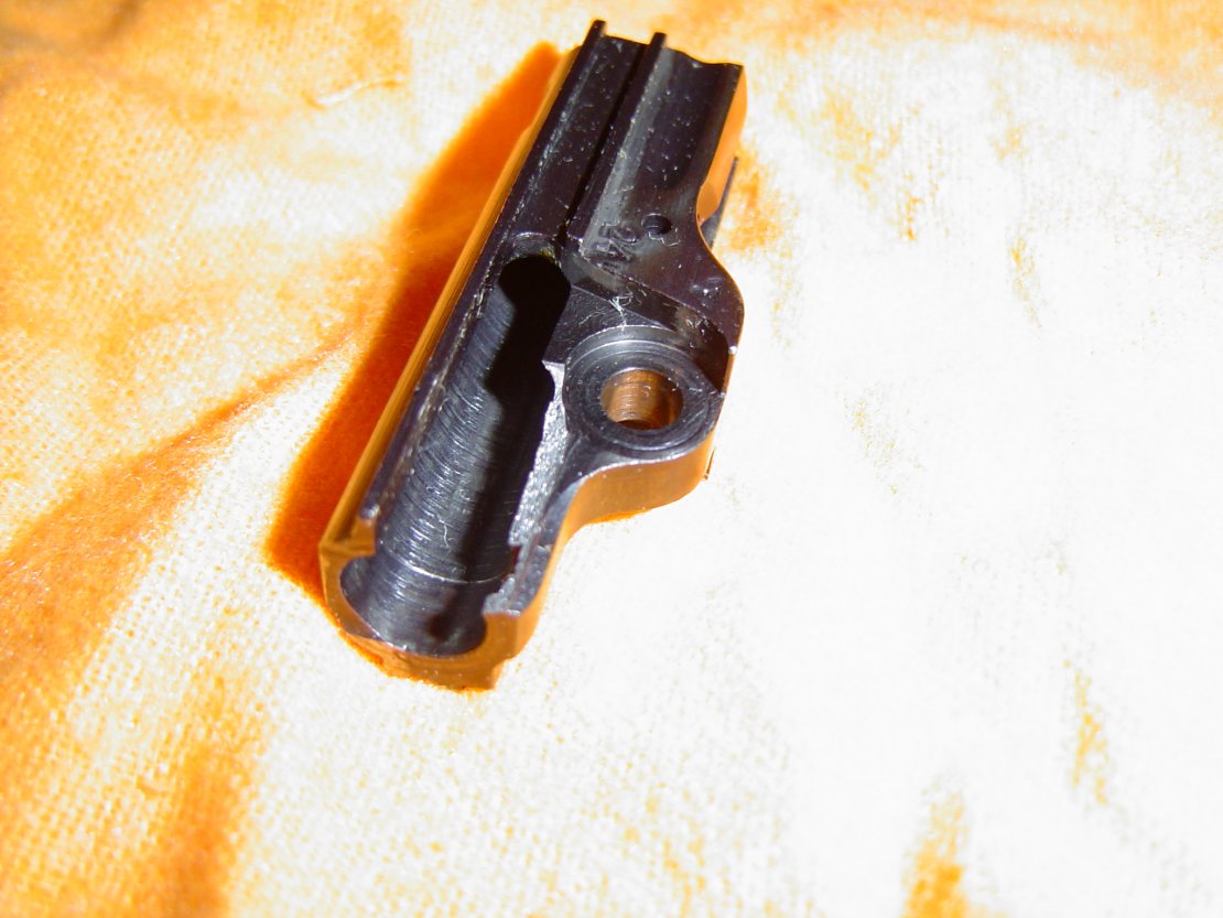

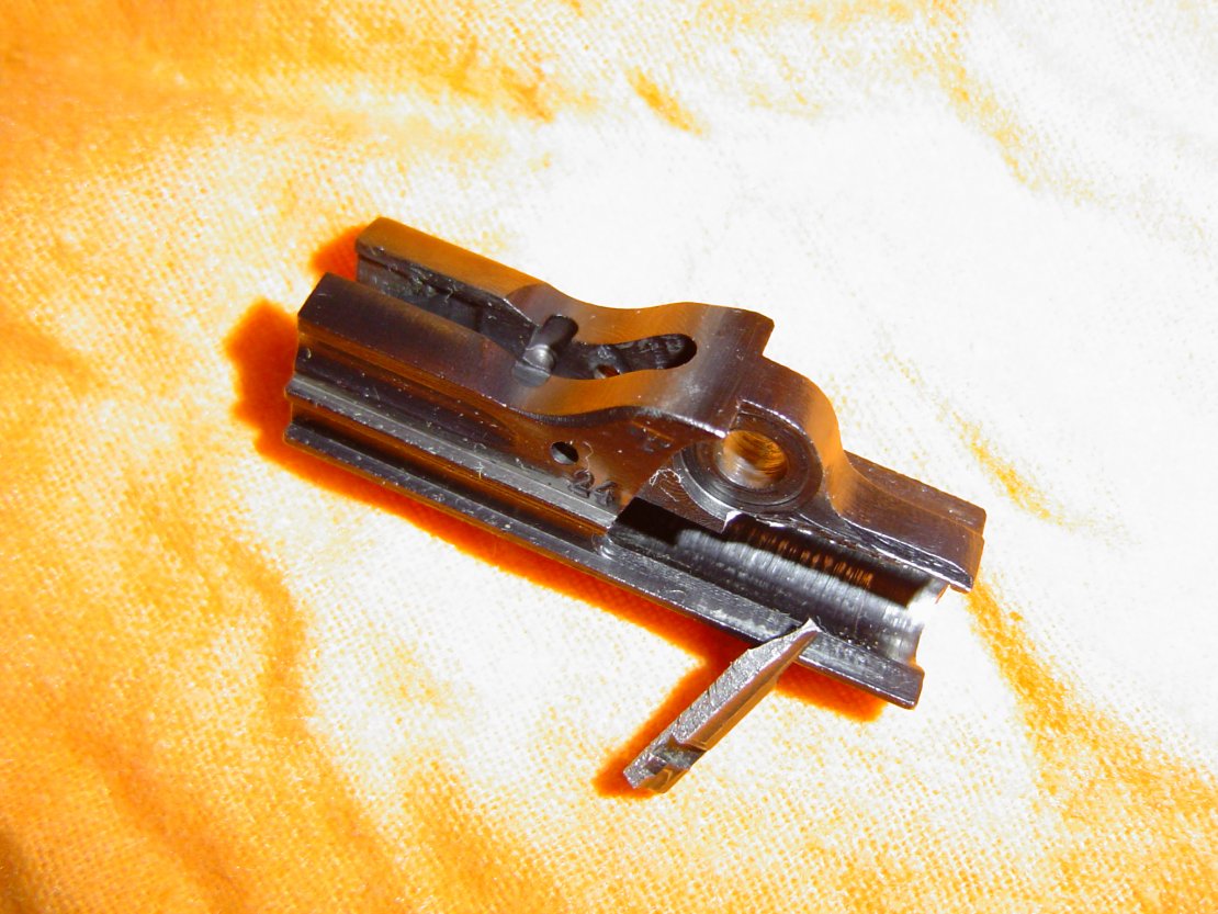

And another 2 pictures.

Thanks for the pictures, I'm with the Texan on that failure, probably a flaw in the metal from the beginning.
The pictures do help show how the striker retainer engages - like a "cut a way" picture.
