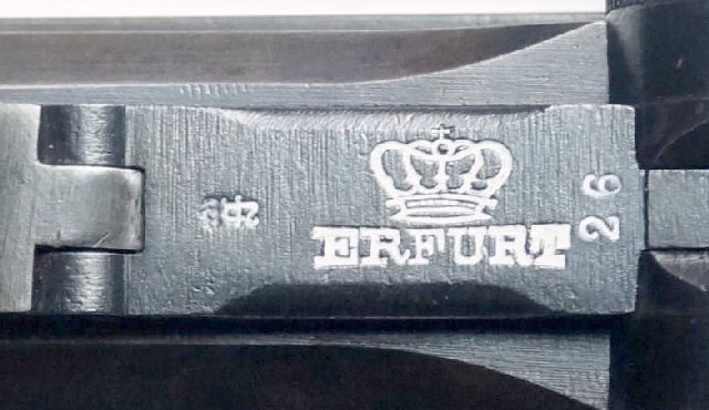

Have a look at this one, and I'll be interested in hearing from the experts.
I'm not trying to pick on Mr. Luger. But my initial concerns are that it is a 1917 Erfurt artillery(?), a very thin and questionable set of leather, and I can't see if it is relieved for the rear sight. Your thoughts? https://www.gunsamerica.com//9210460...AZINE.htm?wl=1 |

Poorly reproduced holster and mag pouch---not original... sorry-- the seller doesn't know what he is talking about. The magazine is questionable as to the numbering. The pistol has been reblued. $1100 tops... not $3500.

I can't tell either [pic attached] but they are fine-tune sights F&R...
Also, the page in Jones is for a 1914 Erfurt artillery. I don't think you can use a 1914 anything to verify a 1917... Nice big pics, BTW...2928 x 1707...He ain't hidin' nuthin'... ![]() Jones had a comment on Erfurts being poorly finished...and looking at this toggle, he wasn't foolin'... ![]() (I actually have trouble believing the toggle is machined, looks filed to me)... ![]()

The leather is all fake as is the magazine. The pistol is a mixed parts gun; 1917 DWM receiver with Erfurt toggle train. Erfurt made LP08s in 1914 ONLY.

I suppose it could have started as a "normal" 1917 Erfurt, and grew the barrel at a later date. Erfurt proofs on the receiver, but DWM on the bbl/rear sight base. Strange that the all important picture of the bottom of the barrel markings is missing. Condition of the rear sight leaf does not go with the rest of the piece. Someone either re-numbered or got lucky in finding the rear sight base with a "26" though.
Holster looks just like my indian reproduction, just aged a little, the "square" shape to the mag pouch is identical, and the square top strap is carefully tucked under. The straps also have the metal plate attached, and as someone said are quite thin. He likely told the truth that this was the first 1917 Erfurt he had seen! |

A 1917 Erfurt toggle stamp would have the broken crown lobe by then, wouldn't it? The stamp looks amazingly crisp compared to overall toggle condition and the small cross on the top of the crown migrating into the radius cut on the edge of the link all look either bogus or "freshened" to me.

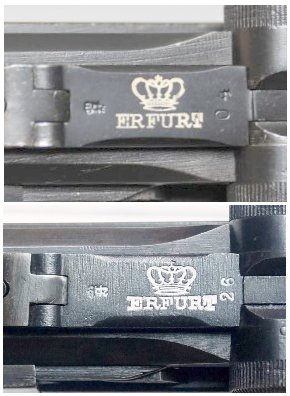

![]() Quote:
I would have thought for their volume of production they would have multiple stamping stations. I guess another way to ask is: do all late Erfurt examples have a broken crown? ![]() That said the stamp is quite heavy and clear, maybe a replacement for the broken crown? |

This is an early ERFURT toggle because the crown is complete. It is my belief that they never replaced the stamp after it broke... and all late toggles have the broken edge on the top right of the crown. If you have information which disproves my hypothesis, please post it.

![]() Quote:
"Originality can't be restored and should be at the top of any collector's priority list. |

![]() Quote:
![]() So it's the extreme right side of the crown that has the chipped/broken die imprint??? ![]() Is there any evidence of what year this occurred??? Sergio, your toggle looks orders of magnitude better than the one on GA. Doug's comment on the stamp impinging on the radius is well taken. I think someone has a nice new Erfurt stamp. But they need a finer tooth file. ![]() Edit: The GA Erfurt stamp is not centered lengthwise either. ![]()

Thanks: 1,082
Richard
Yes it is, 1918 doubledate. I've got no evidence of when that exactly happened mine is # 2904

I have an all matching 1916 Erfurt with the right side broken mark. I had a 1917 Erfurt and it was even more pronounced. . Bill

Richard: In Jan's Central book he shows: 1914 with a broken die., A 1916 without a broken die, a 1917 and 1918 with the break. So ????? Bill

![]() Quote:
![]() And the chamber date on the Jones "1914" LP-08 is 1917...

I magnified the receiver image and I think the inspector marks and the firing proof are Erfurt. So it looks to me like a DWM barrel added to a 1917 Erfurt.

While I'm neither Ron nor George, I've never seen any German Luger part as rough as that toggle link. It gives new meaning to "wartime expedience".
