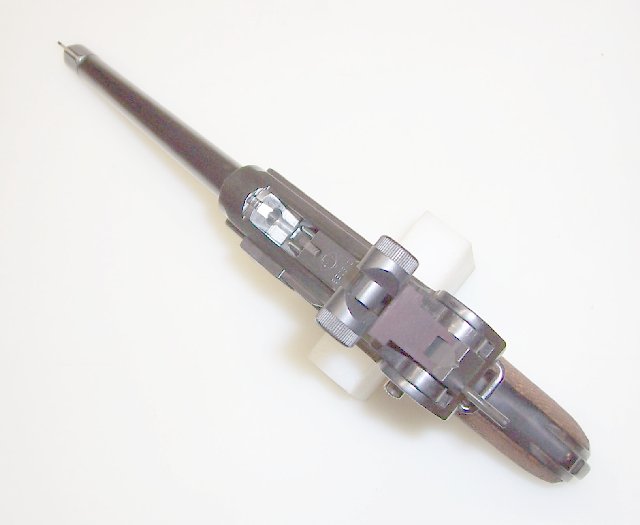

I should get me one of those oh, I have one
The guy who owns this one wants me to shorten the barrel insert, so it ends at the muzzle...
I'm almost done...Got the shortened insert threaded...Just have to make a nut...

Dave, that .22 conversion unit of yours is quite different from the 4" unit that I have here...Obviously the barrel insert is longer [lots longer] but the toggle assembly is completely different...
Without the spacer, the insert I have here would just barely fit a 5 1/4" barrel...Which would be a 130+mm Luger 9mm barrel...If there ever was such a thing...

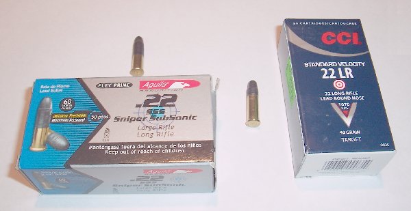

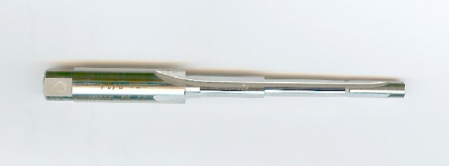

I took a ride down to my LGS and he agrees: .22LR chambers will fit a Stinger. That's cool, because I have a .22LR chambering reamer coming.
I also bought a box of .22LR 'Aguila' Super Extra [with label on box 'Eley Prime', whatever that means], 50 rd box @ $5.00. He had one brick of that come in from distributor, and a brick of .22 Subsonic ammunition, that looked like a .22 short with a real long bullet. I didn't think that would work any .22 action I have, so I left that alone. (I don't have any bolt action .22's or revolvers).
I was thinking that the Erma barrel inserts are longer than the Luger barrels because it would take longer to build up the pressure to toggle the action than if they made it the same length as the Luger barrel...
Dave - Does your Erma toggle have a model number on it??? This one says 'SE 08/2'...
Edit: I went back and bought a box of the 'Sniper Subsonic' .22's...Looks like a .22 short to me!!!

This is the first time I have ever seen a subsonic cartridge with a bullet like that. I have a couple of different brands of subsonic .22 ammo here, and the bullet on them looks like a normal 40gr bullet. Interesting!!.
I think these slugs are around 60 gr., which helps diminish the velocity to somewhere in the vicinity of 1000 fps, + or -.
...[with label on box 'Eley Prime', whatever that means]....22 Subsonic ammunition, that looked like a .22 short with a real long bullet. I didn't think that would work any .22 action I have,
Ely is another ammo manufacturer. I think Aguila gets primed brass from them, or at least uses Ely's formula, probably under license. The various ammo makers' arrangements and manifestations seem a bit incestuous at times...
