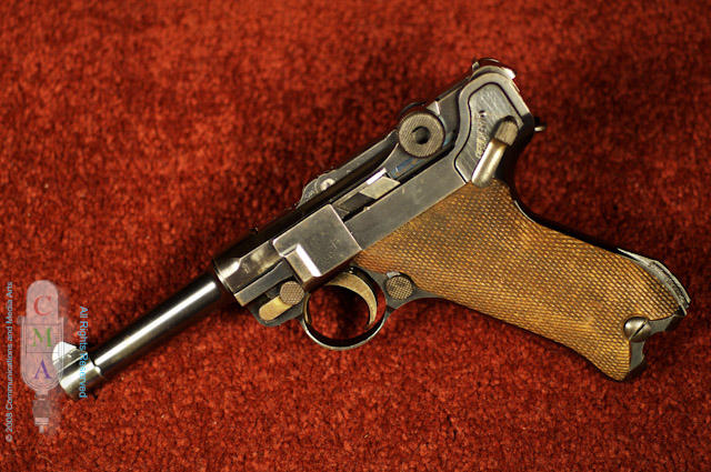

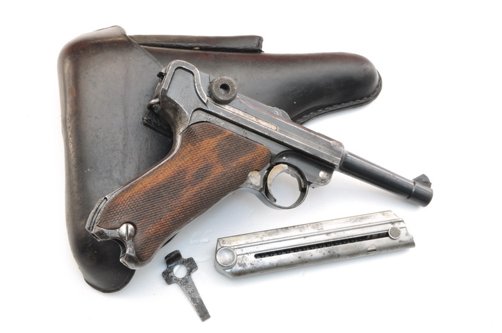

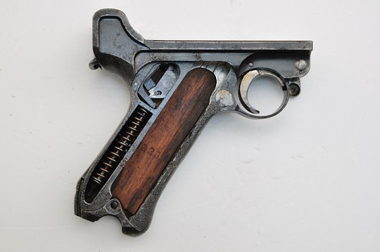

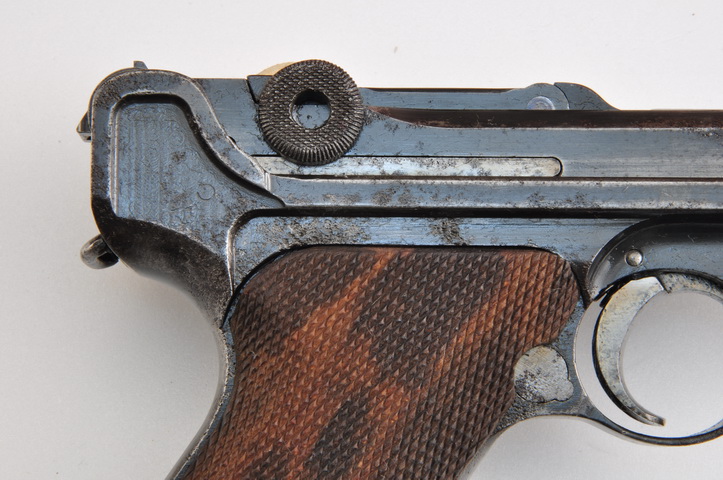

Good Morning Gentlemen
Last week i got “new blood” to my collection. After I was reeding the books for two years, I think to identify it as an “1920 Commercial” following Kenyon or an “Alphabet DWM” following C.Still.

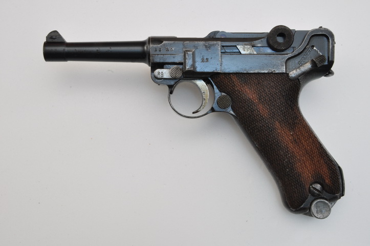

Checking the Serial 8225n, Still relates this gun as an 1924 or 1925 production. Checking the Aluminium Magazin Base, I think it would be an 1925 production.
Will you confirm my opinion ??

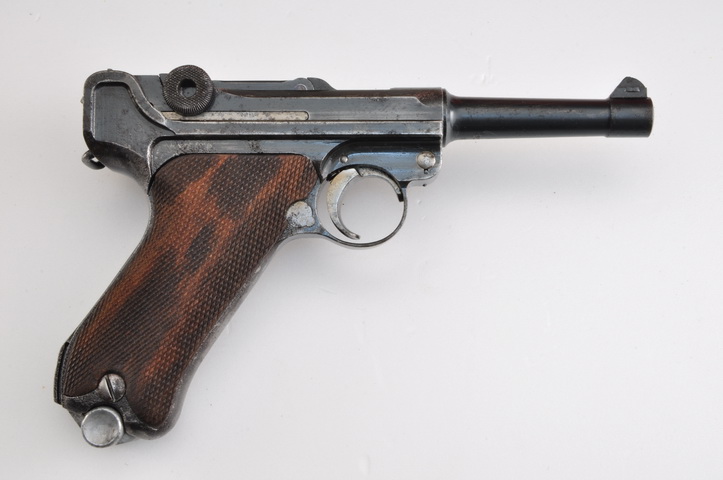

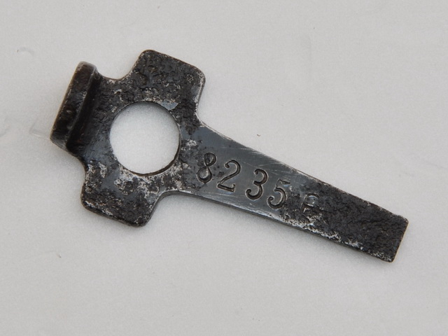

Wooden Grips, they match the gun, but only when we assume that man at the dies was an dyslexic. One is numbered 8225 (matching) and the other 8235. Make your decision, or if possible show me another way how this can happen. Also the “Screwdrivertool” is numbered 8235.
Maybe simply a moment of distraction, while setting the stamps ??
Has anyone documentation available about the production process of these old guns, any books to read ??

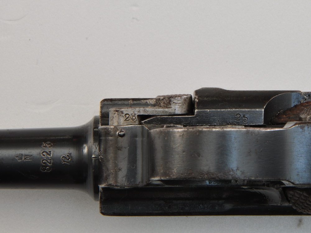

Along with Kenyon, the gun should be serialized in commercial manner.
Correct, Sideplate and Lockingbolt are stamped hidden, but also, additionaly, both parts bear also the numbers in a military placement …..
Comments from the longtime collectors are welcome….

The holster is an old “Imperial one” with an inkstamp indicating affiliation to the “IR137” and an embossed stamp showing the production of this holster in 1915 by “Hans Römer – Neu Ulm”
I got all parts in bad condition, rusty, dirty and the leather was stinking like it was stored for years in an old stuffy gardenhouse. According to my information the owner of this gun died a few months ago, currentlyI am trying to get more information about this gun and accessories from his testamentary heirs
I will let you know, when reaching new information.
In my opinion this gun was bought between the wars from a private citizen, it was according to the treaty of Versailles an 7,65mm 3 5/8”” barrel version. It was not heavily used (good bore and less wearout at the contact surface between rear toggle link and frame).
After the times have calmed down, the gun was layed aside and forgotten, probably this year the old owner died and the legal heirs found the gun and sold it.

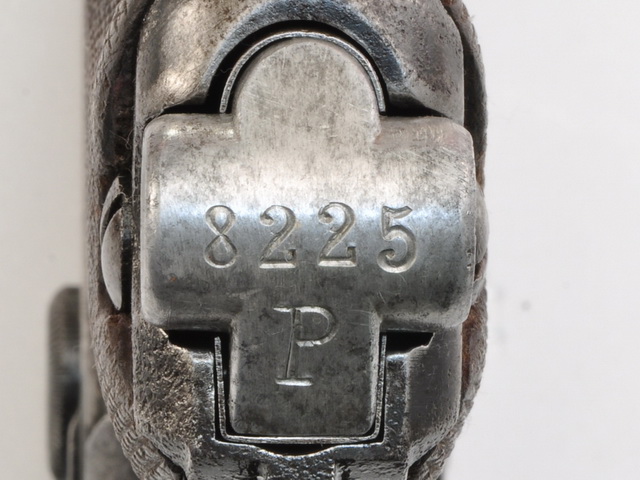

Any ideas about the “P” at the magazine, also the screwdriver seems to bear an “P”

Interesting how it shows both military and commercial style (location) of the numbering on the side plate and takedown lever. Is this common?

Both your grips look like they are numbered "8225" to me... The tool isn't.
My ""m" block DWM Alphabet Commercial was made about 12,000 pistols before yours.
It shows none of the military style parts numbering yours has.
Also, I've never seen the C/N stamped in the middle of a serial number.
Could this have been done for non-export pistols?

I have seen that "P" marking before sometime, but I can't recall when or what it meant. The gun is an alphabet commercial that was marked in the commercial style, but it has been reworked and marked in the military style so the receiver serial number was applied "around" the original Crown/N mark.

I don't remember seeing a P like this before, and the only grips I remember seeing
with all 4 of the serial number is a Simson. Not sure I think its a simson rework, but anything is possible. However, the "P" makes me think that a unit had two of the same serial number, and the P was placed to make it stand separate?

Hi Wolfgang, Could the P number be an Austrian Police marking? Regards, Norm
Hello Ron,
when conjureing up the facts about the "P", pls let me know....
thx
I am completely confused about the numbering.
Besides an 1900 commercial, this is my only "privat" gun, so i have less experience in commercials and their numbering.
Keeping in mind, that, according to kenyon, an commercial receiver should have serialnumber stamped on the stop lug, i can't understand the time flow of events.
Let's presume, the gun is an alphabet commercial, then i should have "crown over n" proof left on receiver and "serialnumber on stop lug".
When undergoing an rework for military use, it should have now, "serialnumbers lefthand on receiver", but the serial on stoplug has to be also present.
But, there is no sign of an serialnumber at the stop lug...
Ok, ok, could be removed from the stop lug, but why should they do this, makes no sense, work for nothing.....
Ok,ok, while writing and thinking some things getting in my mind that would asset the missing number. The receiver could come from an other gun, with an other number, so i makes sense to rework the stoplug area to delete the old serial.
At this specific field i have to learn .......
regards wolfganggo .....
