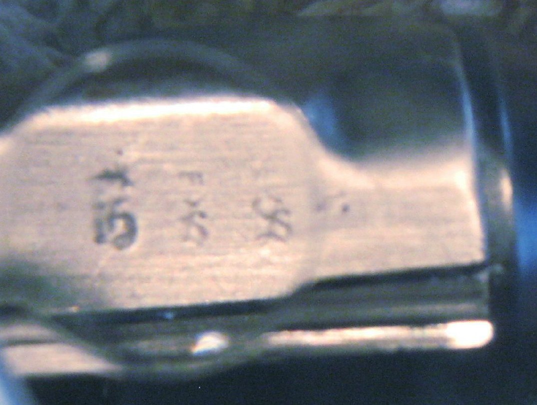

Hi Guys. After more than a week of reading here I now can clean, and I think, call my Luger a Navy LP08. It is a S/42 and has a German eagle mark on it. So I think it was made between 1939-40 but no dates anywhere. All the numbers match ( Ser. # 8773) and has one mag. with a wood bottom. The wood ball is broken into two pieces with one piece missing a chip. My pictures are of no help seeing any detail. So, I am sending a photo copy of each side of the weapon with ALL markings shown by hand. Hope this helps.
I have $1,600.00 invested so all the information (good and bad) and history on this Luger will be greatly appreciated.

Arty notch in receiver; Erfurt??? The radius of the barrel flange looks too gradual to be made from the Luger blueprints...(Assuming the arty uses the same radius, which the ones I've seen pics of do)...
Front sight base looks like 4" base; blade looks higher than the 4" blade...
Serial stamped into the barrel...
Looks like a fun shooter; but the price seems...excessive...
In the stripped pics, it looks "in the white"...???...

Andy, I know nothing about Navy lugers...I've read here that some "Navy" Lugers had 4" barrels and fixed toggle rear sights...The stampings were what determined whether it was a Navy issue or not...but a toggle mounted 2-position adjustable rear sight and a ~6" barrel are considered "Navy" as well...
Closeup pics of those frame markings/stampings will show exactly what it is you have...or what it's not...Drawings are not much help, as there are Lugers out there with false markings on them, being sold for more that they're really worth...A good closeup of that barrel serial is a good idea, too...along with a closeup of the frame serial (to compare fonts and number heights)...And any proof marks on that barrel...

In my opinion, you have a luger made up from parts of other lugers. The barrel and the S-42 toggle were never originally together. The barrel was force matched by adding the frame serial number. It would make a good shooter but never a collectible luger. Can you still get your money back? I would place the value around $800 - 900 or so strictly as a shooter. I'm sure my opinion is not good news but maybe you can get a refund or price reduction? Welcome to the Forum and the crazy world of luger collecting. I'm sure others will get in here with their opinions. Bill

It is definitely worth posting pics. You may have a Luger that is worth more in parts than as a whole. Knowing what you have is always a good start.
