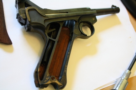

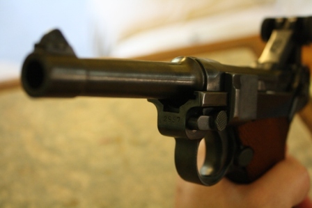

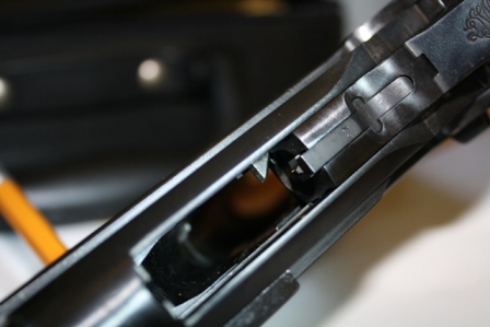

Hello everyone,
I'm afraid I made an overconfident-newbie mistake with this Luger.
It appears to be a 1917 DWM police model. Frame and receiver serial numbers match, but none of the others do.
The bolt hold-open wasn't working, and the previous owner's effects included a receipt for a "hold open latch w/spring", so I decided to follow the disassembly instructions in the hilariously-translated Parabellum manual.
I did this successfully, and reassembled it successfully too. I decided to count myself lucky and rest my aching fingers for a few hours.
On returning to the pistol, I asked myself "Why didn't you inspect the hold-open while you had the thing apart, like you were going to?"
"Now is not the time to start pointing fingers," I replied. "Let's not argue. Besides, taking it apart and putting it back together is fun!"
So, I got it back apart and identified the hold open latch w/spring. Manipulating it a little bit caused it to pop right out, and I saw that it was supposed to clamp onto an axle in its little groove, which I did. I put the magazine into the "bifurcated stock" and the little hold-open popped up, just like it wasn't doing before I got started.
I did a little chair dance. Success!
But I guess I was too eager to try it out, and put the whole mess back together wrong. As soon as I pulled the toggle back, the whole receiver assembly shifted backwards, so that now the front of the receiver is about 3/8" back from the point where it would be flush with the stock.
I am able to work the bolt release lever and remove and replace the trigger guard. I can pull the toggle back just a hair, but nothing seems to release it.
I found a previous thread with what sounds like a similar problem, and the poster eventually got the thing apart well enough to fix the spring on the hold open, but I can't see how to get it back apart. The hold open release latch inside the chamber that is referenced in that post is not visible in my gun's chamber.
Any ideas? I am happy to supply pictures, some of which may include circles and arrows. I will supply the paragraph to go on the back of each one to explain what each one is.
Thanks in advance,
Matt

OK, I am attaching photos here.

It sounds like you have a stuck holdopen. Try this link; http://forum.lugerforum.com/showthre...stuck+holdopen

Matt, It is possible to observe the holdopen spring and bar in the chamber. It is along the right side below the frame rail. You can't see a lot of it but it is possible to take a small flat head screwdriver and push down on it just behind the flat spring. You should also be able to see a small slot right at the rear of the spring...This should release the bolt to come forward. Try it out...I locked open one of my pistols and it worked fine.

OK, thanks guys. That actually was the thread I read before, but I wasn't having any luck fearfully poking my finger into the bolt opening. This time I used a paperclip while my wife held the flashlight, so I could securely hold the toggle and fiddle with the spring.

...???...But did you get it to disengage???
If so, what did you have to do to get it to release???
Unread 07-08-2009, 11:14 PM   #8
mattnashbrowns
Posts: 5
While pulling back on the toggle with my right hand, I gently depressed the tiny black tab underneath the highly visible retracting-nickel-triangle thing, using a straightened paper clip in my left hand. I was able to slowly release the toggle at that point.
The problem is not totally fixed, though -- the bolt won't hold open when a magazine is inserted. The piece of the mag that serves as a follower is the chintzy little knurled knob that you can use to depress the magazine spring. Instead of pushing straight up on the hold open spring, it kind of pushes its way around the side of the spring and gets stuck there. I can see it doing this if I put an empty mag in the disassembled frame.

Matt, It's easy to bend your HO spring up to far when installing HO into the frame, if you're not familiar with the procedure. I do have new HO springs available, if necessary. TH

Sounds like the magazine is the problem. The button should be tight and straight against the body. If there is too much space between the button and the mag body, it can get stuck somewhere.
A good trick is to try it with the grips (or at least the righ hand grip) removed. Visibility and tinkering space will improve drastically.

It's pretty clear that the retractor knob on the magazine is not right. It is tilted away from the mag body at the top. Is it safe to try to straighten it with a pair of pliers?

The button is pinned inside the follower, so you could either try to force it in, or gently tap it out with the right pin punch, straighten the button pin and then reseat it into the follower.
Alternatively, you could get a replacement magazine like a modern MecGar and use that for testing.
