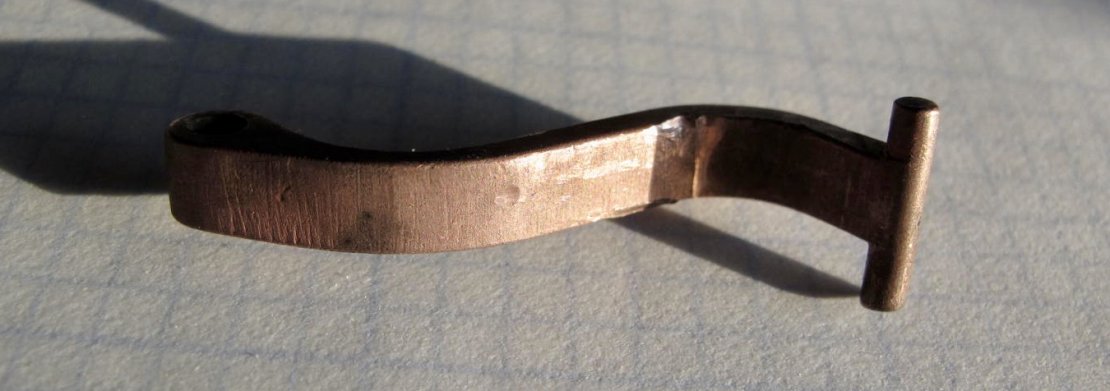

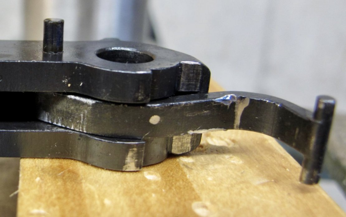

I like to share good news when I find it and today while browsing a machinist website I came across this method for the removal of rust from steel that is slicker than any other method I have ever seen.
Here is the link on this amazing technique that takes nothing more than stuff you probably already have around your house:
http://www.frets.com/HomeShopTech/Qu...stremoval.html
Here is how well it works as a preview:

NOT recommended on "rust blued" finishes on guns because the BLUE is actually a form of RUST...
If anyone should intentionally use this process on a rust blued gun part, please post photos of the results here.

I believe that the electrolytic rust removal described in this thread MAY also remove gun blue finish... the only way to know is to try it on something non critical. Perhaps someone else has already tried that and will post the results here. Blue is in fact a type of rust.
FOUR ZERO "0000" steel wool and a good quality gun oil used very lightly will remove a small amount of surface rust without harming the overall finish... Some would recommend bronze wool... as it is less abrasive.

That's correct John, i've done some research and it will sure strip it back to bare without any hassles, if you want to reblue or resto a project or something, no problems, but don't go putting something in there that you arent prepared to take out bare.

I did try this specifically to see if it takes blueing off, and it really does take it all off!
