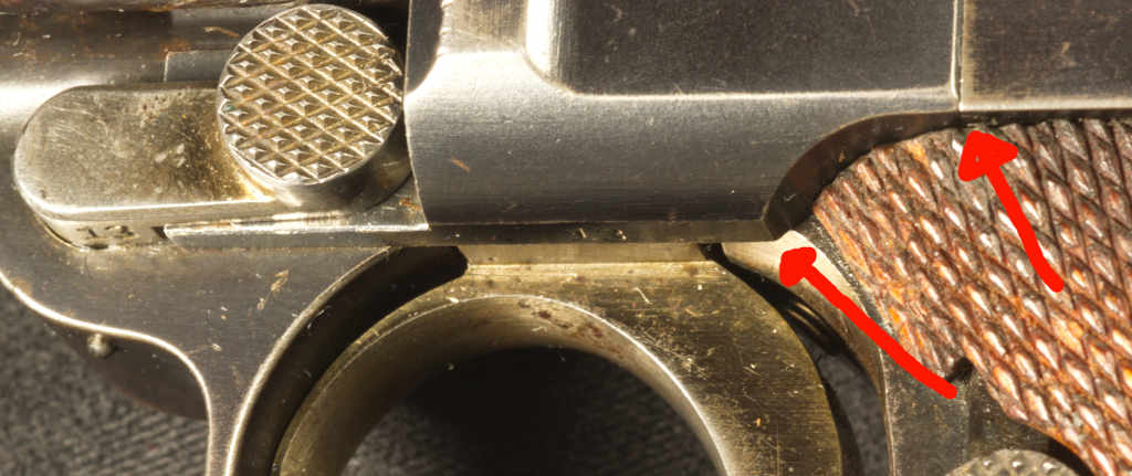

Ron, This is Swiss 2813. It is fitted proud to the frame on the right edge and in the trigger guard area. Red arrows indicate.
Thiis makes me wonder if the standard plate always left enough metal to be proud of the frame, but the process of fitting it milled some down farther than others?

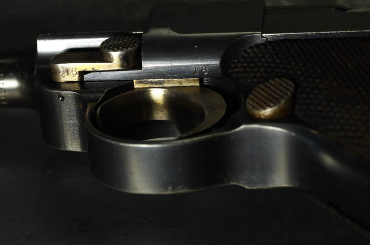

This is another DWM made Swiss, M1900/06 sn 11816 made in 1909. The plate is clearly proud of the frame in this picture.

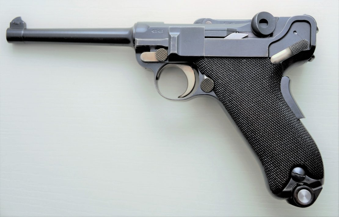

Unread 09-10-2017, 04:08 PM   #14
Absolutely, early production Model 1900 Swiss Luger chambered in 7.65mm Luger, its chamber is stamped with Swiss "Cross in Sunburst" crest, unrelieved frame and low button magazine.
