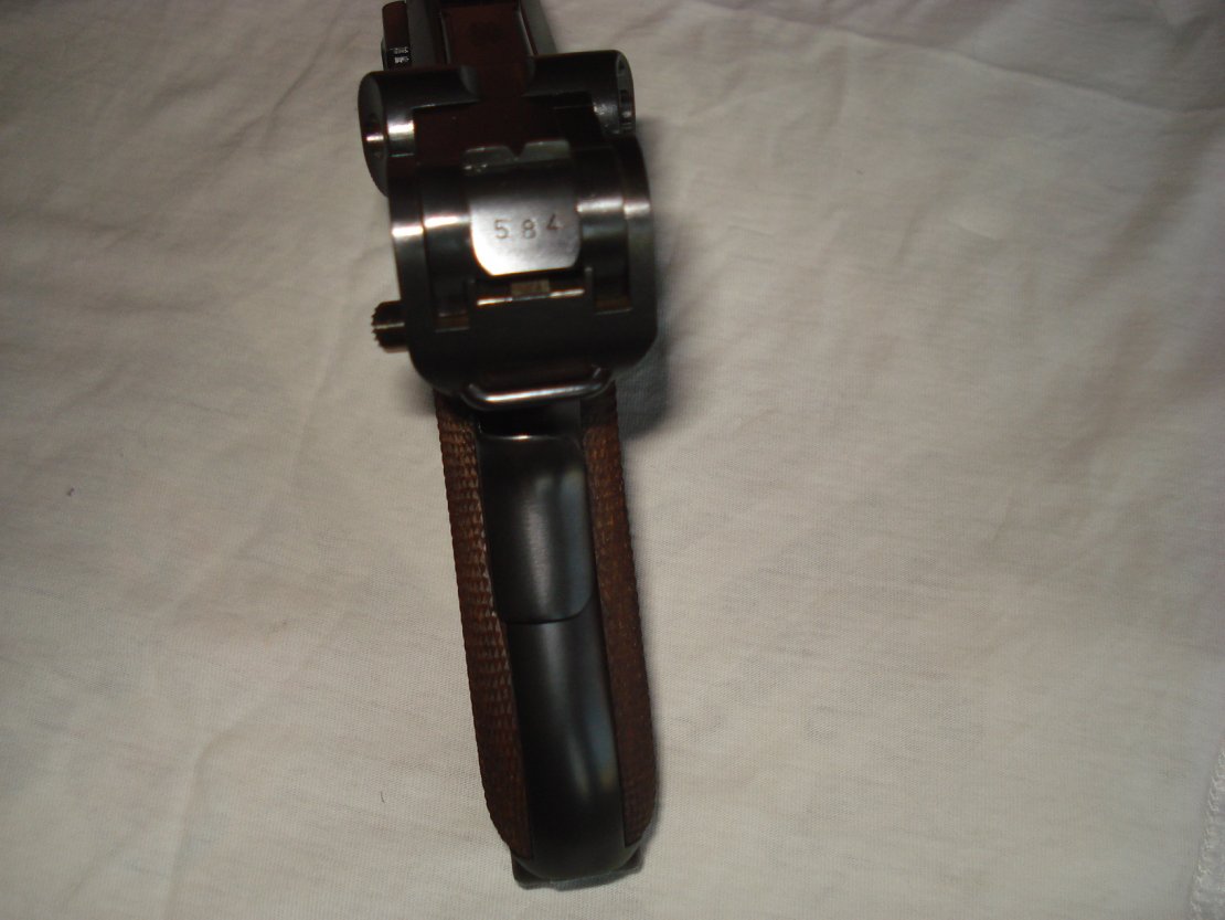

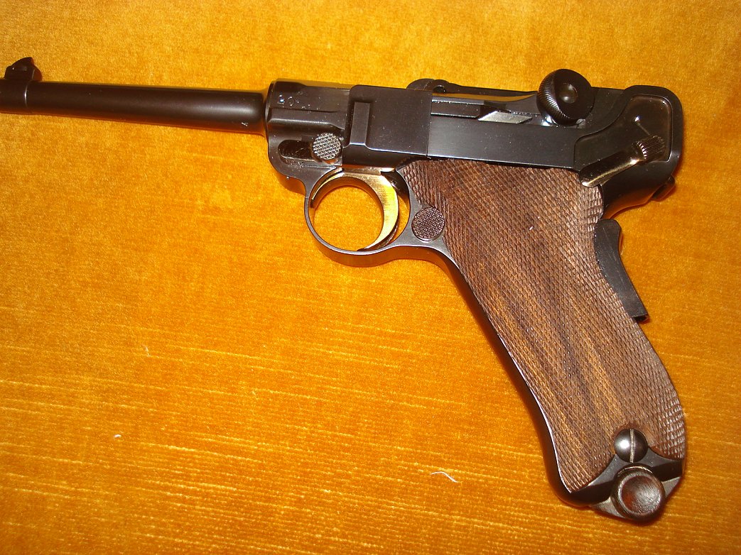

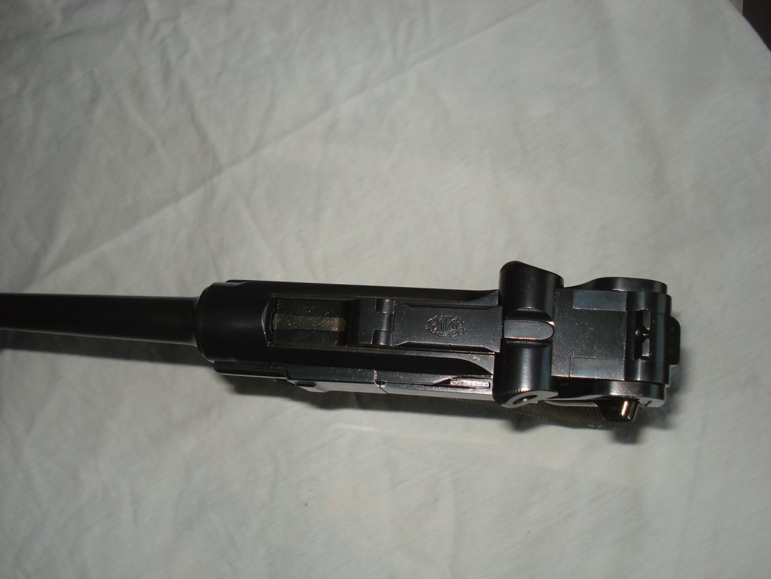

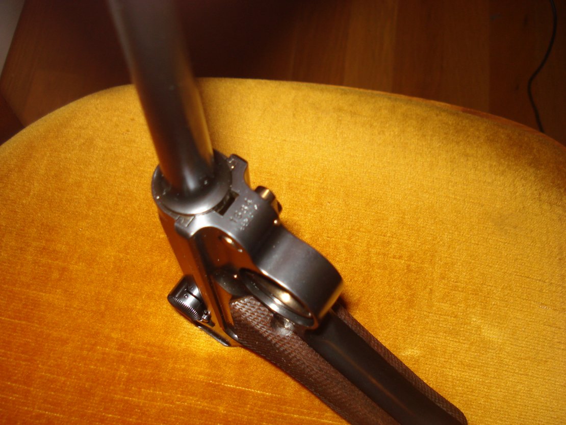

I`m trying again to post some photos of this 1900 luguer
The gun is in excelent condition.As it is in Portugal i wonder if it could be a luger made for military test ?
Thank you for any advise

Hi Pepe,
I doubt a military test gun would be stamped "Germany", which is a stamp that was required by the US, (and perhaps other countreis) for import.
If that finish is truly original your gun is in outstanding shape, although absolutely NO wear on a front strap or backstrap is always a red flag for me.
Unread 05-16-2011, 09:24 AM   #4
Certainly looks like a re-finished 1900 commercial to me too. A nice gun. Is there bluing under the safety lever?
More photos please.

I am sure it is refinshed, but it is a nice early commercial.

Well, if that isn't re-finished I will be eating crow, BUT given the blackness of the finish, no visible halos, minty grips and mag. bottom, and generally poor photos I stand by my "re-finished" verdict. Not to say that I could not be wrong.

The grips don't look orginal to my eye, slightly ill fitting, the color too light to have over 100 years wear on them and just too pristine with respect to the diamonds.

I am glad you have not yet purchased this Luger. As one of the “closed and ignorant” persons that Albert warned you about, I would like to make some comments about the gun.
It is a very early Model 1900 and should have a Type II thumb safety and a narrow grip safety (only slightly wider than ½ the width of the grip strap). The grips are reproduction. The checkering is not as fine as the original 1900 grips and you can clearly see at the top of the grip that it is not shaped correctly. It is difficult to tell from the photo but it appears that the front sight is blued and not a heat treated “fire blue” finish. Bluing is always difficult to evaluate from photo due to variances in type of lighting, background, etc., but the finish on this gun looks too dark and there are absolutely no flaws or wear anywhere on the gun. Although not impossible, while I have seen some really superior original Lugers as early as this one, I have never seen one this perfect.
There are Model 1900 Lugers that have been attributed to early Portuguese testing. There are no surviving archival records to verify this, but it is generally accepted. These guns bear a large two-digit number on the side of the receiver like the “20” on the example you are looking at, but they are of much later production in the 18XXX serial number range. This gun is much too early.
In my “ignorant” opinion, this is a refinished gun with replacement parts and an obvious forgery that is an attempt to replicate an early Portuguese test piece. I also find it amusing that an outstanding restoration could not be made in Portugal…there are “artisans” in every country!
P.S. The "GERMANY" stamp is the final kiss of death!
