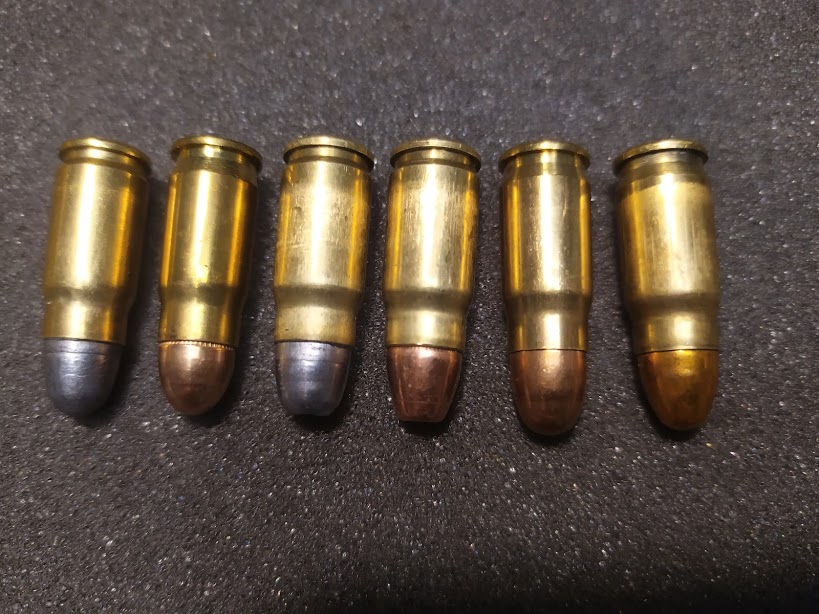

I use :
CAM PRO cal.7,65mm Full Copper Plated Round Nose Flat Point 85 grains
Works fine resised in 308
Reload n°4 from left to right

I use too , on my picture :
Lyman lead 90gr
Fiocchi 93gr
Lyman lead holow point 85gr
Campro 85gr
Prvi 90gr
H&N copped bullet 85gr
