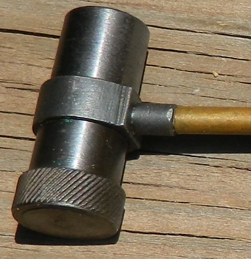

Unread 06-25-2013, 10:19 PM   #1
I do take some nice close ups!! PS Thats why I went to Law School for three years! A man must know his limitations, wether real or imaginary~~~

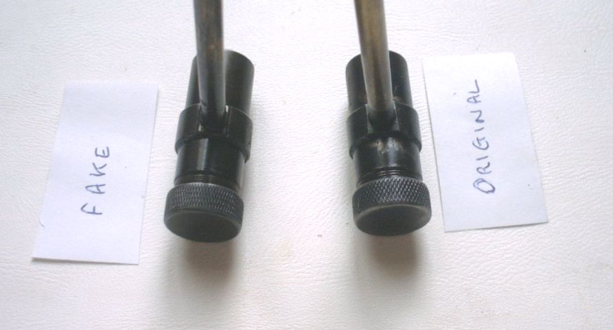

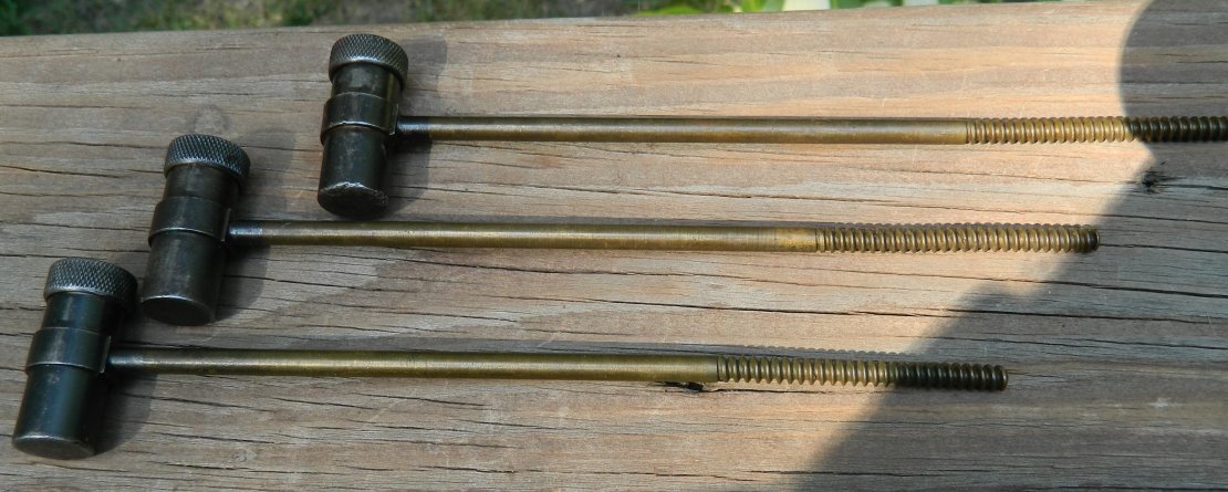

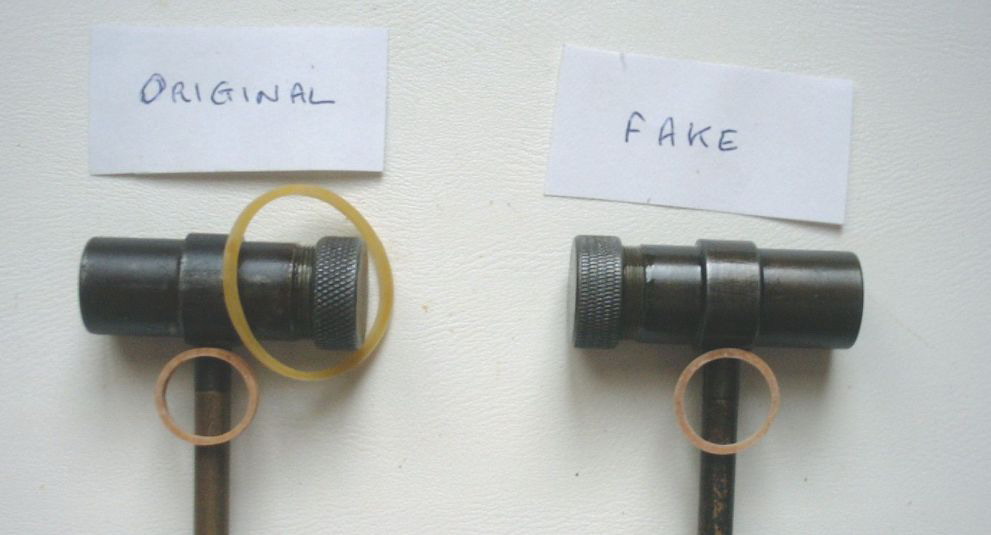

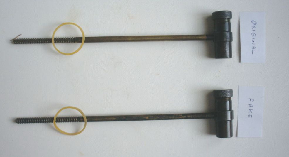

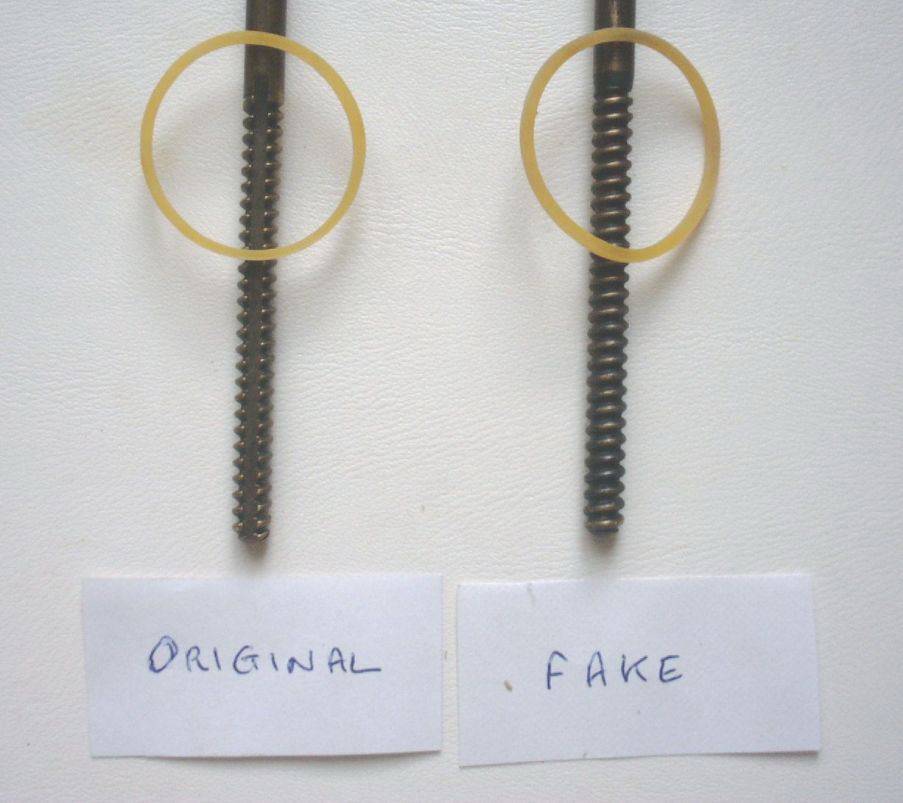

I do some pic in the past about original and repro , here they are from old post :

Patrice..I would be very happy to see your photo's with a little better lighting..It's hard to distinguish details in the low light! Thank you though..

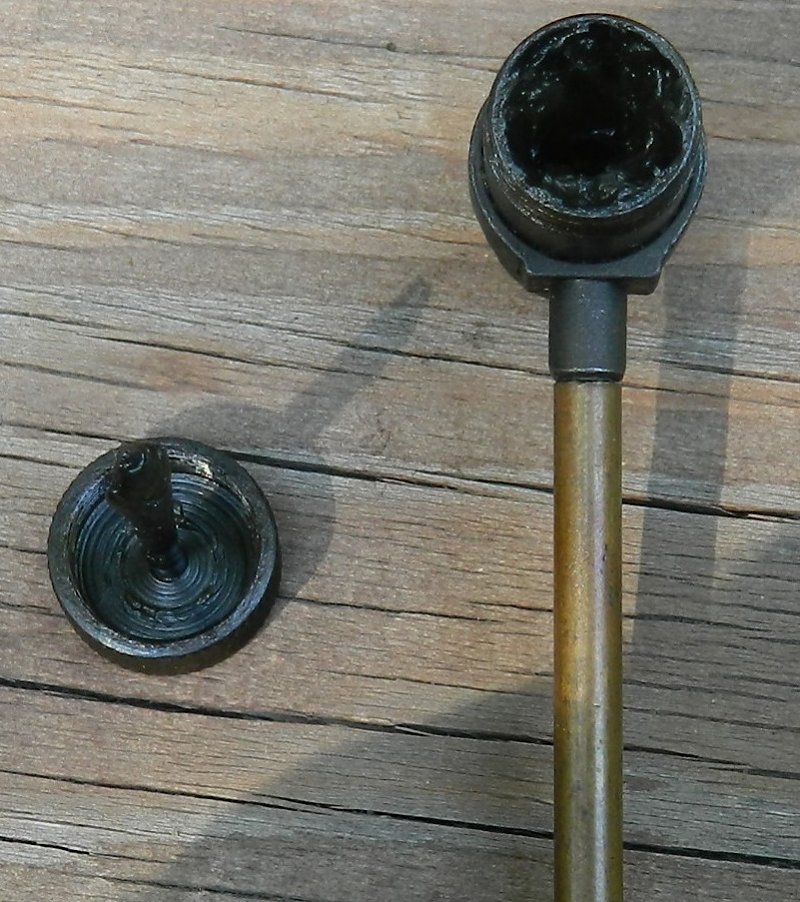

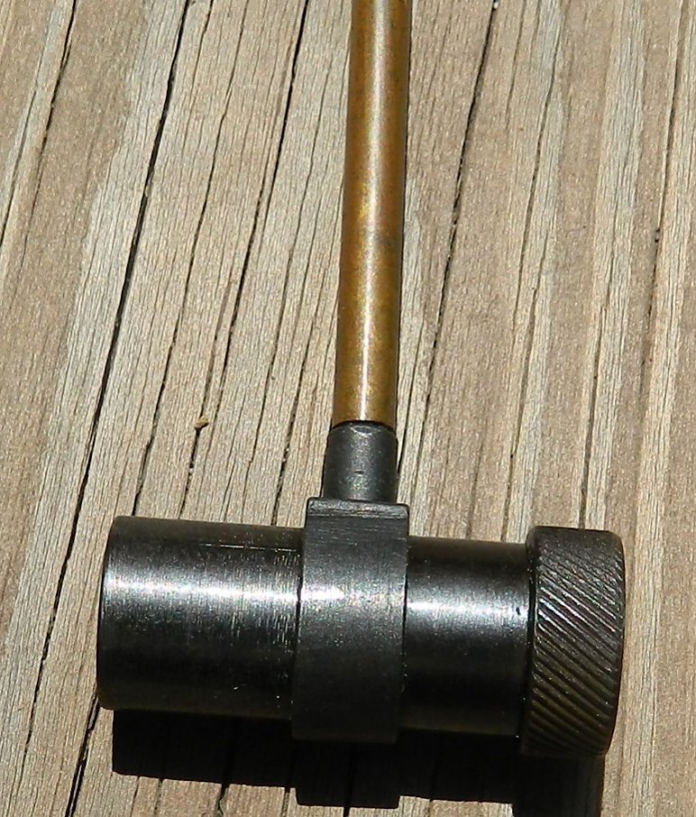

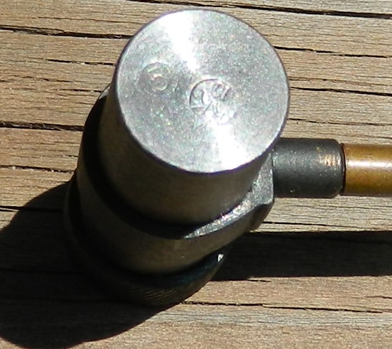

I have a rod like yours. I don't know if the brass rod is threaded or not, but the steel neck is staked/crimped to the brass shaft so it will not come out. I think it is Portuguese because the end opposite the oiler has both KK 10 in circle and 5 in circle.
I will try and post pictures later.
Thanks

The thread on the barrel is also thinner on repros
Unread 06-26-2013, 02:42 PM   #7
OK, I need a little help here...Are you talking about the entire full length of the rod being soldered to the grease pot clamp??? Or just the stub that I can see the rod being inserted into??? Whether or not the brass rod is soldered or threaded into the stub...
Is the brass rod w/auger supposed to be removable???
I don't think I can understand this without looking at/inspecting one...
Hi Rich, I'm referring to the junction between the brass shaft and the steel handle. Without heating one of these up and dismantling, it's not possible to tell if the turned down end of the rod is threaded or not. Of course, that's assuming that the rod is male and the handle is female. The point is that the joint is designed to be permanent and non-rotational.
Regards, Norm

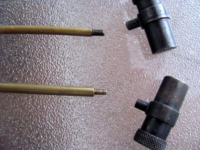

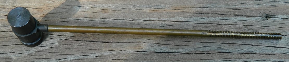

Thanks Ed, heres a screw closeup! They are not interchangeable!
Unread 06-26-2013, 03:23 PM   #9
Norm, both of these are definatly 'non permanent'!Do we have another genuine to compare?

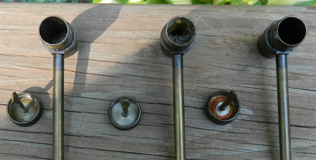

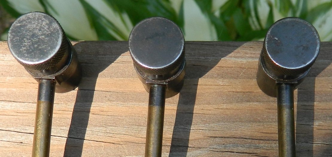

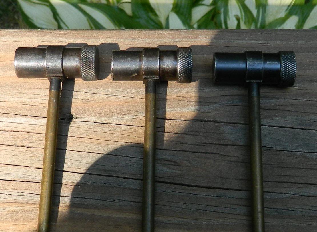

After I got home from work I had a chance to dig through my cleaning rod collection and here are some photos of original soldered shafts. These oilers have a rust blue outer finish as the insides are in the white.
Thanks
regul is offline   Reply With Quote
The following 3 members says Thank You to regul for your post:
Unread 06-26-2013, 06:21 PM   #13
Wow big difference!!!! Tks
Unread 06-26-2013, 08:13 PM   #14

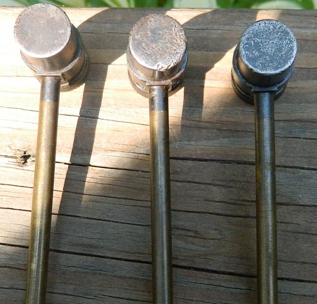

It would appear that the grease containers were regularly used as hammers for tapping in pins, etc.
Unread 06-26-2013, 08:27 PM   #15
Doug..yeah they just sorta scream use me like a hammer!
Unread 06-26-2013, 08:31 PM   #16
Does anyone have a clue who manufactured either?
Unread 06-26-2013, 08:44 PM   #17
Not just the steel ones.
