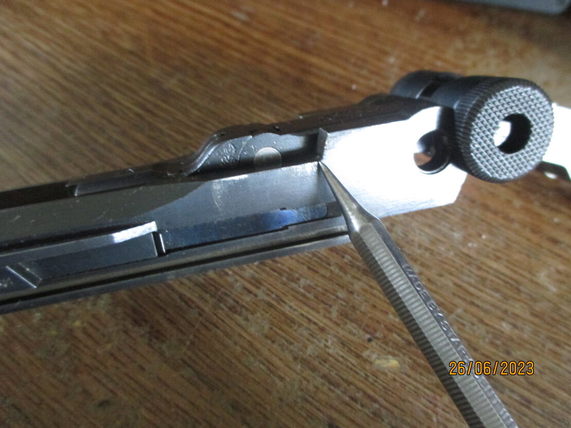

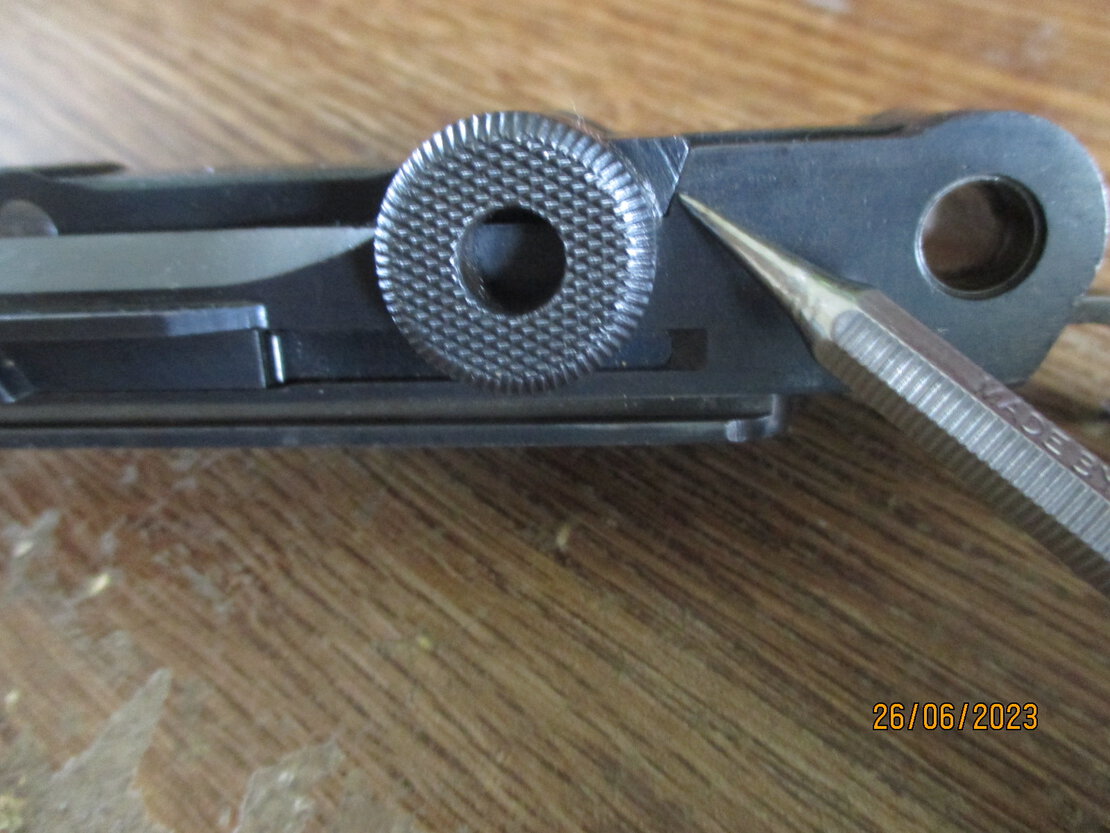

These are the areas that receive the stress of the pressure from firing. The sharp corners are susceptible to cracking from excess stress or fatigue. The inclined area is the actual locking surface that takes the pressure of firing. The Toggle knobs don't really do anything until the pressures have dropped and the upper receiver has travelled to the rear to start the unlocking sequence by the knobs striking the frame ears and forcing them upward to "break" the toggle joint.
https://forum.lugerforum.com/attachm...1&d=1687820755
The following 6 members says Thank You to gunbugs for your post:

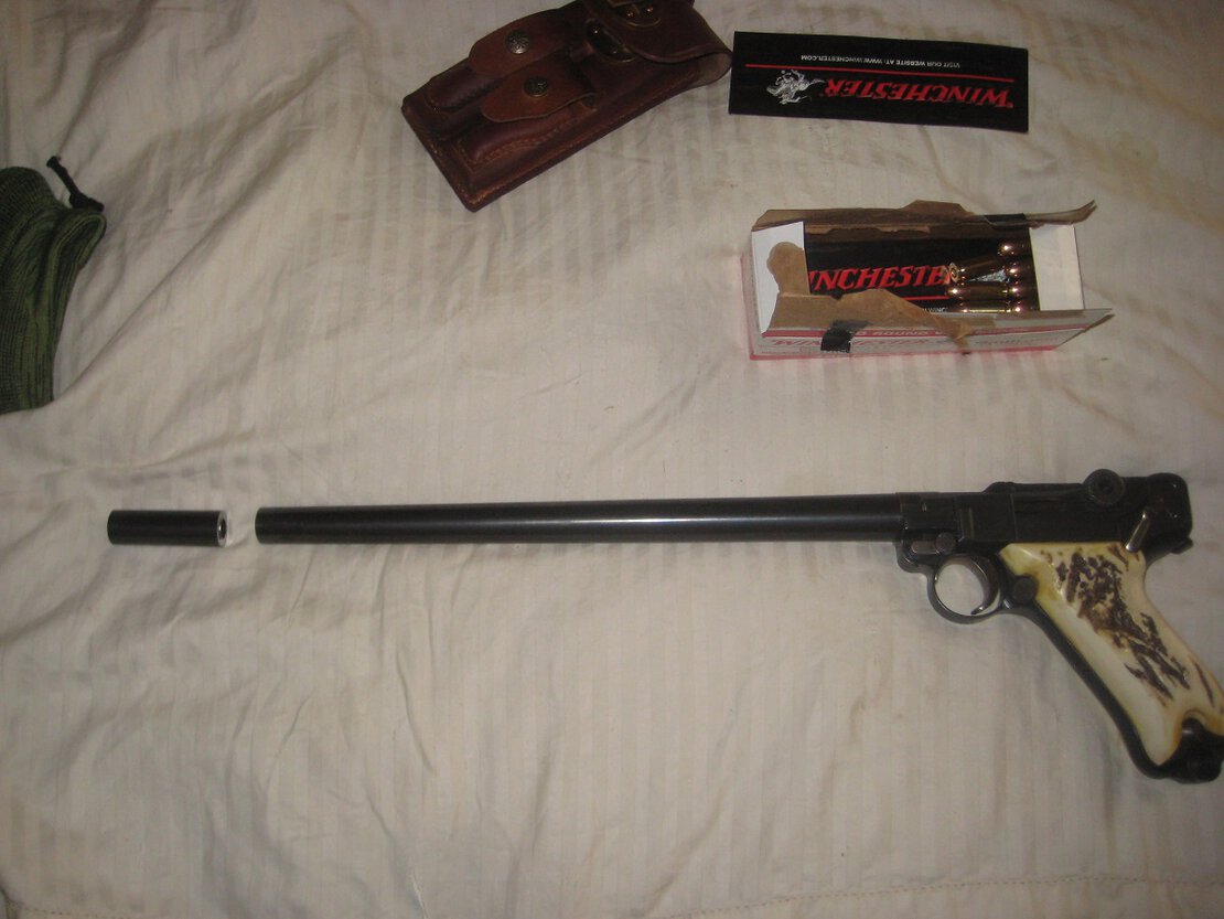

A good day. I had the barrel cut down to 12ish from the breech, re crowned. Well, I didn't expect much but boy howdy.
She runs now as fast as I can pull with 115 gn Win White Box.
Now I have to decide what I want to do sight wise...Navy rear? Original from ramp would be nice.
Ideally I'd get the barrel turned to reduce the profile but we'll see.

what was removed...will make a nice pen holder.
