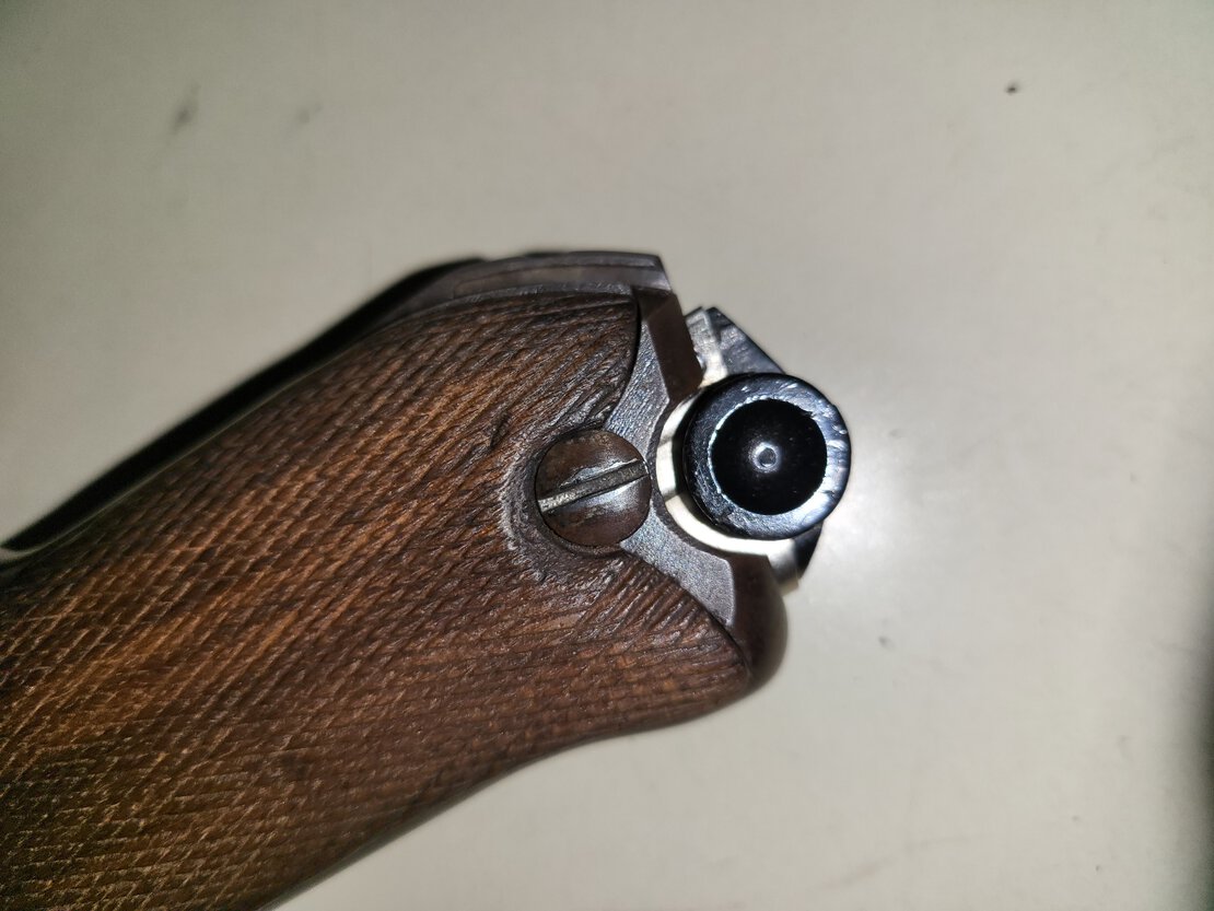

Also is this gap normal for a magazine?

In my experiences, yes there is sometimes a gap between the button/tabs and the frame. As Long as the Magazine catch engages and it doesn’t fall out, no issue.

As noted above, the mag catch does half the job of holding the mag in correct position when it's clicked into place. I can't tell the condition of the catch from the pic, so will again suggest checking it for wear. That a mag can be pushed up farther after it's clicked in is the main clue.
