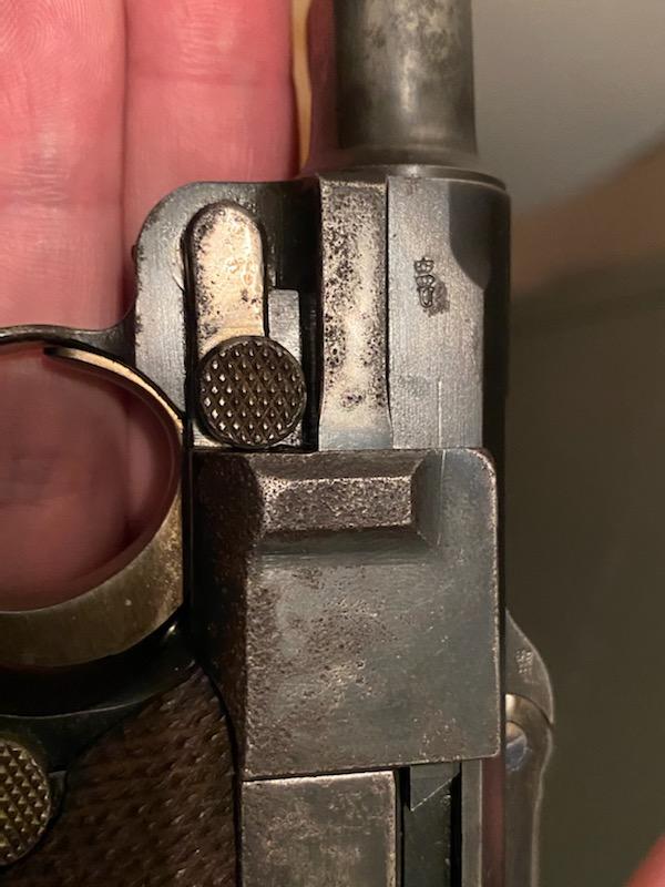

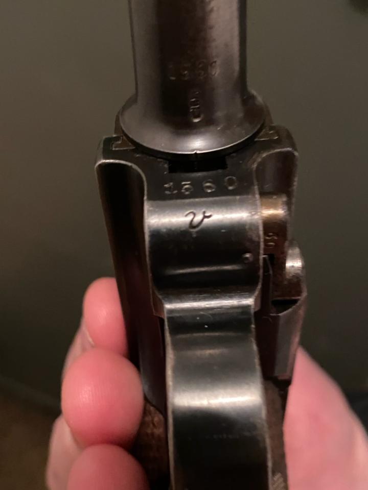

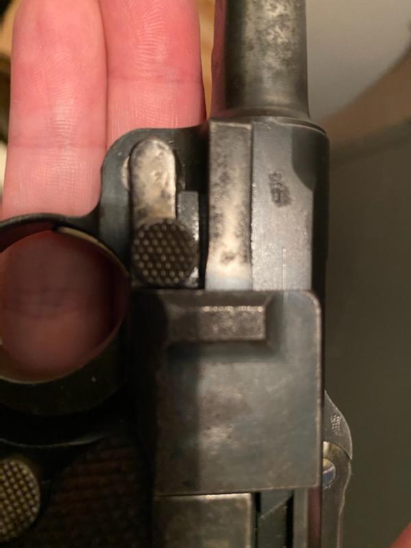

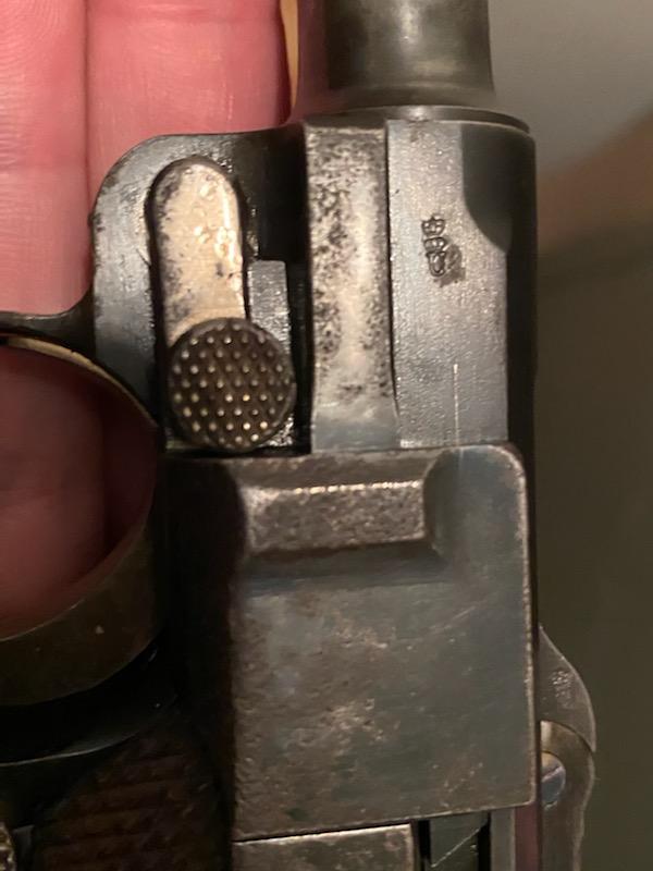

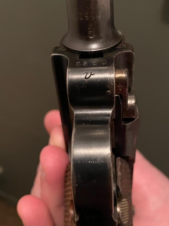

Here are a few close ups of the only acceptance marks on the pistol and the letter suffix.

So based on what I could find this is what I came up with.
Mauser Commercial produced 1034-1939. 1-5 digit serial numbers with the commercial proof on the left side of the pistol.
Does this seem correct?

Paul, yes...but on a marginal condition pistol..not that much. For a shooter, some yes. 9MM is cheaper than .30.
Unread 10-30-2020, 07:08 PM   #32
According to Costanzo in his "Proofmarks" book, this banner falls in the Swiss commerical range, but he shows them as 7.65mm with the 4&3/4" (120mm) long barrel with a grip safety. TH
If you have G&S red books, check pages 768 & 769. The first Oberndorf Swiss pistols in the 5xxv range began in 1931-1932. Then, at approximately 900v in 1933, and over the next 1,000 to approximately 1900v when the 1935 Portuguese GNR contract began, there was a mix of configurations including Swiss models, Stoeger AE Lugers and blank chamber 9mm Lugers with 100mm barrels which fits the OP's Luger. The .30 caliber Lugers within that range were made with both 98mm and 120mm barrels.

Based on what I can find and see this appears to be an early Mauser Swiss contract Luger? Made after the transition from DWM to Mauser? No number on the side plate and a proof mark on the toggle train.
The Swiss pattern Lugers had a grip safety, cross-in-shield and were made, if I'm reading G&S correctly, on a long frame. Your pistol isn't one of the Swiss contract guns. Read my post #34 above.

My mistake on the Swiss contract. Reading some Joops information he states that there was confusion at Mauser during the first 1600 V series.
