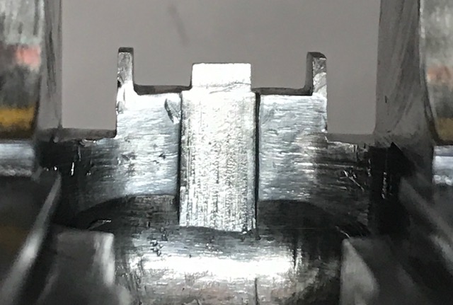

The gun does seem to recoil harder than my standerd P08.
I would like to at least try to use a mainspring with a larger wire diameter
I understand that the gun could most likely be used as it.
If it can’t get it perfect I can live with it as is but I would feel wrong not trying to further correct the breech impact.
Does anyone know where I could order a couple of new springs with larger than standard wire diameter?
Also does anyone know what the Wolff spring wire diameter is?
Maybe I should just take up GT on his offer, I just need to figure out the Wolff wire diameter to find my starting point.

Bill, I did not know that was an option thanks for the suggestion.
I will let Art take a crack at it if he is willing. If he would rather not mess with it I will be reaching out to GT.
I just want someone more qualified than myself to see it in person before I shoot it again.
In the meantime I am not overly opposed to installing a thicker mainspring if one could be sourced.
The real issue is I don’t have the tools to measure my existing one.

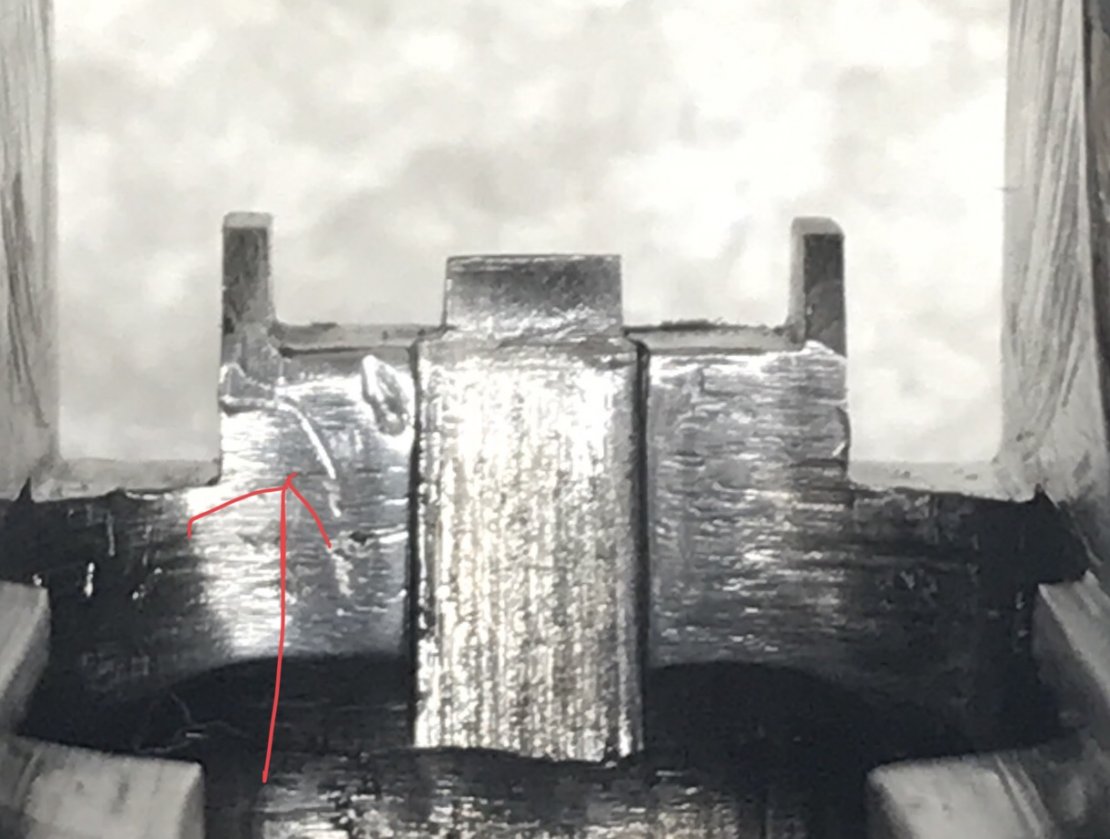

Don and GT,
Point taken, everything seems to be in order. Thanks to all for the advice.
I was just concerned because I didn't want to damage such a beautiful pistol (or rather a work of art).
I still can’t get over the craftsmanship that went into making it... mind-blowing!
I have been doing more research on the marks I've noticed on the frame. It looks like I was wrong when referring to the marks as 'Damage".
On almost every frame I was able to view I noticed some sort of mark like the one on my pistol, I think this is pretty normal.
Many were MUCH deeper than mine. At this time I am convinced I don't have anything to worry about shooting this pistol as is.
