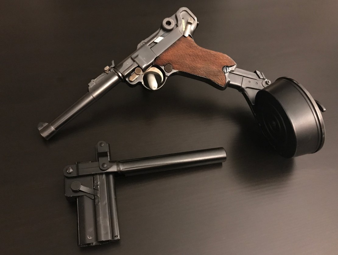

Thanks GT!!!

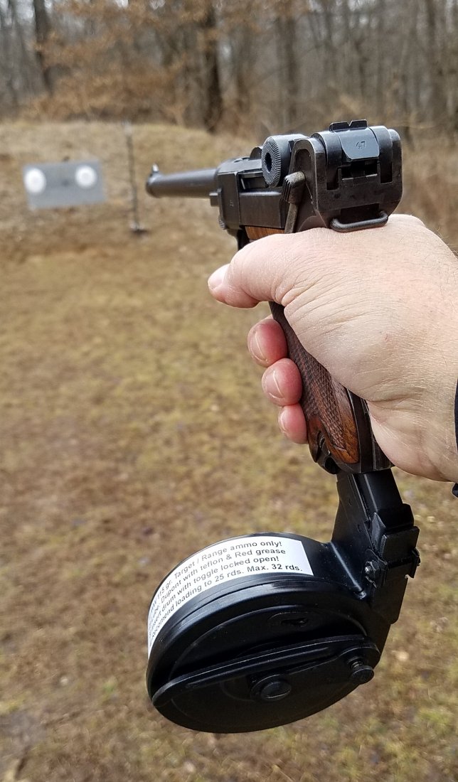

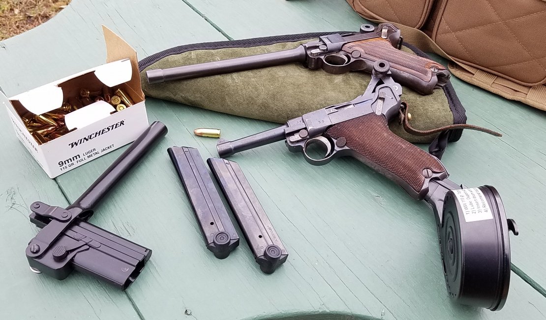

I headed to the range today with my two shooters and my new snail drum. What a blast! I did experience some difficulty inserting the S.D. (w/20 rds) with the spring unlocked, and getting the S.D. to lock in the mag well. I had to lightly pound the S.D. while holding the grips until I could hear the mag disconnect go click. So a little more fiddling is necessary. But, it was cold outside and I ran out of time. She'll be right with a little more love and attention. I'll provide an update later. Boy, this S.D. is fun!

Hey Eugene! Did you have the toggle locked open?? Can't insert the drum with any rounds in it at all without doing that?.... ... Let me know how you turn out, here to help! best to all, til...lat'r.....GT
G.T., with the toggle locked back, I could easily insert the loaded S.D. (with the spring unlocked) and the mag release clicked just fine. However, with that scenario, I had difficulty unlocking the toggle, to chamber a round and return to battery. This was the case with both pistols. Was I doing something wrong, or do I need to adjust something? So I changed my approach as I mentioned in my previous post. With that approach, I was able to get everything to work and fire until I emptied the drum.

Hi Eugene! It is pretty much a necessary operation to hit the toggle with your hand to close it on the first round... Just pulling it back and releasing it will not do the deed??? .... If you think about it... even normal mags loaded with 8 rounds sometimes need a tap to close.... Let me know as you become more familiar with the drums operation... they will all have their own kinks and it's going to take some effort to get them running 100%... In the next few weeks, I will try to post a trouble shooting flow chart.... God knows I've seen just about every problem they can have???. ... Best to you, til...lat'r.....GT....

Eugen, I have that issue unless I pull down on the Drum after it locks in. Lock toggle open, insert Drum until it locks in place, pull down on Drum, close toggle as normal (no push needed). Works that way for me. Maybe I'm just lucky.

Hoot has it right: "Eugen, I have that issue unless I pull down on the Drum after it locks in. Lock toggle open, insert Drum until it locks in place, pull down on Drum, close toggle as normal (no push needed). Works that way for me. Maybe I'm just lucky."
I too found that my toggle would not release as it was hitting the top/rear edge of the drum, so I had to tug down so it was down against the mag. release in order to let the toggle go forward. No biggie, just part of the fun.
DJU, Hoot, thanks for that tip. That procedure worked on one of my shooters (an excellent performing 1918 Erfurt Berlin Police academy rearsenal), but not on my other shooter (an 8" barreled Mauser K mix master) that has a much tighter mag well, at least concerning the fitment of the S.D.
But, as I mentioned in a previous post, I discovered/learned from posts in this thread that simply lightly bumping the bottom of the loaded (with 15 rds of snap caps) the S.D. securely fits and the mag catch clicks closed ...on a closed toggle in battery Luger . I then am able to rack the toggle and load a round into the chamber.
