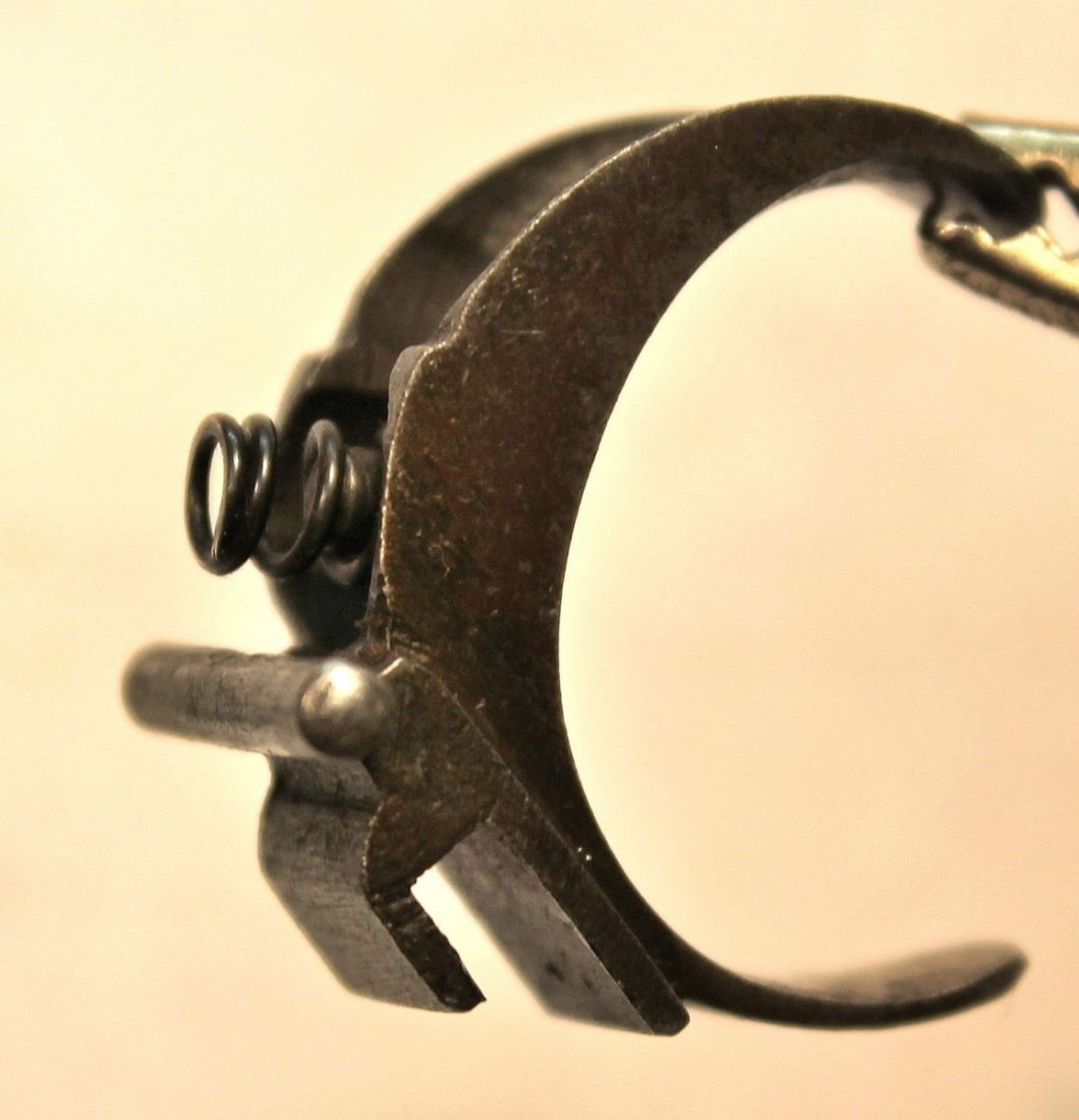

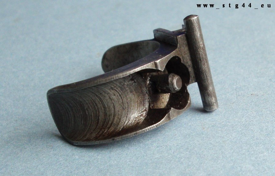

Originally Posted by r010159 View Post
Great! Now the trigger popped off with now a spring on the table. I looked at the exploded diagram on the technical part of this site and found no spring there. However, I would think that the trigger needs a spring.
It is all in the white inside of the frame and apparently inside of the slide. There is some rust part of way down the "chamber" that the magazine inserts into. Is it possible to reblue the pistol in selective areas? I heard of some bluing technique that way, but not only does it eventually rub off, it also has a peculiar smell to it.
The coil spring is placed in a housing on the backside of the trigger and rests against the frame behind the trigger. It's a bit tricky to put back into place, but not really difficult.
