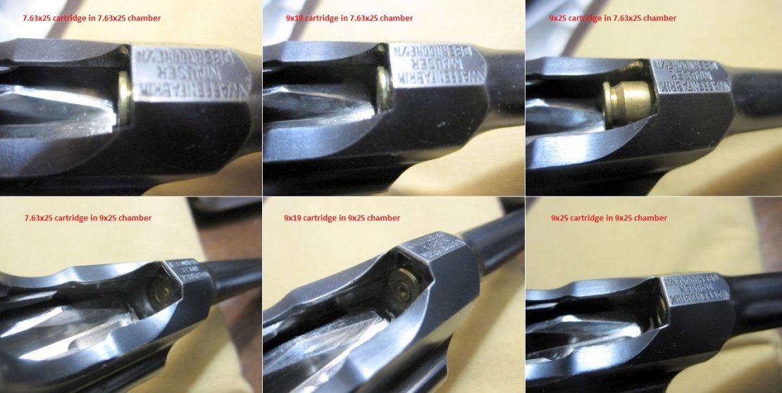

I tried inserting 7.63x25, 9x19, and 9x25 cartridge into a 7.63mm pistol, also tried inserting these three type of cartridge into a 9x25mm pistol.
The only combination that definitely won't fire is 9x25 cartridge in 7.63mm pistol because the bolt cannot close. All others.. even with wrong cartridge, they will load and fire (firing wrong cartridge will damage the gun after a few rounds -- don't try it on collectible).

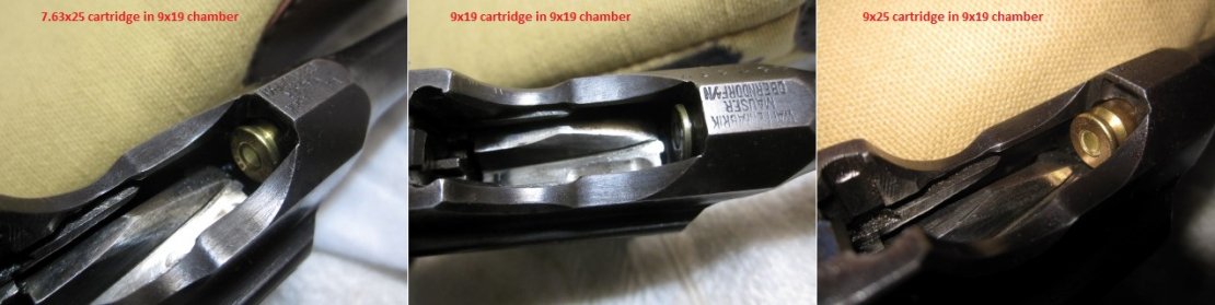

For completeness, also tried inserting 7.63x25, 9x19 and 9x25 cartridge into a "Red 9" pistol. Obviously, 7.63x25 and 9x19 cartridge can be loaded and fired from it. 9x25 cartridge won't load and fire, the bolt cannot close with cartridge case protruding out so much. That would explain why there was no need to add a "9" on grip panels when 9x25mm pistol appeared in prewar era -- 9x25 cartridge won't load into 7.63mm nor 9mm pistol.
7.63mm and 9x19 cartridge could be loaded into 9x25 pistol, but it's OK to fire a relatively weaker 9x19 cartridge from a 9x25 pistol. And, how about firing 7.63mm cartridge from a 9x25mm pistol?? the feeling must like firing a pistol with "shoot-out" bore... we have experience on target impact keyholes, but the chamber pressure is OK.
The worst combination is firing 9x19mm cartridge from a 7.63mm pistol. Chamber pressure is super high. So, a big Red "9" on panels could help.

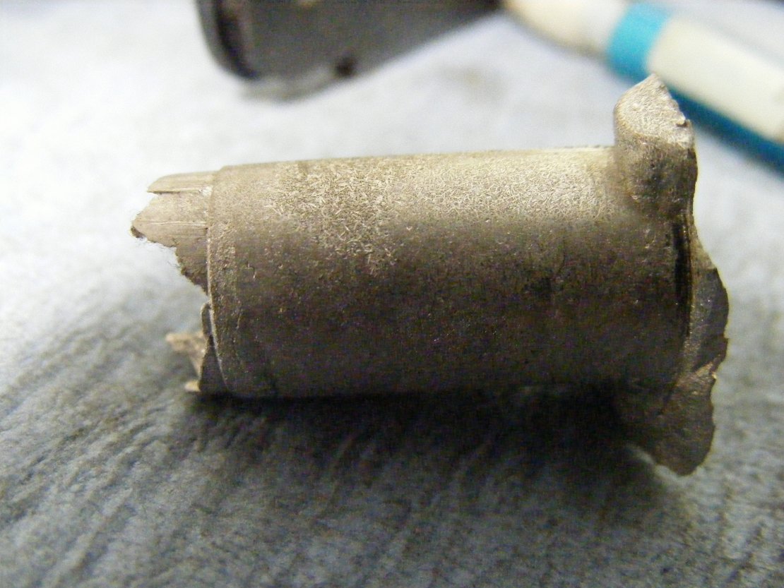

In the interest of science, I did a chamber cast of my Type 17. The face of the bolt is recessed .048"; the chamber from where the bolt would rest (see dark line) to the mouth of the cartridge is .860 for a total of .908". The diameter of the chamber immediately forward of the extractor cut is .482" and at the mouth .474-.475".
My Speer #9 manual shows the 45acp cartridge length as .898; the diameter at the mouth of .473" and at the web of .476". So on my gun at least, the chamber is reasonable for a military weapon. I've seen others that would swallow a No-Go gauge and still have a 1/16th inch gap between the bolt and cartridge head.
I put a C96 Wolff spring kit, a new extractor, and a modern, heat treated bolt stop on my Type 17. For the 20 or so rounds I fire per year, the gun seems to be holding up just fine.

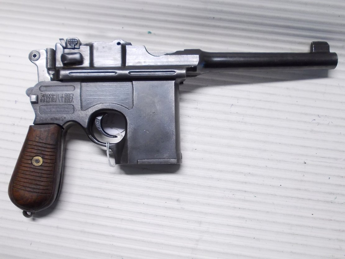

The one below belonged to a gunshop and has just been sold, but the picture still appears on the gunshop site, I've noticed that the grip screw head is on the wrong side, does it means that is a 1980 copy?
Sergio

Sergio, that one looks a lot like mine. Rust blued finish in fairly decent condition, deep pitting under the grip panels, and a nice, frosty bore. The internal parts are well finished. In tiny print, its stamped: "N. A. Co., Ridgewood NJ" (2 lines) on the front grip strap and "Cal. 45 ACP" on the rear grip strap. Probably a 'Navy Arms Special', if all the production went into service and none were stored in an armory, as you say Alvin. The poor condition of the regular C96s I've seen that are reportedly from China, certainly supports your thinking.
Of the 11 Shanxi I've seen, all had serial numbers under 2000. That always struck me as odd.
I've seen an article that asserts there is a difference in the Chinese stampings. I'll see if I can find it.
