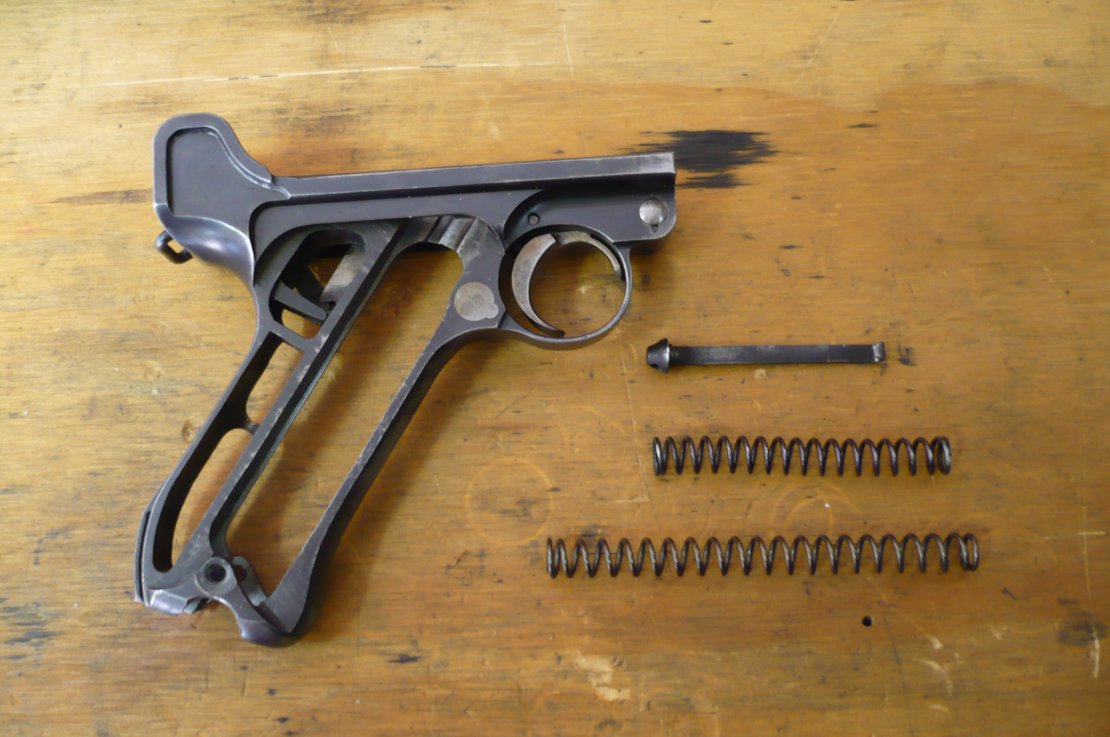

Default Firing 9mm upper on .30 Luger lower
OK, I took your advice and ordered the P08 recoil spring from Numrich. Clearly, there is a difference between the two springs. The upper spring is the original .30 Luger spring. The lower spring is the replacement spring that Numrich sent, ostensibly for firing 9mm. I just don't see how I'm going to compress that longer spring enough to engage the spring guide hook over the recoil lever. I had a hard enough time reinstalling the original shorter spring. Is there something wrong with this picture? Maybe this wasn't meant to be? I assumed the lower frames for P08's were identical between .30 Luger commercial models and 9mm models. Maybe this isn't the case?

There is a difference between a recoil spring and a main spring. To replace a flat main spring you need some modification, I believe.

http://www.gunpartscorp.com/Manufact...093.htm?page=3
So I should replace part #50 to fire 9MM? Why the difference in length between the 2 recoil springs?

No, CAP Black Jack must be confused by your question because he is incorrect this time, and that doesn't happen often... the flat spring (50) is from the early model Luger pistols... the round spring (31) is the correct spring for your P.08
Getting it in the pistol can be a real challenge. Here is a photo tutorial that THOR posted many years ago... it will serve you well.
http://www.lugerforum.com/Mainspring_Install.html
The difference in length is simply because your original spring is suffering from metal fatigue...
Welcome to the lugerforum.

Thanks, John. Good information! Does this mean I will be able to fire .30 Luger AND 9mm Parabellum by merely switching uppers and using the SAME spring?

If you have two different upper assemblies fitted to your frame, you should be able to shoot both calibers... the problem is that if the spring tension is adequate for 9mm, then the .30 caliber loads may not be strong enough for reliable functioning... If you handload, you can custom build your loads to suit the gun...

It worked! Off to the range with my "hybrid Luger!" I'll see what kind of loads I can work up in .30 Luger if there are cycling problems. As an added benefit, I notice that the trigger pull is a lot sweeter now with the new spring. Before, I often had to squeeze real hard sometimes to get off a shot.

Good luck with your new springs. You can lock your toggle back and leave it that way for 24-48 hours and allow the mainspring to "take a set".
In my 1921 DWM Luger, I installed the 9mm mainspring, and then load some 30 Luger rounds to factory spec. and they function well with the 9mm spring. That way I can switch back and forth with my complete upper, including toggle train, in 9mm. I hope that things work out well for you also.
