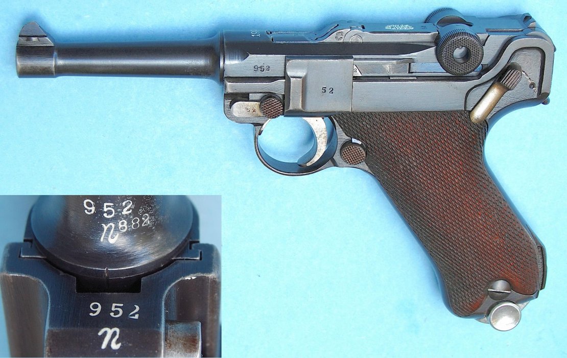

Unread 10-04-2013, 09:47 AM   #23
abzug
Join Date: Sep 2009
Location: Texas, USA
Posts: 13
Thanks: 25
Thanked 7 Times in 4 Posts
Jes, here is another DWM 1920 "n" suffix police marked P.08 for your study:
Sn. 952n
grip strap property mark- S. Kg. 2(Xed). 96(Xed). 948. (Schutzpolizei Königsberg)
No sear safety or magazine safety installed
E/ArA4 inspection and proof stamps
fluted firing pin
The chamber appears to have been carefully ground, presumably to remove the existing date, and to facilitate stamping the 1920 date.

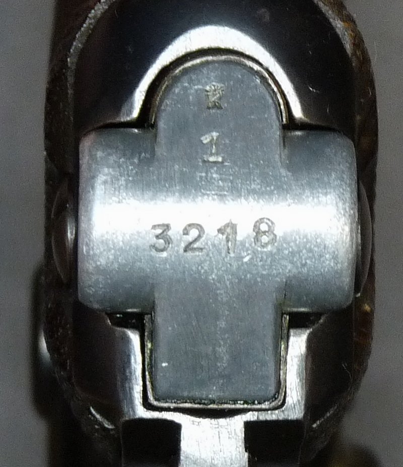

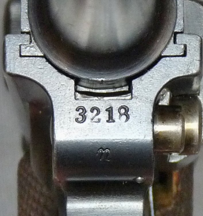

Unread 05-23-2017, 07:47 PM   #26
Question
Let's resurrect another old thread with a new pistol in the "n" suffix series # 3218n;
but not with a 1920 date, but 1921 AND a 1920 property stamp.
This curious series and this seemingly out of sequence number continue to be an enigma.
I'm not sure this one will help elucidate and will perhaps only add to the confusion.
I "wanted" it as it was highly unusual to me to see a 1921 date with 1920 PS; only later I noticed it is an "n" suffix.
Obviously a police pistol, still with sear safety, had a mag safety which was removed and the slot welded and refinished. Pistol is matching except grips, and has #1/3218 magazine with */k inspection.

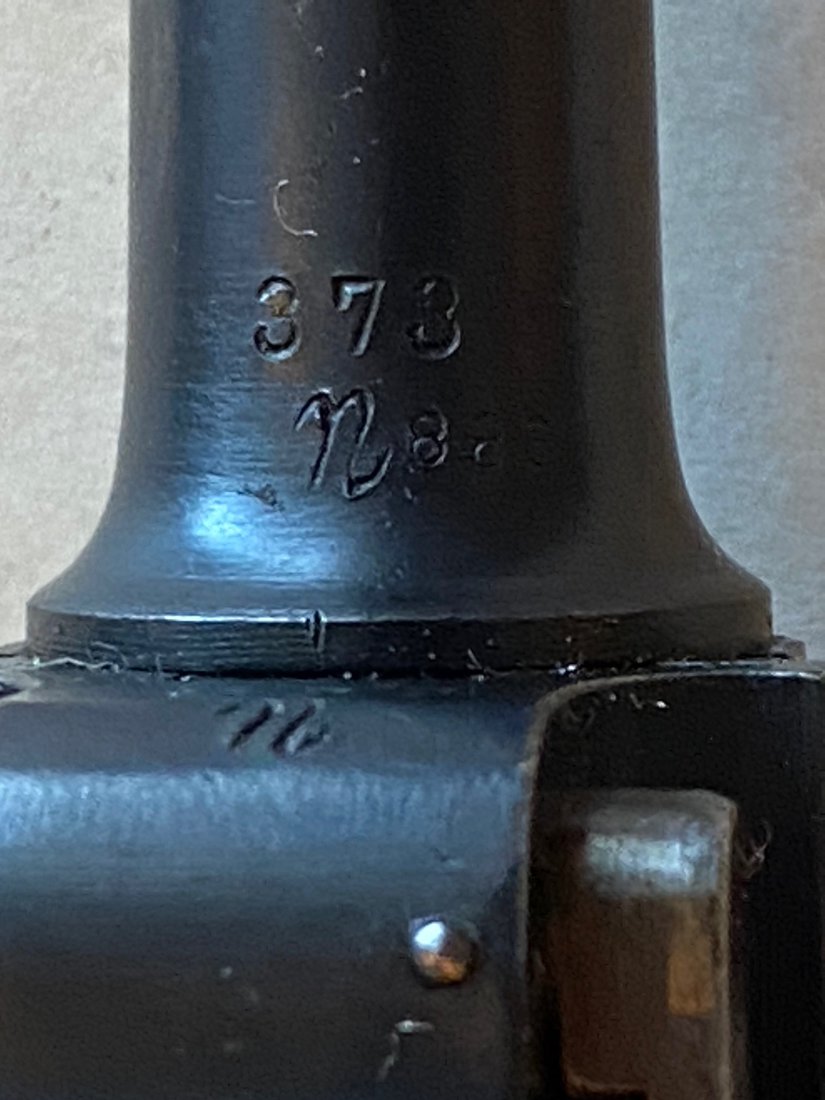

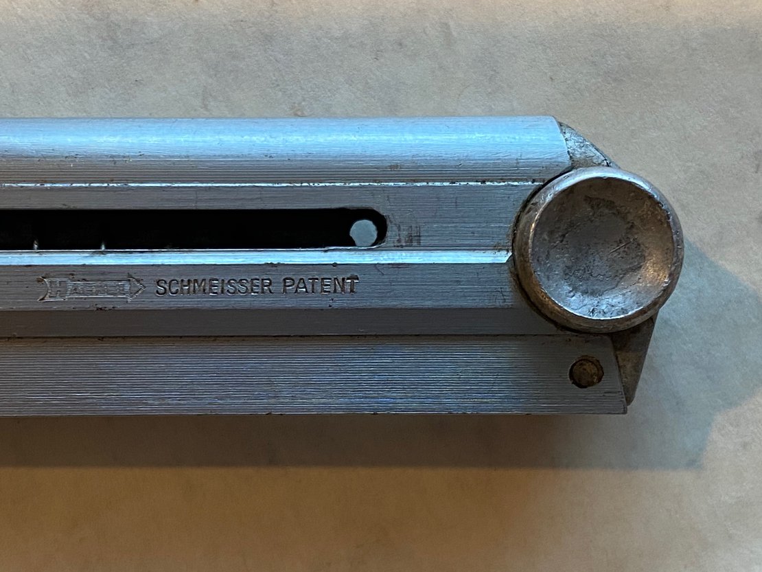

Unread 02-16-2020, 11:00 PM   #34
gunnertwo
gunnertwo's Avatar
Join Date: Jan 2010
Location: Nampa, Idaho
Posts: 627
Thanks: 843
Thanked 941 Times in 367 Posts

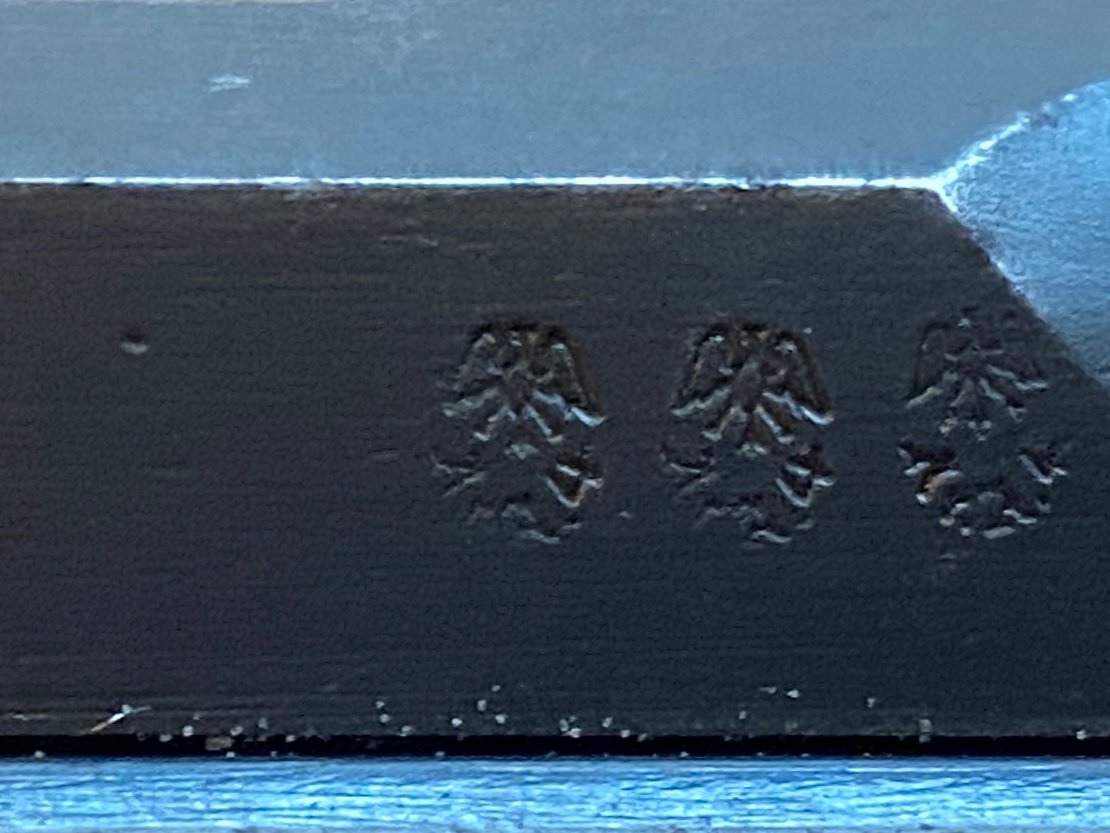

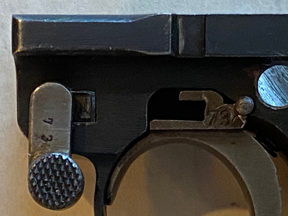

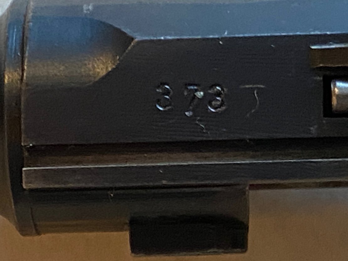

Late to the party, found this thread a few days ago.
Here's mine;

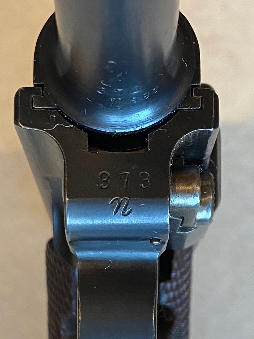

SN "373 n"
1920 on chamber (lightly stamped)
Sear safety present / mag safety removed
Three "Dove" stamps on right receiver
Front strap marked "S. B. 11667."
Came with a Haenel / Schmeisser mag, un-numbered with a police eagle stamp on bottom.
Unread 02-21-2020, 02:51 AM   #35
gunnertwo
gunnertwo's Avatar
Join Date: Jan 2010
Posts: 627
Thanks: 843
Default Images of Police 373 n
Attached are some images of the pistol.
G2

Jes, have you developed any further conclusions about these guns?
Don
donmaus1@aol.com
Unread 02-21-2020, 05:36 PM   #37
Greg,
Judging by the numerals and the engraved-looking n on the barrel, I suggest it is a replacement. Is there a proof mark?
Unread 02-21-2020, 07:23 PM   #38
gunnertwo
gunnertwo's Avatar
Join Date: Jan 2010
Posts: 627
Thanks: 843
Dwight,
There is a proof on top of the barrel but it's very lightly stamped making it difficult to discern. I'll take another look and see it it will photograph.
G2

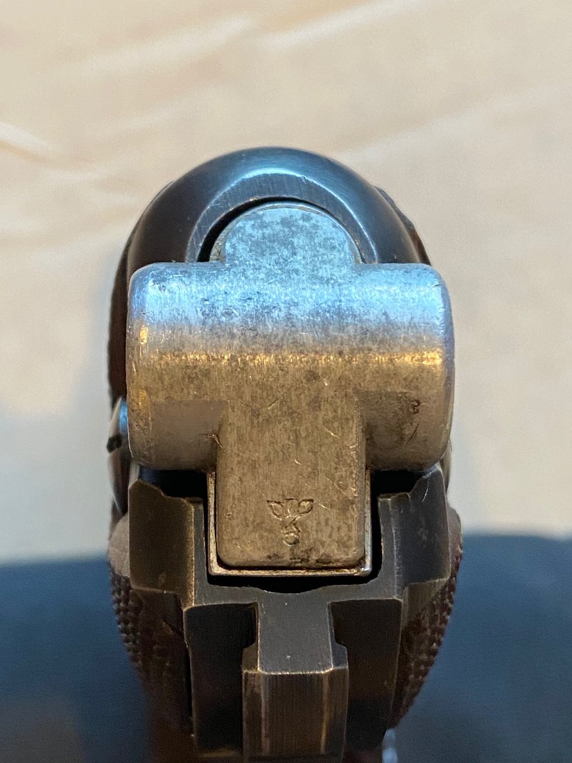

Unread 02-22-2020, 07:51 PM   #39
gunnertwo
gunnertwo's Avatar
Join Date: Jan 2010
Posts: 627
Thanks: 843

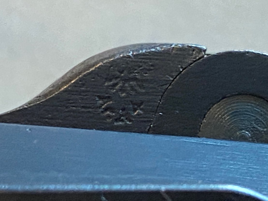

I must make a correction to my post regarding the explaination on the proofs on 373 n. They are not the "dove" as I stated but are the "Eagle AyA4" markings. Three are on the left side of the barrel extension and one is on the breechblock.
Attached is a pic of the barrel proof. Dwight, does this answer your question on a barrel replacement?
I used my new iPhone 11 Pro Max to take these pics. Except for the poor lighting I'm amazed at the detail one gets with this camera. Thanks.
G2

Unread 02-24-2020, 01:19 PM   #40
Don M
Don M's Avatar
Join Date: Aug 2004
Location: Houston, TX
Posts: 1,429
Thanks: 67
G2; The inspection stamps are actually ArA4 for Arüstungsamt 4. This office was later renamed Waffenamt 4.
Don
