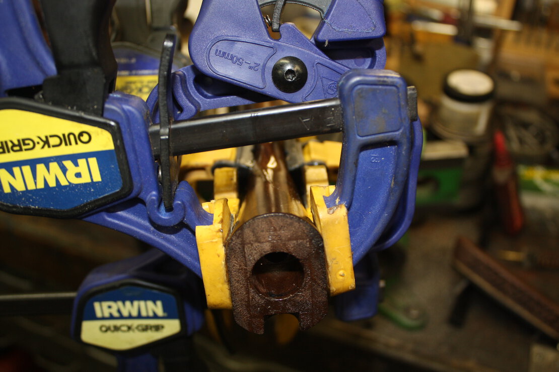

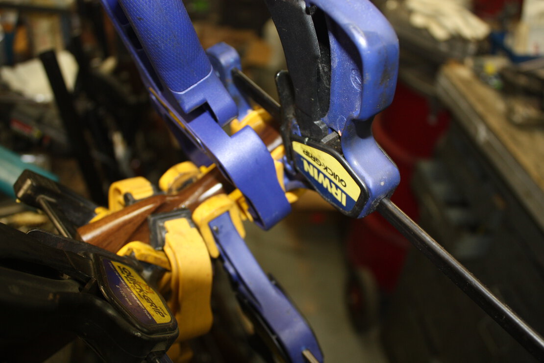

Here's one I was working on today. Buttstock from a Mossberg turkish import. About a 6" chunk broken out of the side of the grip. Brownells Acra-glas Epoxy, and several clamps. We'll se what it looks like tomorrow. I'm sure it'll need some cleanup.
