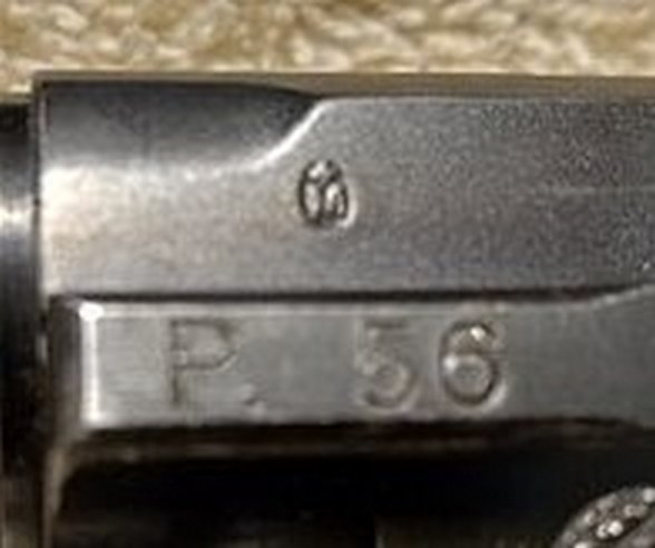

I bought my first Luger last week and very new to the world of Luger collecting. I now have the chance to purchase a Swiss Luger. I believe it is a W+F M1906 made in 1921. I have researched as much as possible. I would like opinions on the proof mark located above the p56 stamp. Also what does everyone think of this pistol overall and the originality. These are the best pics I have at the moment. I appreciate the knowledge.

Welcome to the forum. The Swiss P'00/'06 W+F manufactured Lugers are among the finest ever made. If it's matching and the bore is good - most are excellent - then I wouldn't hesitate if the price is right.
The mark you're asking about is an inspector's stamp. It is correct and in the proper position.

I believe the P36 stamp indicates a military weapon was sold in 1936 for civilian market Nice looking weapon.

That really is a nice Swiss Luger. If the price is reasonable and everything matches and there is no import mark I would get it. The Lugers in Swiss service were very well cared for and as already pointed out it was released into the civilian market on 1936. Good Luck

Thank you all for your time and information. I believe it is P56 instead of p36. Hard to tell from these pictures. I will hopefully be able to get my hands on it by the end of the week. If everything looks right hopefully I can make a deal.

I think your right it is a P56 not 36. You need to get more info before a fair estimate can be given. All the questions the previous members asked. I don't think it's a high dollar pistol but who knows now a days people ask outrageous prices for some of these pistols. Find out the asking price then post.

Yup I think it's P 56
I would gladly pay $1200.00 for this gun assuming it's all matching with a decent bore.

As far as one can see from the pictures, this Pistole 1900/06 (W+F) is basically ok, although somewhat used. Not original is the rear sight: it should be v-shaped and not u-shaped - but this is often seen on Swiss Lugers 1900 and 1900/06.
The condition is not unusually bad - there are many Swiss Lugers in such (or worse) condition - mostly only the very nice ones are shipped to the USA.
BTW: P59 means that the officer (or NCO) took over the weapon as private property after completing his military service in 1959.
