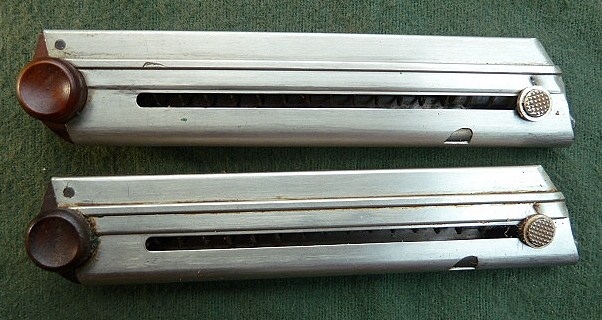

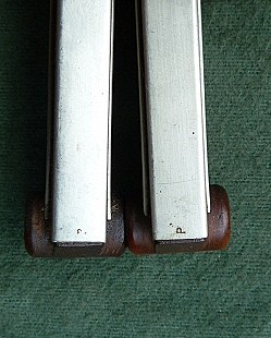

What about the magazine : erfurt body ?

I believe you are referring to what appears to be a less well polished body before plating. The magazine with my 1908 commercial appears also to be less well polished than some earlier magazines we see. But, that is not to say that my magazine is without a doubt original to my gun. I like to think that it is, but there is no guarantee.
But, why would you suggest Erfurt? Why not Swiss 06/24 Bern? Their lack of polishing is more pronounced.

Hi Gentlemen! The discussion about magazines caught my eye, and I may be able to shed some light on the subject? I have repaired many 100's of mags, maybe even into the 1000 mark.. and I have noticed that early DWM Nickel plated magazines, have a unique brushed appearance, under a white (not bright) nickel plating. Now I think this is where one needs to understand about the manufacturing process, and how it affects our collectors theories? Number one, the surface of the sheet metal, is exactly what you see on the finished magazine. The forming, stamping, and blanking dies are spotless and polished, and other then making the desired forms or cut, shows little signs of distortion or deformation, in other words rash!
So, if the sheet metal surface is smooth, the mag surface will be smooth as well, if it is brushed, the surface will be brushed on the mag, again, as well. They can specify any grade of surface finish they felt best suited their end result desires. The reason I outlined this process is because, they didn't polish magazines, they came off the assembly or manufacturing line, and were plated, or blued, or heat treated and then issued? No polishing, never, ever! And, the plating was never bright, (exception, early Mauser thru 1936 )
The finished were always meant to be dull or industrial, not for appearance so much as anti corrosion? I have seen the brushed finish on early DWM P.08's and primarily Navy models as well, and mostly pre WW1. As for most DWM mags, it would seem the vast majority would be smooth finished, and dull nickel, The 1900 commercials and into the 1920 commercials generally have/had magazines that were not plated at all! I also don't think you can go by the dimple stops alone to determine DWM or Erfurt mags as I think the suppliers sent product to who ever needed it at the time, in conjunction to what the dedicated manufactures could and did supply.. A better tell for Erfurt mags, are, greenish yellow color? The spring follower cap will be normal aluminum color, DWM dark gray, the follower button will be crude and flattened checkering and unplated on the Erfurt, and the finish will not be brushed! Now, please understand, again, it is all theory, I have not one fact to hang my hat on, but it is what i've seen, and until I hear or see different, i'll stick with what I know... best to all, til...lat'r...GT

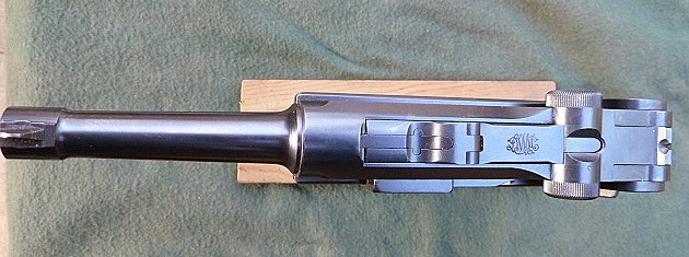

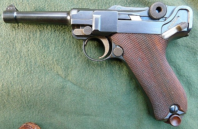

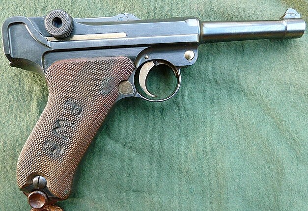

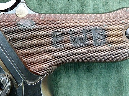

For comparison here are some photos of sn 59680 with two magazines which I bought on gunbroker about ten years ago.

Great looking gun George, the Einwohnerwehr Bayern grip markings are a big plus.
Norm

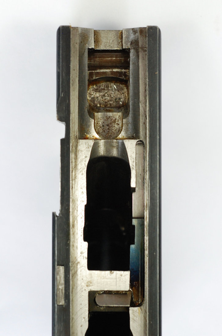

Lazy c/N instituted in 1912, sometime after about sn 53000; stock lug P08 instituted Aug. 1913 about sn 70150. So sn 56698 sometime early-mid 1912.

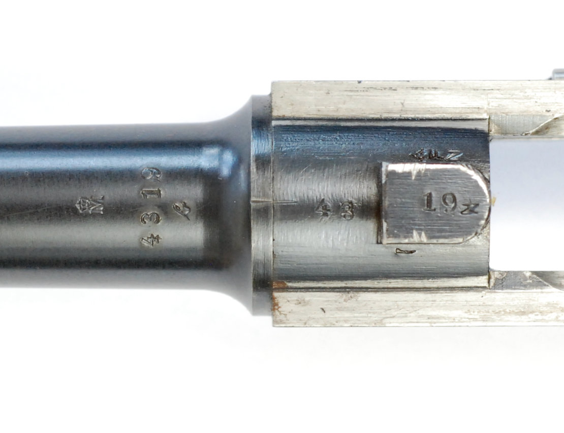

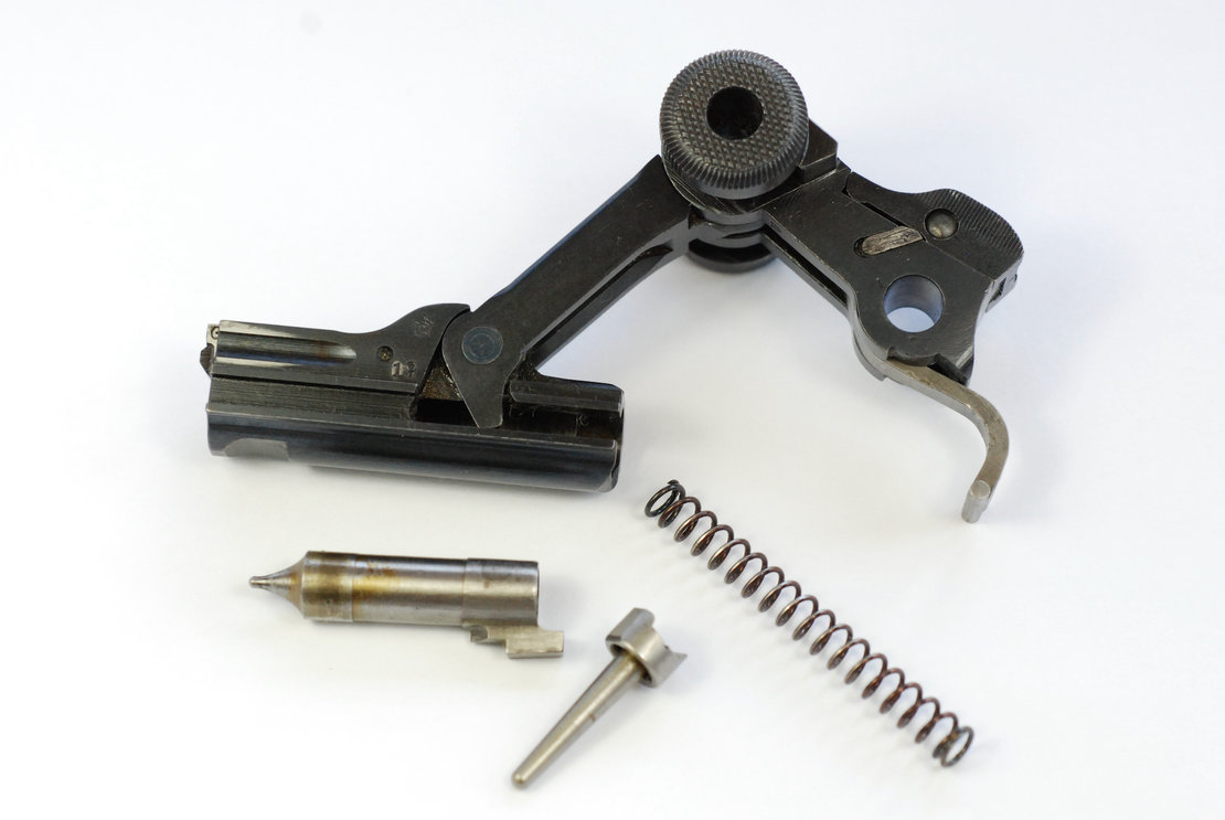

You will probably get many different answers to your question but here's something we can all agree on, CUT HANDLING TO A BARE MINIMUM. I've been a serious Luger collector for over 50 years and my routine is as follows:
1/ Each new addition to my collection is stripped down, inspected, cleaned and lubricated.
2/ During this process I take lots of detail photos, like those below.
3/ I reassemble the gun and wipe it down carefully with a silicon cloth and then place it in safe storage.
4/ If in future I need to re-examine the gun, for example if someone asks me if 1908 Navies have numbered hold-opens, I simple refer to my photo file.
5/ I re-inspect occasionally and wipe down with the silicon cloth.
This routine has served me well and I can honestly say that all my collectible guns are in as good shape as the day I bought them.
Norm
