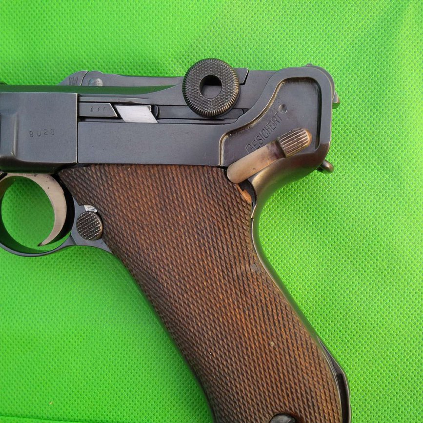

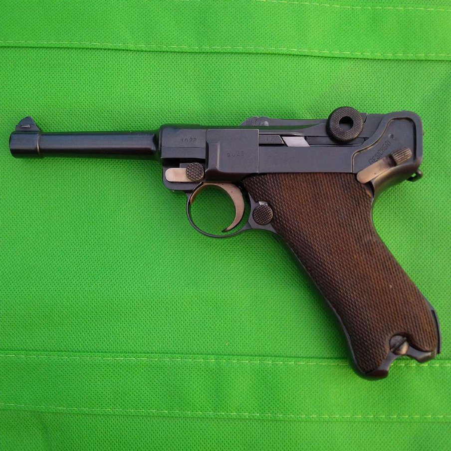

Well, first thing I would like to thank everybody on this forum that has answered my many questions and shown patience with a boatload of questions. I took it out last night and shot it for the first time. It went bang!!! Then did not extract the empty and the extractor was still sticking up. (I've been reading on what I need to look for on that and will keep you posted.) I did take some pictures of it and wanted to get everybody's thoughts. I hope to post better pictures this weekend with natural sunlight and in focus. Be brutally honest. This is my first attempt of refinishing a gun. I need new grips. Thanks again for all the help!!

The pistol itself looks pretty nice. Looking forward to seeing closer, more detailed pictures.
Hard to say why it didn't extract the case.

You are on the way with your rust blue.
A few more applications and you will get a darker, fuller deep blue.
I believe you polished the surfaces a little too much, but the "shine" may be from the light.
Well done for your "first"!

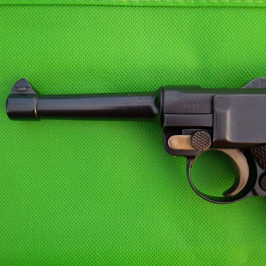

Here are a few new pictures and I have more to come. The ejector blade/tip looks fine. I will put up that photo also.

You've done a great job and your newest pictures are much better than the first ones you posted. The lime green background really pops the finish. Nice.
I hope you're able to solve your ejection problem. Have you checked the chamber for roughness?

That looks really nice. You did one heck of a good job on your first try. Wow.
