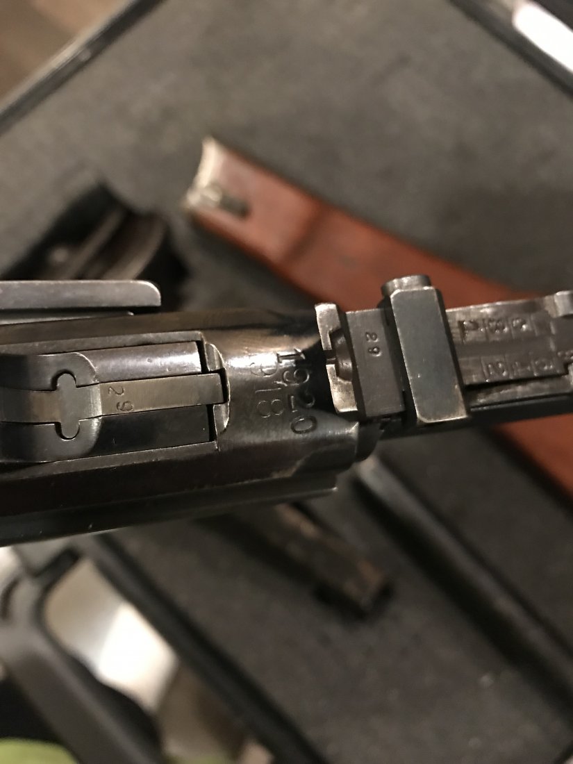

I just picked up an artillery luger dated 1918 and 1920 and have a question about the proof acceptance marks on the right side- my understanding is that there should be three crown over gothic letters and the DWM proof- mine has only one crown over gothic letter (either G or T) and the DWM reichsadler. AM I incorrect in thinking there should be three?

How about pictures of your markings, Top and sides of chamber, bottom of barrel.
Welcome to the board!
Unread 11-15-2018, 01:07 PM   #4
Also a photo of the date on the chamber would be helpful, as if the date is in the 1918/20 format, your pistol may be 1918 made parts not assembled until 1920. TH

I added a link to an image of the right side- I will take more pictures and get them uploaded.
