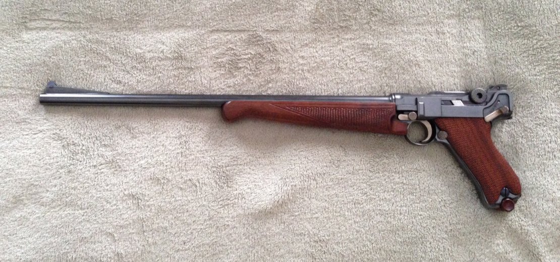

Here are several photos of my carbine crafted/assembled by the following “gang”.
Charles Danner : rust blue, straw, and fire blue.
Jim Solomon: from a single piece of wood, Macon Gun provided
a semi-inlet blank for the stock, Don fabricated the forearm, I
made the grips, did the design and checkering, along with
installing the attaching iron.
Gerald Tomek: cut the barrel and threads, index to BDC at the
correct torque of approx. 50 lbs.. and cut the taper.
Don Voigt: coordinated the project. He did the extractor cut,
finished the chamber and head space, front and Navy rear sight,
and fit the forearm to the bbl.
It was a fun project, and I felt privileged seeing the nice results of three craftsmen—Charles Danner, Gerald Tomek, and Don Voigt.

Jim Solomon

Don't forget Jim Solomon was part of the gang as well!!! No small task in checkering and finishing up the wood to where you see it now!... til...lat'r....GT....

I have long thought about building such myself, like to have the original barrel length on my rendition, but as we know, takes the paperwork, stamp. and $ over the rest of it. I could live with the 16+ incher with no problems.
A while back I made up a 16" plus barrel, tapered from an old 06 rifle barrel for an old Navy Luger receiver/frame etc. Tapering a barrel is not a lot of fun, but doable for the average reserver. Just a matter of watching the lathe run, doing the math, and keeping the specialized cutter........well, sharp; some attention to speed and feed come into play too.
The availability of a buttstock in semi inletted form is a great boon, at least to me. Checkering is out of my league; no eyes here. The fitment of the attaching iron(original or repro) is there just to be done, all takes time by hand if you want the hairline fit. I am sure you are no stranger to marking medium.
The forearm seems to be screwed on to the hanger. I would have to admit the cross wedge of the originals probably is a task in itself; both look nice to me, personal choice there.
The metal work is not too bad effort-wise, fabrication of the barrel, front sight, and hanger are tasks that will try you a little and take time. I always wondered on custom stuff how high to make the barrel's front sight, guess measuring from bore line is one way. I suspect there are more intelligent methods out there; which I am sure you already are massaging.
This particular rendition of a repro carbine is nicely done, the group should be rightly similing of how it turned out, nice job.
You, I am sure; have all the background and skills to do it yourself, just now where is the time I guess. Likewise, I am sure you are way ahead of me in technique/approaches, but wanted to comment how nice this rendition turned out. Mine has been put on the backbuner for about 15 years now, but .............someday I will blast off and do my own version...........in a 30 of course....

You are corrrect about the cross wedge. I believe it would take as much time if not more to make the pieces, slot the arm, and then get them to fit- than it took to do the forearm , arm hanger and the screw attachment combined.
I just would not undertake to make the forearm with a wedge. I didn't do it for mine, nor for Jim's.
As my Mother used to say : "too much sugar for a nickle".
Here are picts of my carbine, Jim did the stock checkering and finishing on it too. I used the screw in the forearm as mentioned above.
