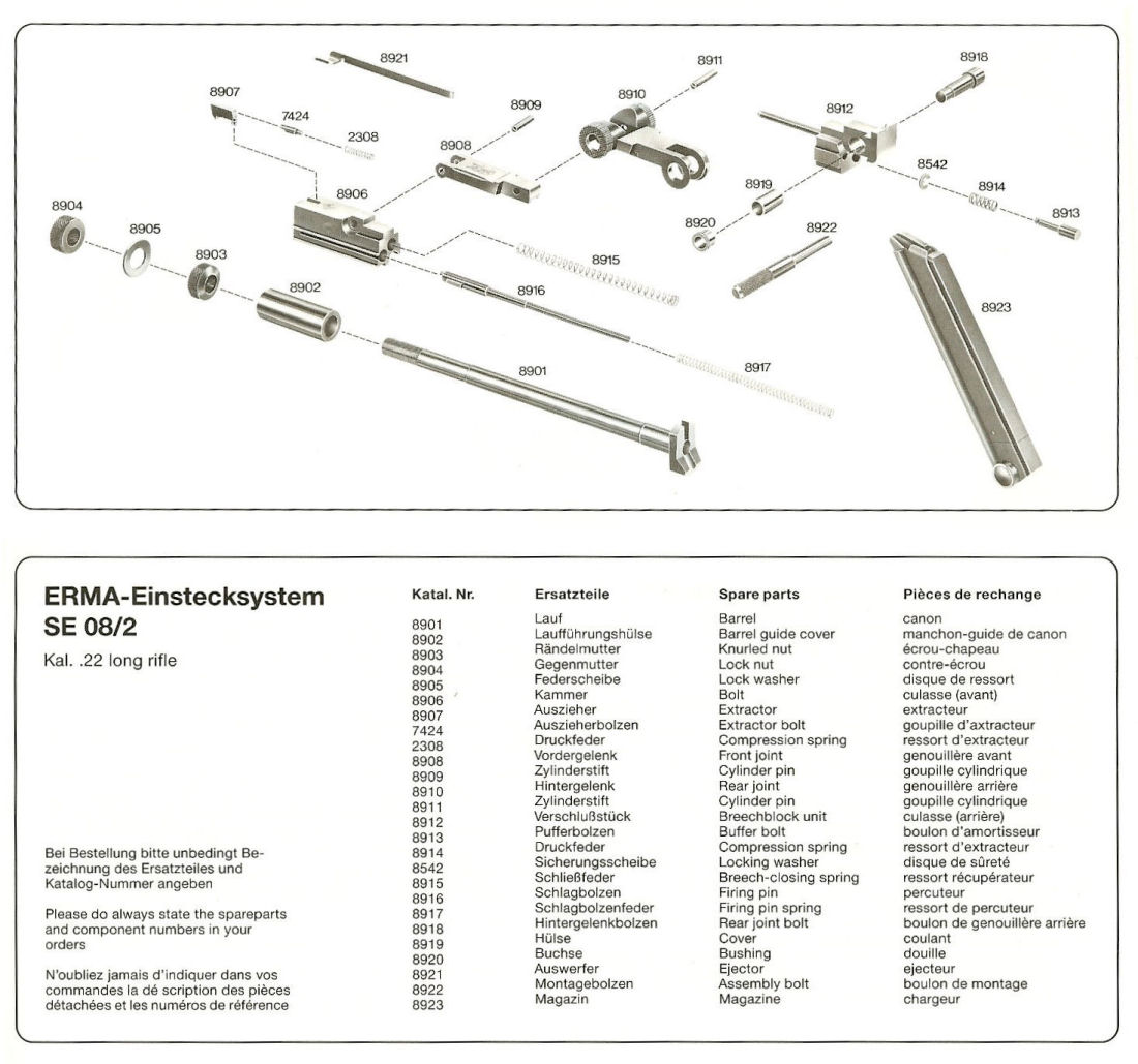

For posterity, here's the parts schematic...
And an "Instruction Manual" for what must be an early SE08/2...

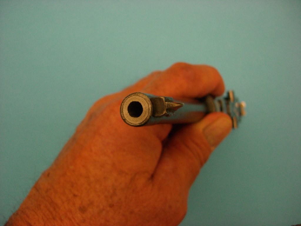

All of these neat posts about .22 conversions finally prodded me to rummage around in my unfinished projects box. Quite a number of years ago I acquired an American Eagle barrel/receiver in which someone had permanently installed a .22 conversion liner. As you can see from the photo, there wasn't a lot of original barrel remaining after it was bored out to accept the liner. I also found an interesting Erma .22 conversion toggle. It is the only one I have seen that has an adjustable rear sight. I have a couple of .22 conversion magazines but I have never put them all together on a frame to check it out. Maybe one of these days....

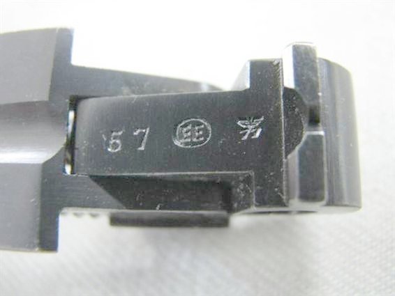

There's a "Nazi" Erma conversion unit on GB, it almost looks like an adjustable rear sight (but I guess it's not!)...Quite different from the kit I looked at...
