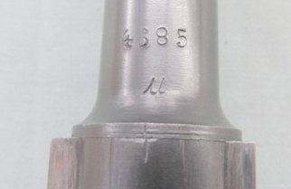

Hello. First post, first Luger.
I just bought this:
http://www.gunbroker.com/Auction/Vie...Item=492625595
sort of on impulse but I've always wanted a Luger and I liked the oddity of this one and got it at $950.
From my own quick research (I know zip about Lugers) and feedback from some Luger-guys on another forum (non-Luger) I guess this is a "Blank Toggle". Also a P08. I was told it was or became a police gun. There are some indications on the gun it may be a Simson and was a DWM or is a DWM and Simson had nothing to do with it. It's serial is
4685 u
The seller knows little about this gun. Think it's a store.
Anything you can tell me about this I'd greatly appreciate. (Also what your opinion is on price I paid).
Thanks!

Nice buy- I missed that one! Good buy, I would have bid on it- probably more.
You are correct, 1929 DWM P 08 with blank toggle and chamber; has police sear safety added, so yes it say police service.
Any markings on the grip straps?
Receiver markings are as "weak" as I have seen, and these "u" suffix pistols suffer badly from these indistinct inspection/proof markings on the right of the receiver.
Enjoy your pistol and welcome to the forum.

"The serial number is 4685 and it is on the frame and the barrel and in both places, there is a cursive "u" under the serial number".
I don't think I've ever seen a pic of a barrel serial having the suffix...and no land dimension...
Toggle axle pin has an odd wear pattern...
Good buy!

Quite a nice Luger, pity for those indistinct inspection/proof markings on the right of the receiver.

Thanks so much!
From the photos I can't tell about grip straps.
These are the two marks, faint one is receiver, heightened in photo-eiditor. The faint one looks like a Simson mark but someone on that other thread said Simsons didn't have serial numbers going up that high ("4685 u").

It is not a Simson receiver, but one made by DWM later BKIW and perhaps assembled by the , the "u" suffix is well known on police lugers in this range.
The faint, indistinct eagle is the same as the one on the barrel, and similar but different to the Simson eagle.
May have been made in 1927-29 and are referred to now as
1929 DWM formerly called "sneak" luger.
I have 3934u and 4506u, both with police sear safetys. Both have the "crappy" inspector markings on the right chamber!
land dimensions are numbers, like 8.82 stamped on the bottom of the barrel after proof firing and guaging the land diameter.
