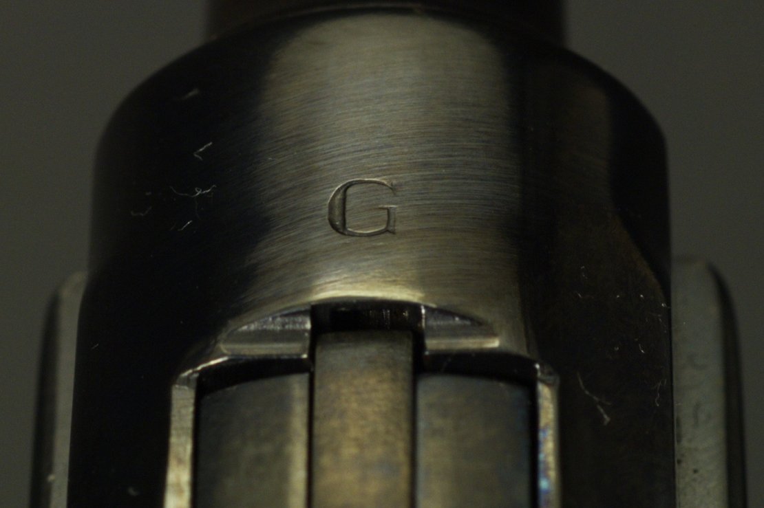

Default G Date Receiver Photo
Here is my refinished "G" date receiver... This picture shows the letter without any fillers.
And David's observation looks accurate to me. The front of the frame looks ground back, renumbered and refinished.
