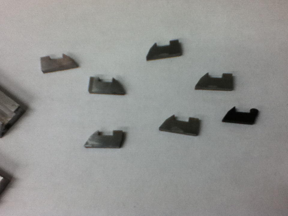

I had an old six inch barrel blank that was left over from my initial attempts some 30 years ago. I have pretty much viewed it as a mistake, kept to remind me how not to do something. But seeing your six inch 30 cal 'pencil' barrel and looking at my 'mistake', I decided to see if I could salvage it.
It didn't come out as well as yours (I suck at finishes), and it wasn't until I read the two pages here that I realized yours is in 30 cal...Mine is 9mm...
Oh, well...It looks better now than it did 30 years ago...
