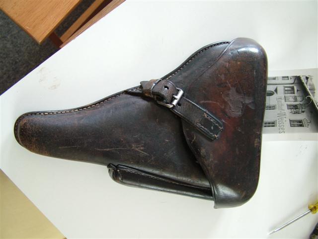

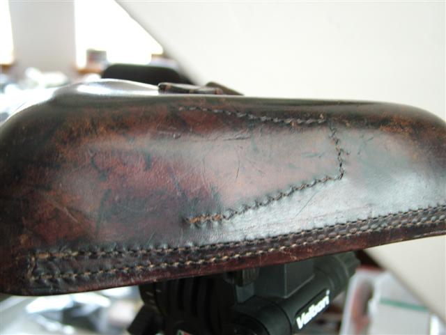

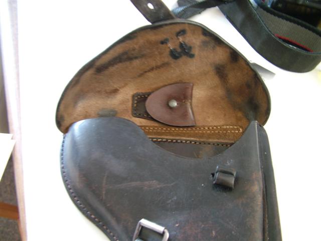

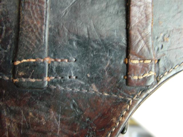

Here are a couple of photos of the holster that came with the gun.
Notice the scuff mark above the closing strap. I can't tell if this is rub damage from transport/packing or if someone tried to remove something. There was no tool with the holster. I'll get one for it. The strap that assists in removing the gun from the holster is complete, not damaged.
Also, I failed to mention in the description of the gun above that an '80' is stamped on the underneath side of the "take-down" lever.
Once again, I apologize for the poor photos. I'd like to blame the camera, but I imagine it's my inability to focus it properly. Probably something simple like the diopter being out of focus. Then, again, maybe it's just old wornout eyes.
