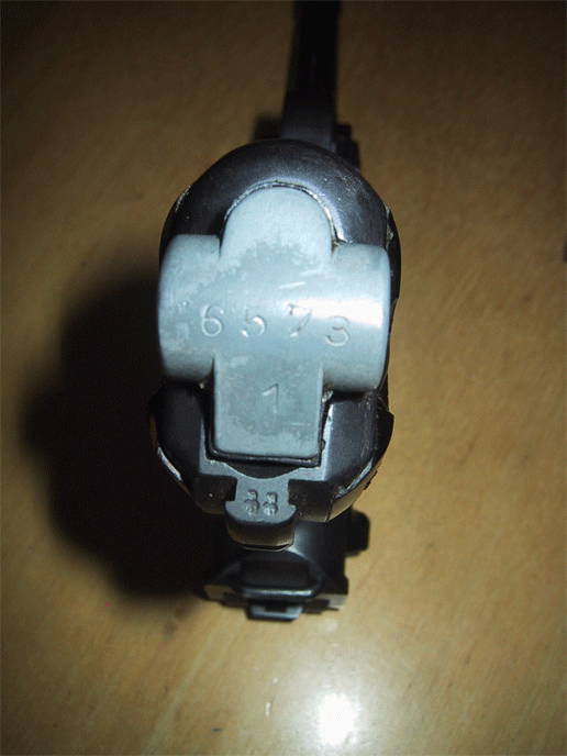

1. Look at the bottom of the stock lug; look as if you are putting in a magazine / clip into it, from underneath. There should be 2 stamps, perhaps eagle 6 eagle 6 or eagle 33 eagle 33

1. See 1st picture: is it the correct part of the gun you ask for ?
If so, it is eagle 6 (2 times)

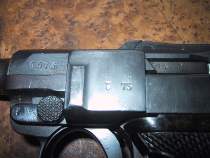

2. I confirme: the right side shows eagle 6 (3 times) and big proof eagle (I call it "Weimar eagle"...) See picture 2 (poor quality picture...sorry)
3. There are eagle 6 and the 2 last digits of matricule all around the gun
From what I've read, it looks like a full Simson ? is'nt it ?

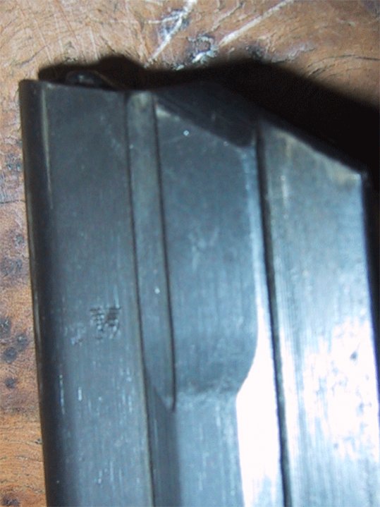

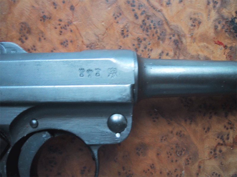

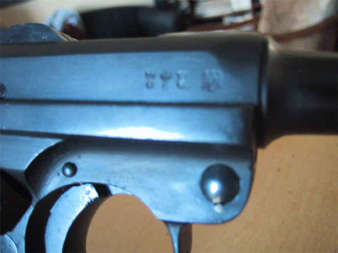

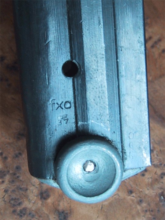

Hi Ed,
Some better pictures.
I've made a quick check: about 19 "Eagle 6" proofs in total
Some details on magazines: FXO + an other design of Eagle = "Eagle 37"
Does it change anything in your conclusions ?
Thanks
Nathalie

Outstanding. Yes, the simsonlugers@verizon.net is my website, hosted here by my friend John.
Your magazine is incorrect for this luger made by Simson and then this was refurbished / used by the east germans, thus the reblue and the 1 & 2 bases and the grips appear to be the bulleye type of east german grips.
Although I say incorrect, it is correct as east german replacements, but not correct per simson manufacturer.
