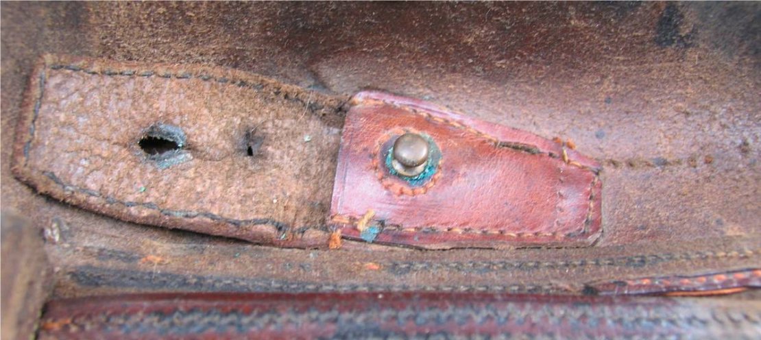

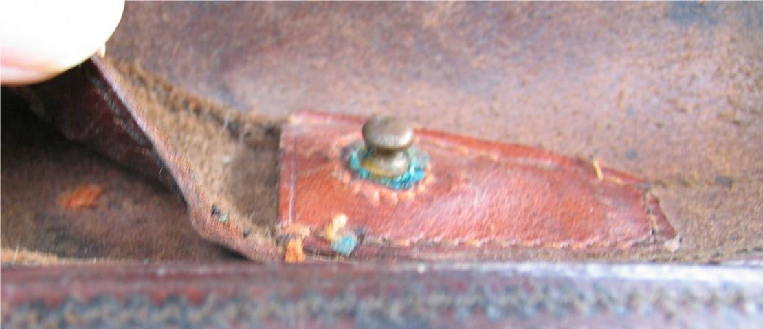

I have received the holster and have examined the tool pouch. I have included a couple of photos. It appears that the pouch was made from the two-piece mag holder in the original holster. The flap of the pouch looks like the studded piece in the photo of an unmodified holster. The leather from this part is about 2 mm thick and I cannot see any obvious indication that it is two pieces stitched together. The leather forming the front of the pouch may be slightly thinner but not by much.

Don, How very interesting! The stud on this pouch has a sewn circle around it too...I guess they were improvising but I can't figure why they would make it like that. It's a mystery.
