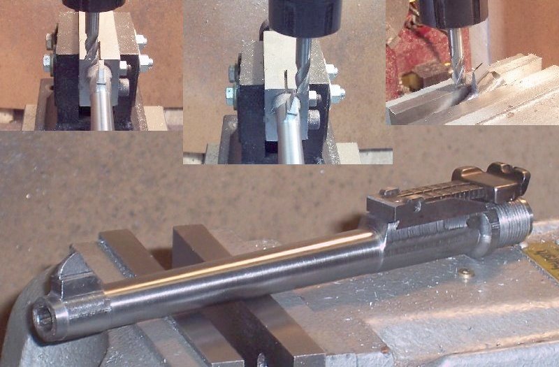

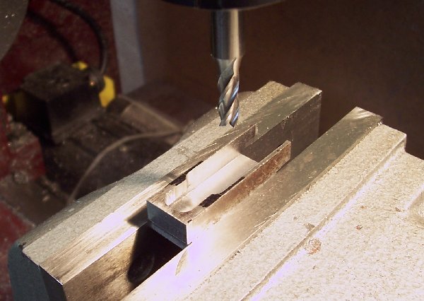

Got some work done on the rear sight base today...Cut the reverse dovetails; made sure it would be a tight fit; and hogged out the sight cavity...

...and cut the slot for the C96 Mauser rear sight axle with a keyway cutter...Fits real good!
Need to locate the axle pivot holes and then mill the "slope" for the slider...I was thinking of shortening the C96 sight, but I think I'll leave it as is...If I have to, I'll mill a crescent in the bottom of the leaf to fit snug over the receiver (instead of notching the receiver)...
Heh...A 1000 meter Luger sight...

Got the rear sight base fit today; also fit the C96 rear sight to it...
Not too bad...I think I can guarantee some fistfights at the next ESACA gun show...

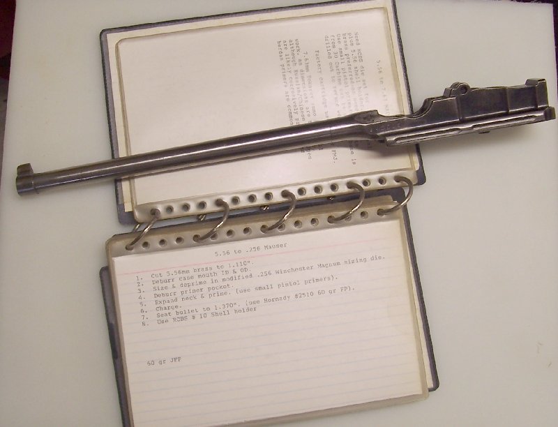

...I do enjoy Luger barrels from scratch too. I have shot my own renditions from 5" to 14" lengths, all in 30 caliber; 30 Luger and wildcats thereof...
I like doing wildcats...I have a Colt Gov't Model in 38/45 Clerke and a S&W N-frame in .357/44 magnum...and this Broomhandle, in .256 Winchester Magnum/7.63mm Mauser...I cut down a .223 Remington case and run it through a shortened .256 Win Mag die to make the cartridges...barrel blank, like most all of mine, is from Numrich, many years ago...

I have a set of B&D dies, but not executed a 27 conversion yet, maybe someday.
Mine is not the Bain & Davis; it's the .44 Mag brass run through a .357 Automag die. I used to have an Automag with both .357 and .44 Automag barrels; ran a couple shells through the .357 Automag dies and then had Clymer (back when the family still ran the business) grind me a reamer. Did a couple N-frame cylinders; worked out real well.
Always wondered how the Clerke would feed, hear about them from time to time, guess ok.
Not so good...It takes a lot of experimentation to get the ramp and mag right...I still don't have it right...
In the Luger realm, I seem to be given a few 30 and 303Brit caliber rifle take off barrels now and then, so hence the 30 caliber Luger attempts here...I finally got tired of losing all of the real 30 Luger brass($$$) at the indoor range, and worked with the 9mmx19 necked up to 30 caliber that was posted here some years ago by a forum member across the pond....
That's the 9 x 19 brass run through a .30 Luger die??? I might try that...I've been making my .30 Luger cartridges from .223 Remington brass cut down & run through the .30 Luger dies...I did the same thing with the 7.63mm Broomhandle...
Pic attached...Stripper clip of Rube Goldberg 7.63mm Broomhandle (made from .223 Rem); one of the 7.63mm Broomhandle/Rube Goldberg cartridges; one 38/45 Clerke; a 357/44 bottleneck hull; and a loaded 357/44 bottleneck...
