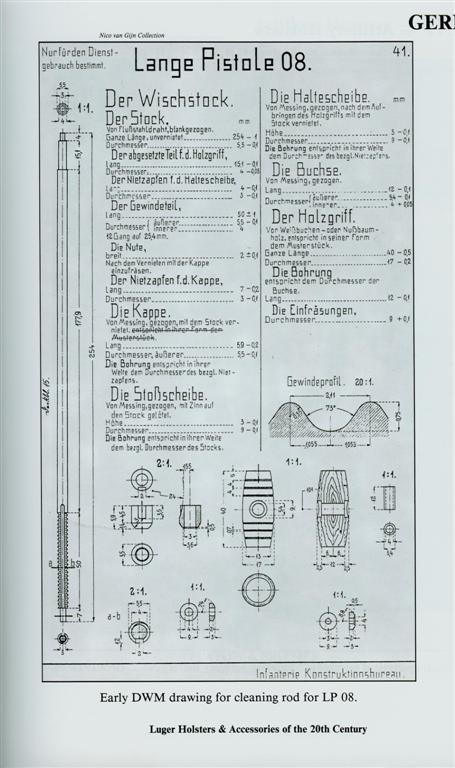

Thanks Pete,
Thanks for the picture. Just what I am looking for. Would it possible to get a picture of the handle where the rod connects to it. I would like to see how it was connected to the barrel.
A while back I drew up the cleaning rod in AutoCAD and did a rendering of it using the plans that I got from John S. I think I still have this somewhere and will post it when I get a chance.
Mike, I will take a look at the thread you mentioned. Thanks.

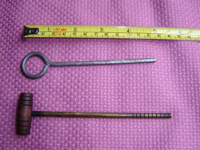

Hi,
This is a rod from the 'dunno' category. The top swivels, the rod itself is all metal, the barrel looks old, but has a smaller profile with only 2 bands each.
Either repro or locally made replacement
Unread 01-06-2007, 03:51 PM   #6
dz
Join Date: May 2004
Posts: 261
Thanked 56 Times in 40 Posts
Attached are 2 cleaning rods that came with 2 seperate M1943 Portuguese Luger Holsters. The aluminum one is incorrect and probably not even a Luger rod. The other I do not believe is Portueuese either, but it does look original for something, but what? Any ideas. David

David, I have an aluminum cleaning rod similar to the top one pictured that was in a cleaning kit that I got from my father. Would you be able to do a favor for me? I would like to see a few detailed pictures of the one at the bottom. This is the first time that I have seen one like it. I wonder how common or rare those are. Anyone out there have any idea? Does anyone have anything similar? Can you post photos if you do?
Thanks everyone, this is certainly interesting.

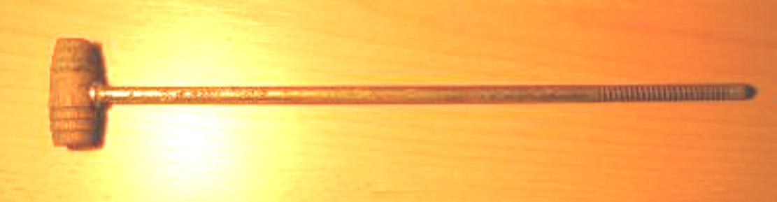

What do you all think of this offering?
eBay cleaning rod
~Steve
Unread 01-09-2007, 08:57 AM   #10
Photo's not clear enough to judge. Seller's feedback indicates that he sometimes sells reproductions.
