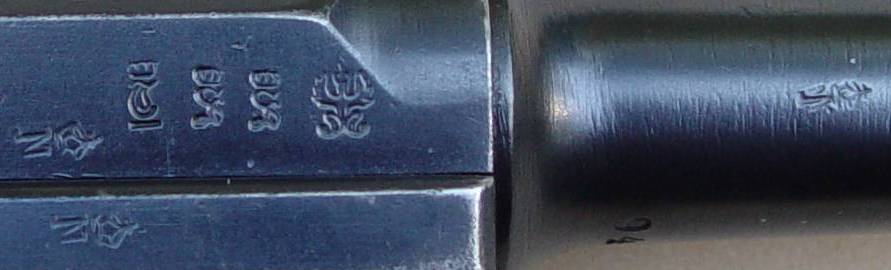

Bob...Right side lazy N's on receiver and frame and partially obliterated lazy N on barrel.

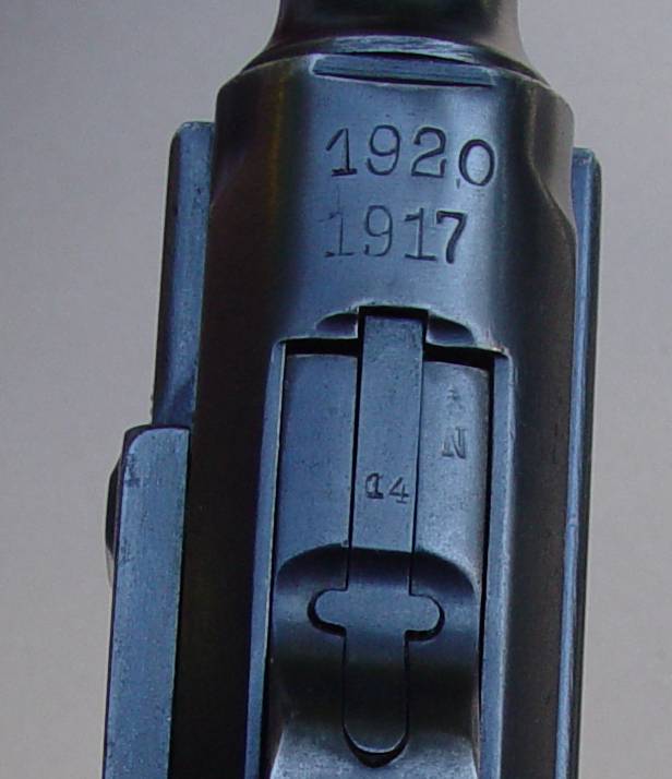

Posts: 90
Bob....Breechblock with partially obliterated crown N on right.
