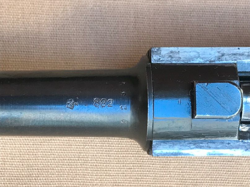

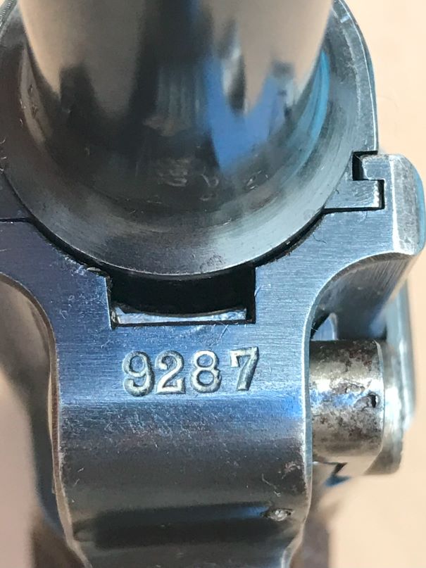

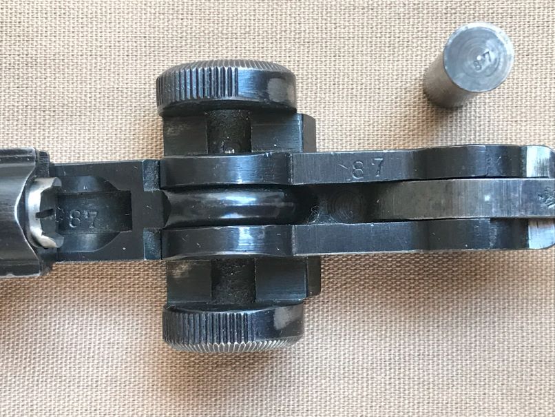

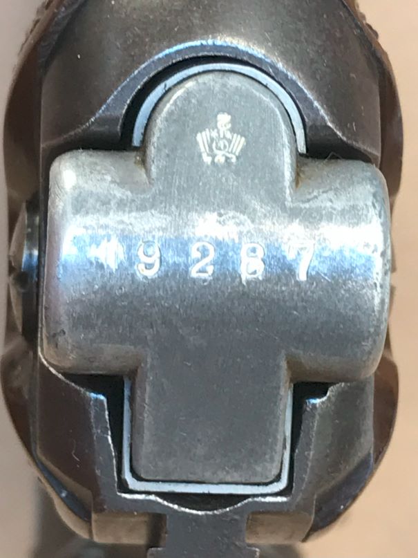

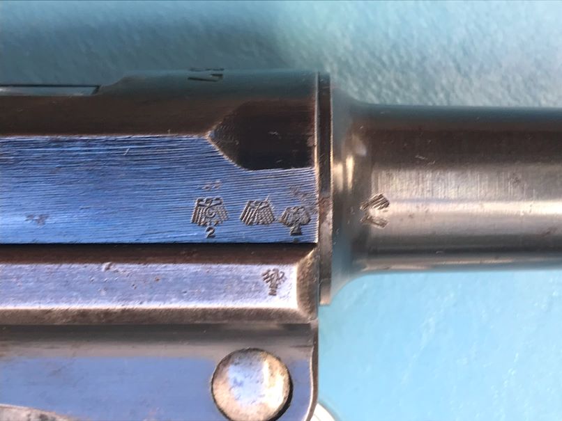

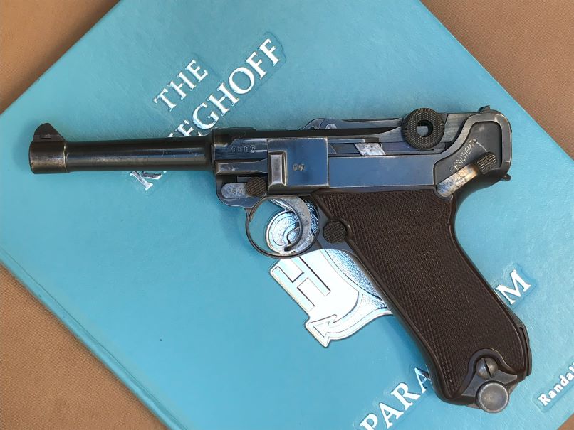

This particular Krieghoff 1937, s/n 9287 was mentioned on the forum some years ago. Recently, I responded that by coincidence, I purchased that same K-1937 on the same day as the forum post, 10/20/05. I wanted to get back with some pictures of s/n 9287 in a new thread. I kept the pictures to 15 with emphasis on major parts with stampings. Oddly, the take down lever not only has "87" stamped on exterior, but also on the inside flat of the part. Gun has a mint bore and came with a very nice 1937 WaA387 Genschow & Co Berlin holster.

Your mag E2 is not a real common one but it does have friends.
Nice gun
Inside and outside numbers is not normal but is not unique by any means.
Had enough of trying to load pics but mags 8398 and 8562 are same E2.
Long forgotten thread by me on the other site has many HK mag pics.
ADDIND is the hold- open numbered on the side?

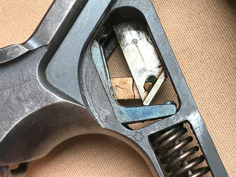

Default 1937 Krieghoff hold open serial photo.
Missed your question. Yes, last two digits of the serial number are stamped on the side of the hold open. Smallest numbers I have ever seen on a Luger.

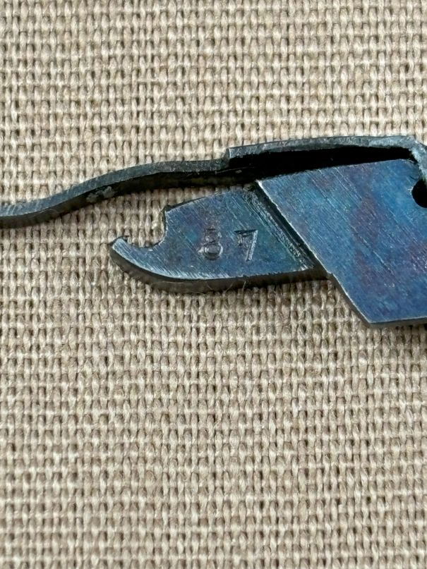

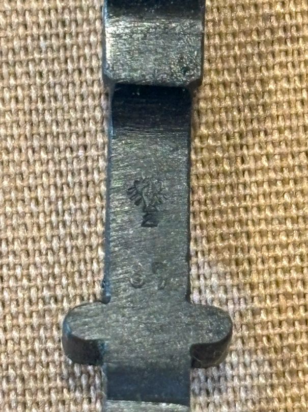

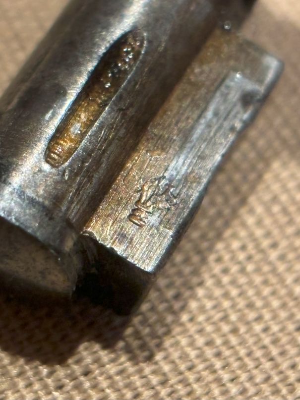

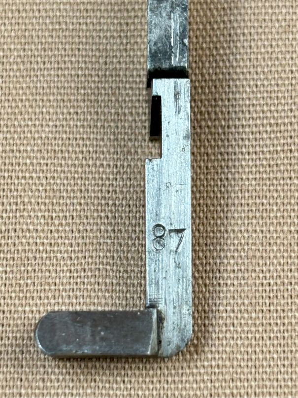

Default 1937 s/n 9287 small internal part stampings

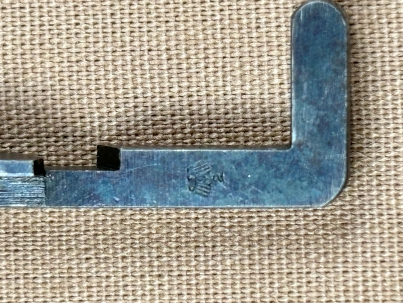

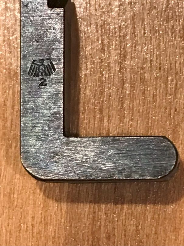

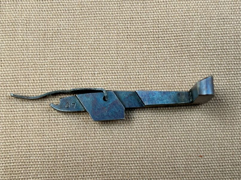

A few pictures of stampings on small internal parts. Safety lever, sear bar, extractor, locking bolt, and trigger.

Unread 02-02-2025, 03:12 PM   #9
1933fordnut
Join Date: Feb 2025
Location: United States
Posts: 2
Could not sign in so new deal.
The "87" on
outside of side plate
top of extractor
top of hold open
outside of takedown lever
are post production
open to speculation but not unique and probably period.
Side plate and extractor added numbers should be through the blue.
Sear should have E2 and "87" on inside.
Firing pin retainer should have "87" on rear flat.
Good looking 1937 and the extra outer added numbers are rare but not unique.
adding I see you posted the sear. Still need back of fp retainer
