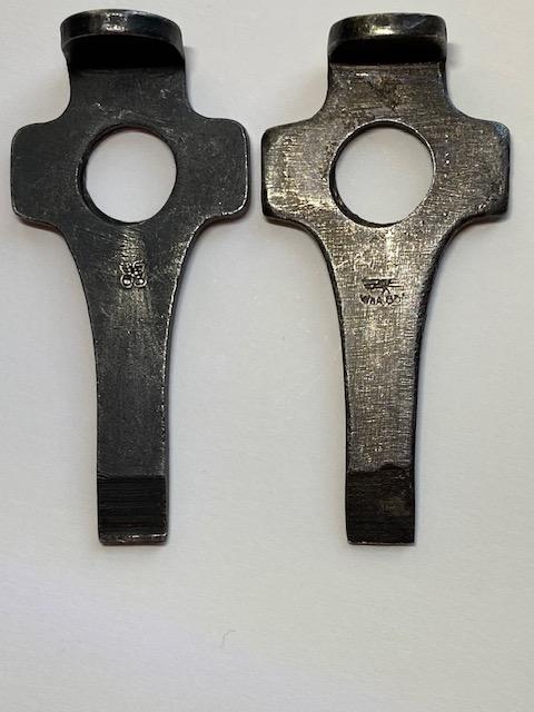

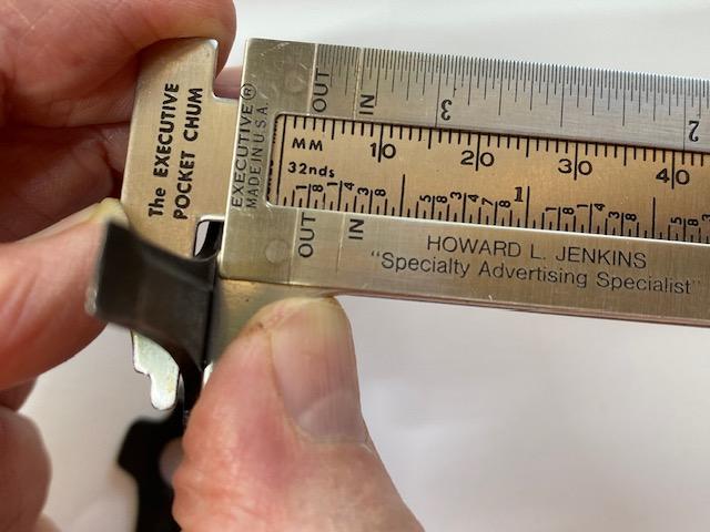

I just bought two loading tools for the two 1939, 42 Lugers that I recently purchased and posted here. The tools were both listed as originals and I had to believe the well known seller. I have also posted the caliber measurement of thickness next to each tool. From what I researched they conform to the thickness of originals (2.1 to 2.5MM) with reproductions thicker. Also do you think the WaA655 can go with the 1939 Luger? If you could review the pictures and render your opinion. Thanks much!

- I'm no expert but here is what I think I know.
- Most, but not all fakes tend to be closer to 3mm in thickness.
- I think your e/655 loading tool is probably more correct than e/135
- My understanding, which might be faulty, is that the e/655 was used on 1939 P.08's through at least 1941
- Both tools are Mauser, to the best of my knowledge.

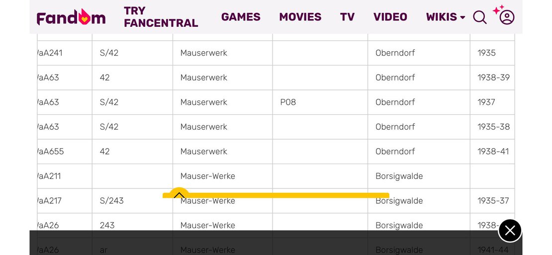

Thanks velodog455. I believe your assumptions are correct in researching the waffenamt codes. I've attached pictures. for the 63 and 655 WaA'a. I also found some information on your WaA140 but not sure it is of much help but will post pictures of what I found.
Both waffenamts were used in 1939.

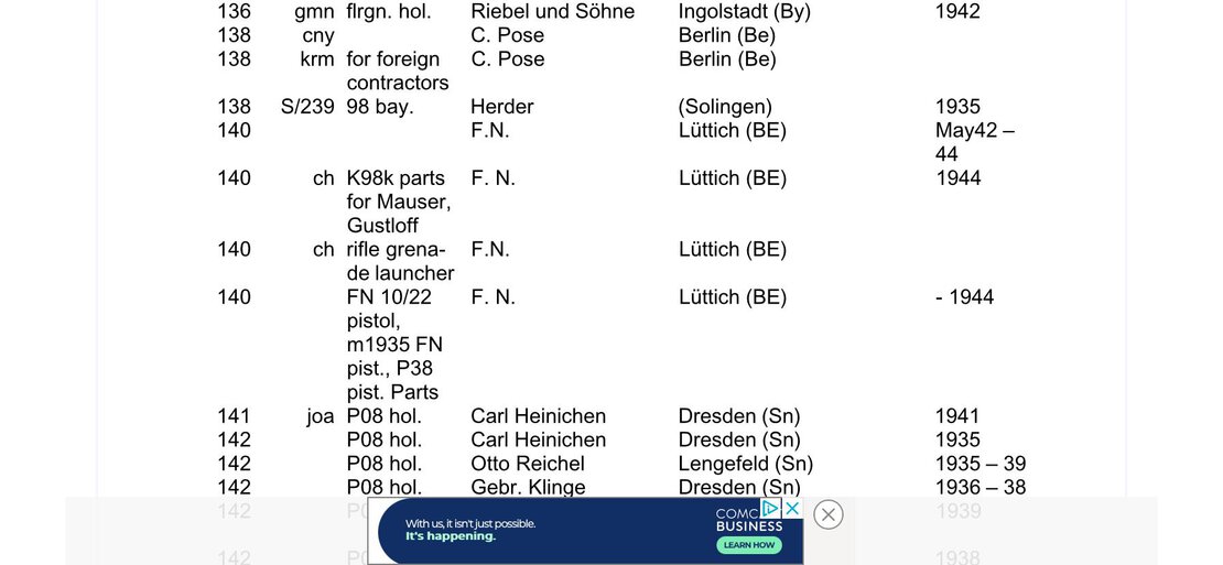

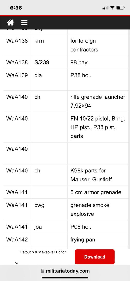

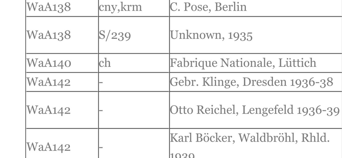

velodog455. Here are pictures of what I found on the internet for your waffenamt 140. The first two pictures are stand alone information. The last three are sections, so you have to put them together to get the whole picture. Holler if I can help anymore and thanks for your confirming information on mine. Pete

Looking at the Luger tools in the book "The Mauser Parabellum". I would say that your E/63 is original and correct for 1939. There are no WaA655 tools mentioned in the book. There are plenty of WaA63 tools pictured in the book.

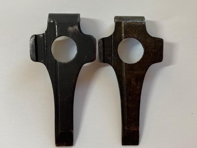

Here is my Eagle 655 tool from my BYF 41 rig. Just to add to the discussion/confusion?

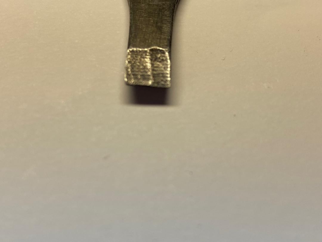

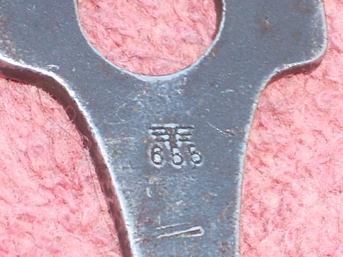

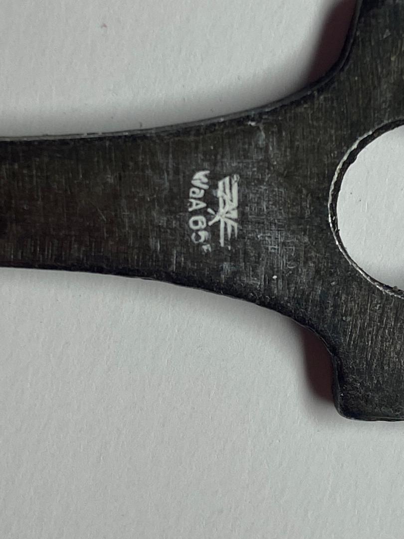

I received word that the WaA655 should be in a straight line. I have included much better pictures showing the 655 as a light strike with the second 5 barely legible. Also pictured is the grinding marks which appear rushed when done, not perfect.
The reproductions for sale are 3mm thick with perfect grind lines.
So I am hoping with the new pictures I can get a thumbs up or down on this tool's originality.

Sorry for the bad news but your 655 tool is a fake. It is missing the typical Mauser shape. There was only a WaA 63 accepted tool but not a WaA 655 tool.

Klaus, thank you for your input. This is the answer, clarification of originality, I was hoping for.
